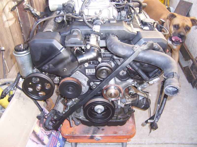

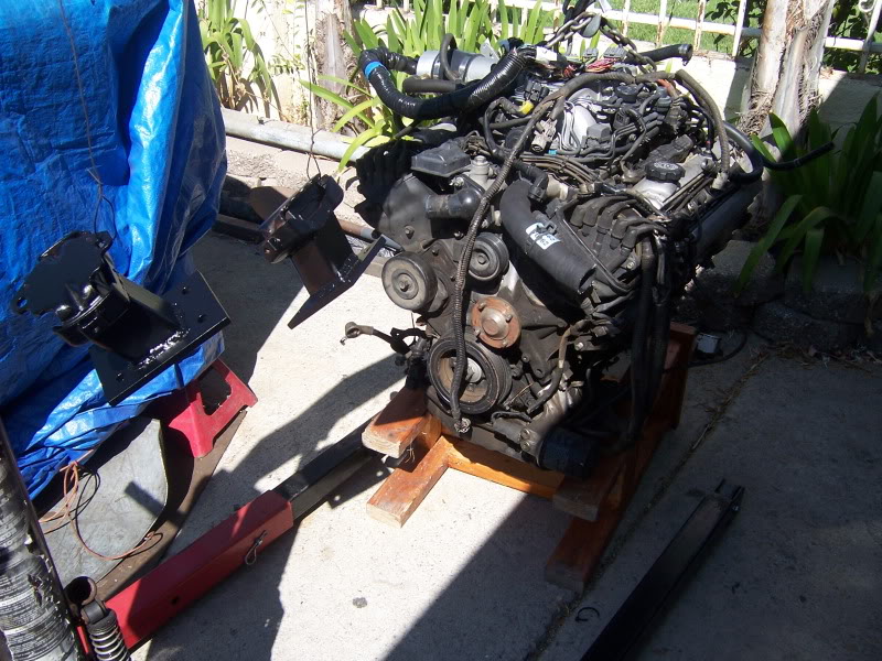

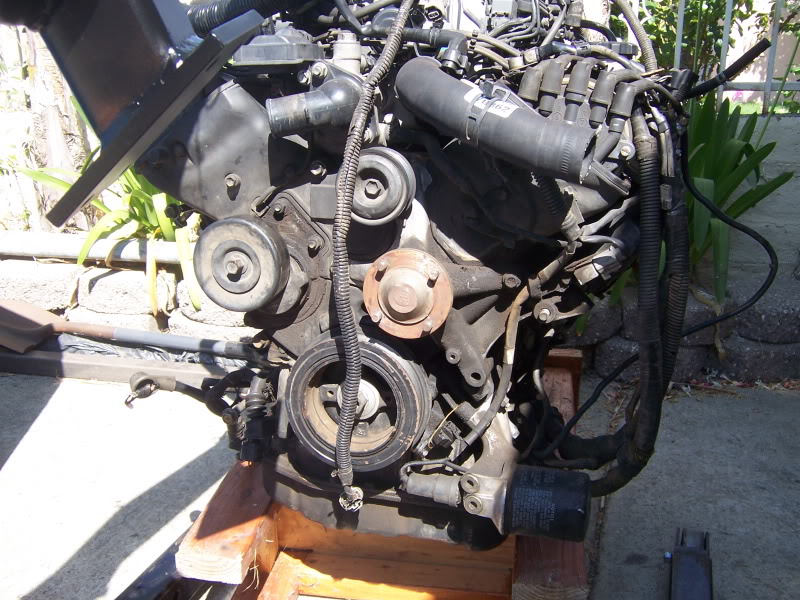

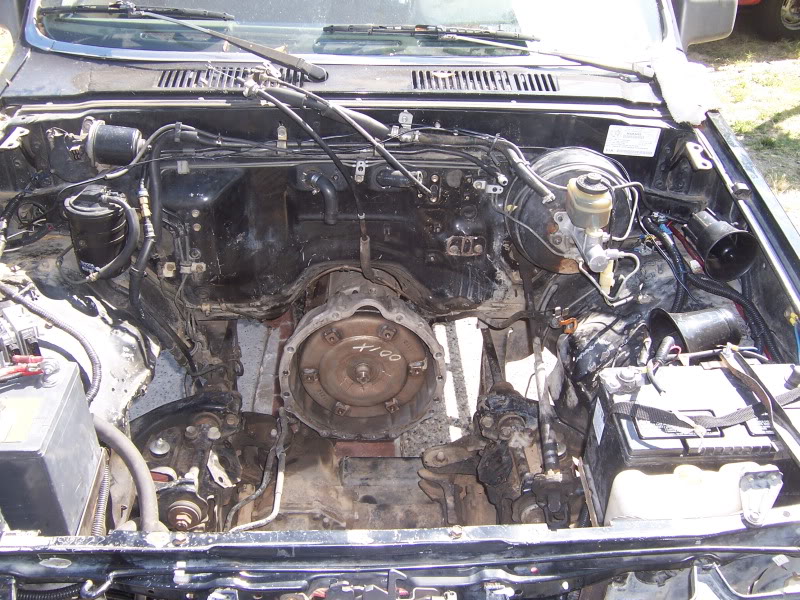

ok so i got the engine out yesturday afternoon .. wasnt to bad , the hardest part was getting the cats off to get to the bellhousing bolts.(Damn exhaust bolts)

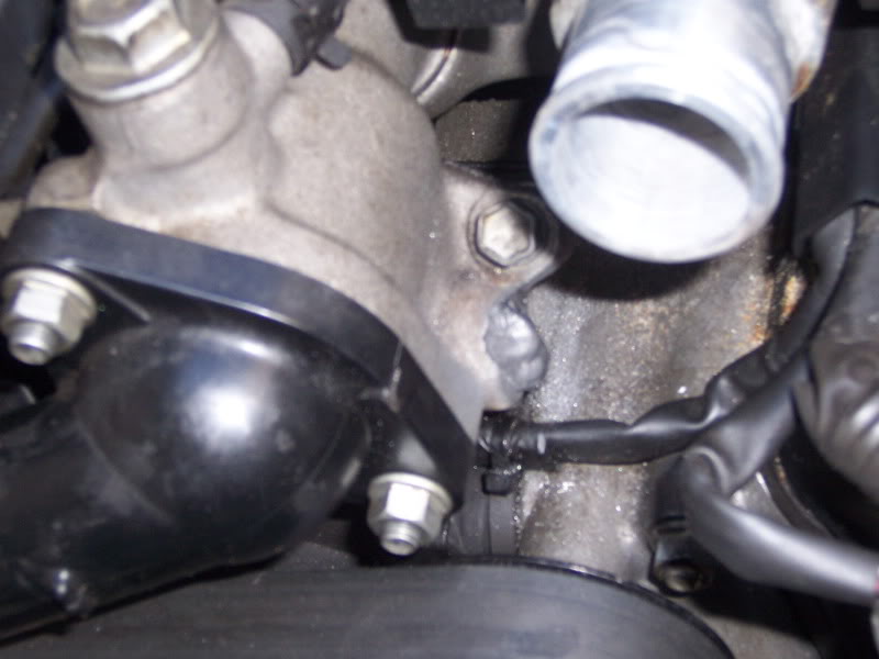

started to swap over some of the parts needed and welded shut the hole at the thermostat housing that was used to fill the lexus radiator.

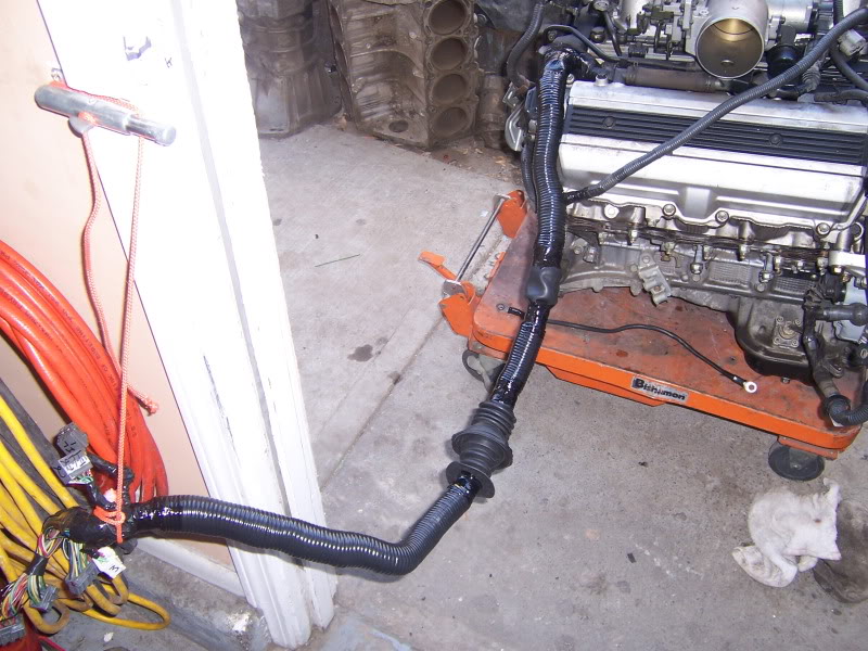

also finished wrapping the harness .. sheathing tape and liquid tape.
also painted the engine mounts i never painted before .
man what a diffrence between engines .

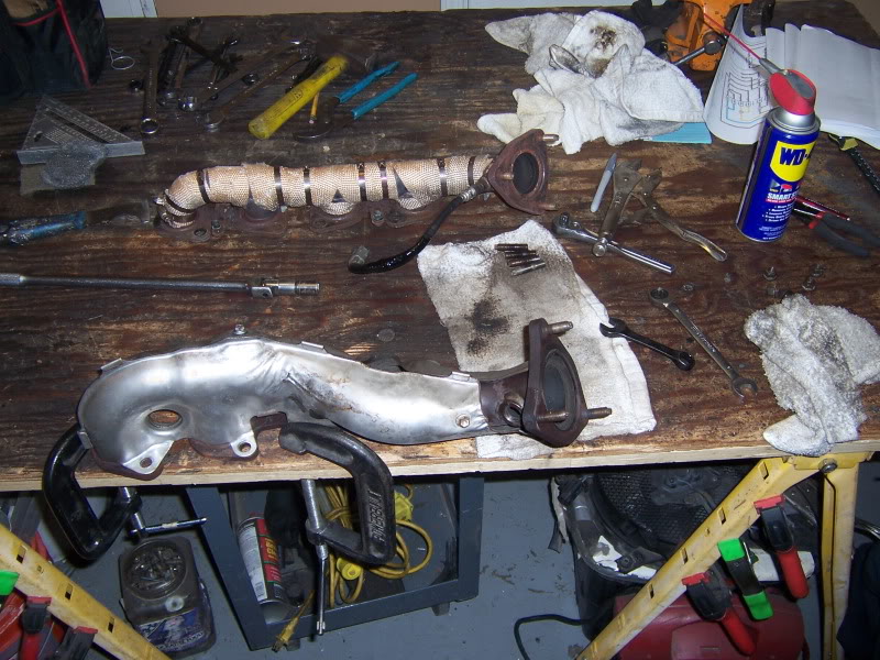

also need to remove and use some of the better exhaust studs.

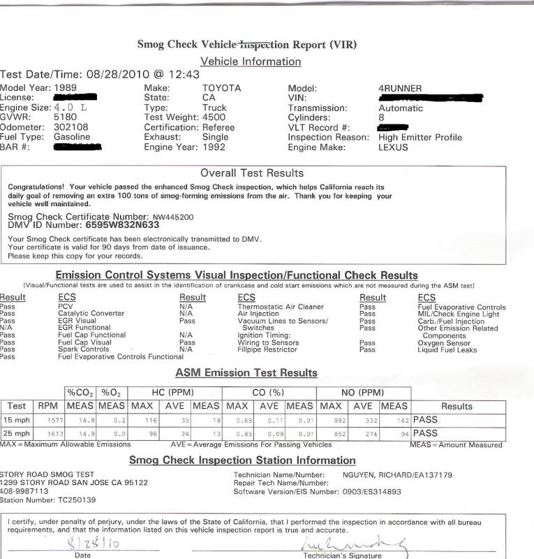

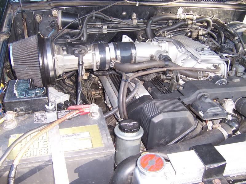

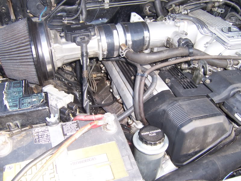

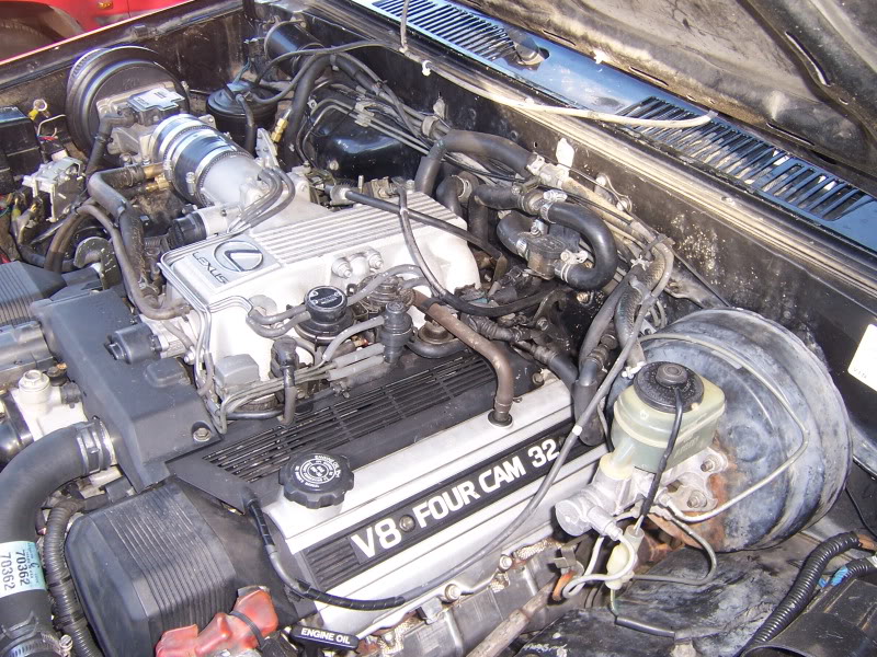

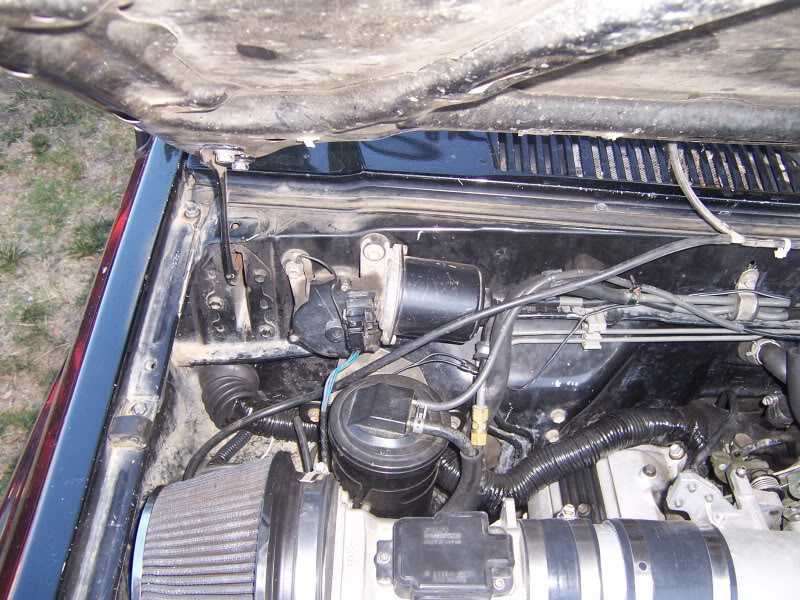

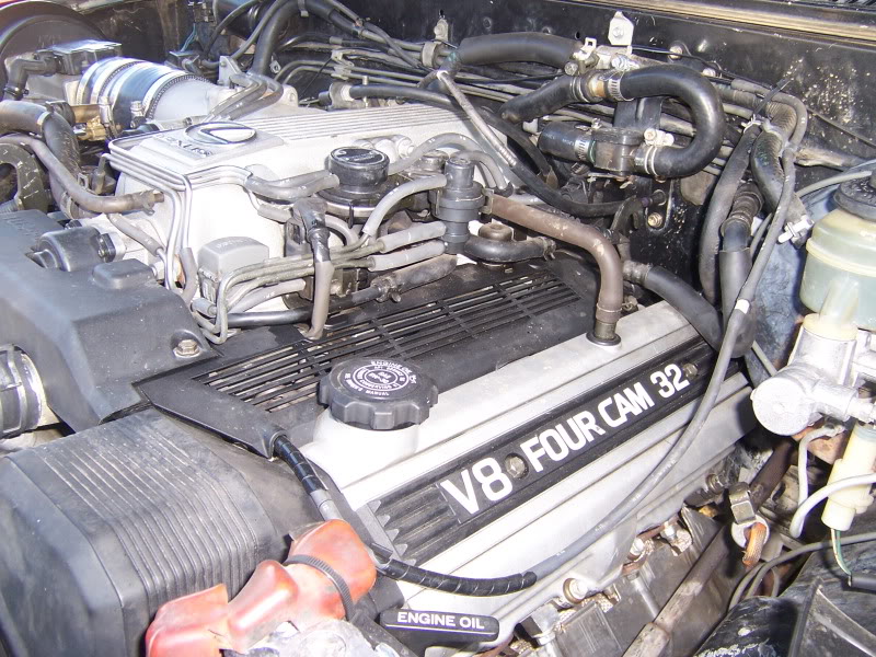

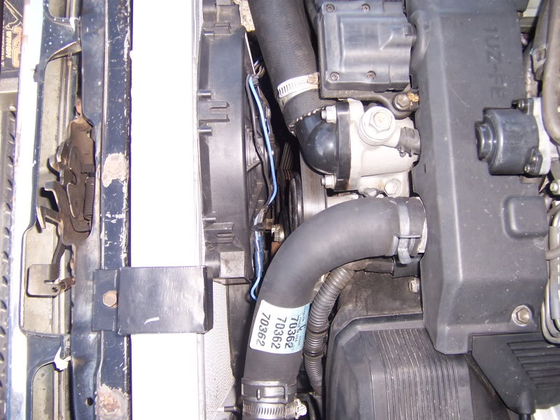

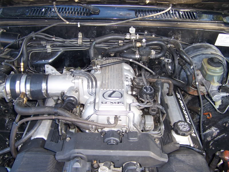

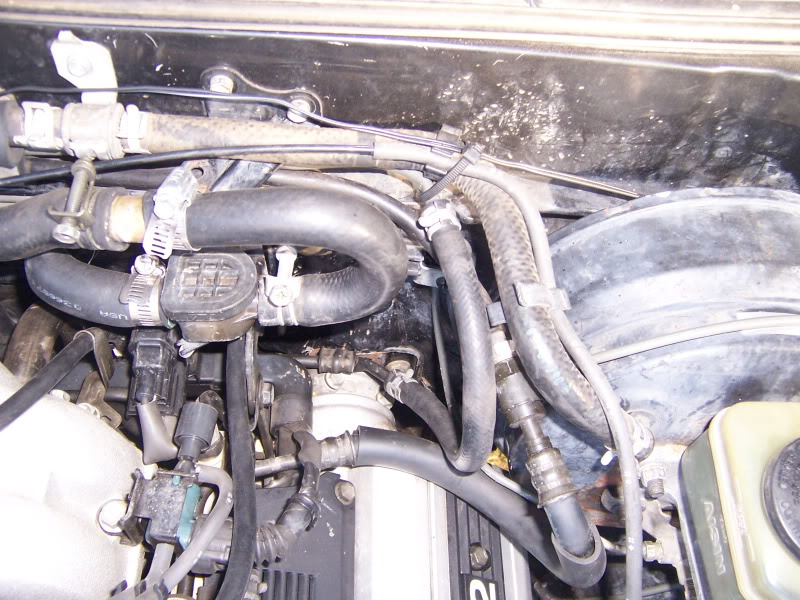

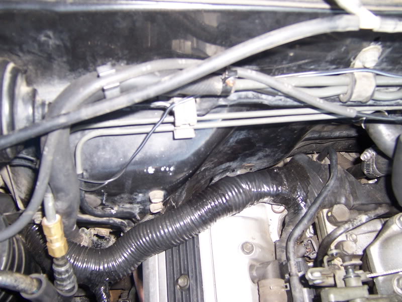

Passed first smog with the swap.
ok i got the idle fixed .. adjusted the tps again for the 3 time and that seemed to do the trick ..
then i took it to go get smogged .. it passed ..
and for anyone interested heres a scan .
