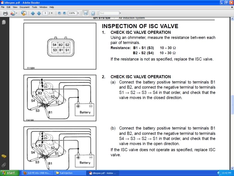

Hey RMA how's that truck running? Man I tell you what after an aggravating day or work there's nothing better then grabbing my truck keys and driving off in the old 1UZ Taco I tell ya.
Is your IACV still acting up? That stepper motor is a pain to wire up. You just have to keep trying your educated guess at the correct way to connect it. It will work perfectly when you find the right combo. I actually had an extra laying around and when I put the 2nd one on my engine it worked MUCH better and fixed all my problems. They do wear out.
shes doing fine , since the last tps adjustment shes fine .
those isc motors ... the 4 ground terminals need to receive ground in a certain order or they will not work. when i was testing them i couldnt get them to open or close at all .. i have 6 isc motors and i couldnt believe none of them worked .. so i had to pull out the manual and was surprised to find this out. after the manual i was able to get them to work all of them .
