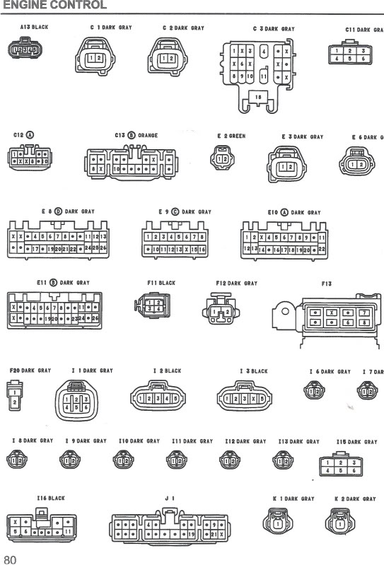

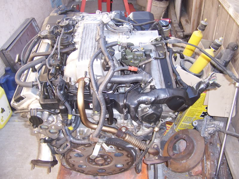

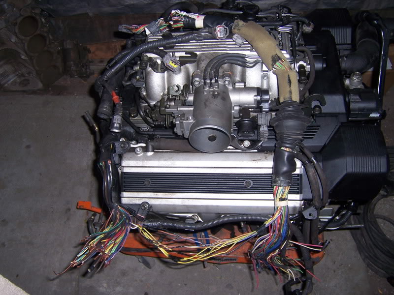

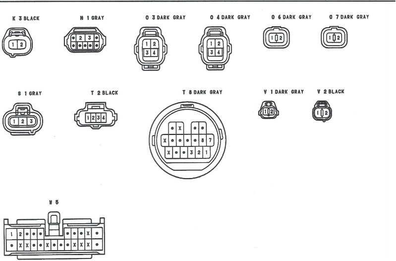

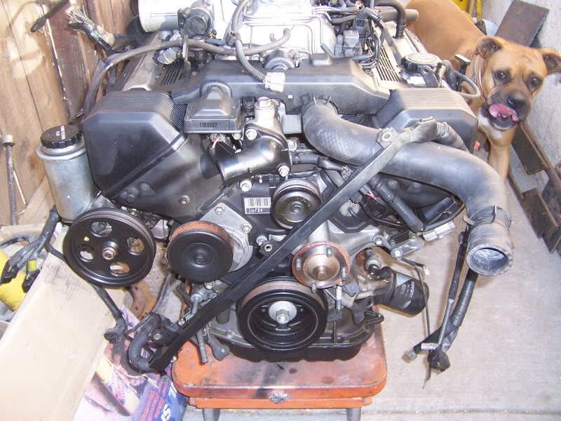

ok so a little change of plans .. i have a couple high mileage engines and was planning on just throwing one of those in the runner , but i found a really low mileage ls 400 engine for a good price .. 64,000 miles for $350 , actually the guy wanted $600 , i thought what the heck id try to go get it cheaper .. after a little negotiating he ended up keeping the A/C compressor and the alternator and i got the rest of the engine for $350. it was all good since im not running A/C and i just bought an alternator.
the car is a 1993 ls 400 that was totaled , hes parting it out.
he did cut the harness and i dont really want to open this low mileage engine up up to remove it , im just gonna install the missing harness which i picked up at picknpull for $15.00.
its really not as easy as it looks .. the same color wire is used a couple different times have to read thru the engine control diagram and make sure i have the correct one for the part ..
ive done 9 wires and had yellow and green used twice and the yellow and black used twice .. each one goes straight from the part to the computer .. only 63 more to go .
anyways .since i plan on supercharging this thing .. i feel alot better having this lower mileage engine in now ..

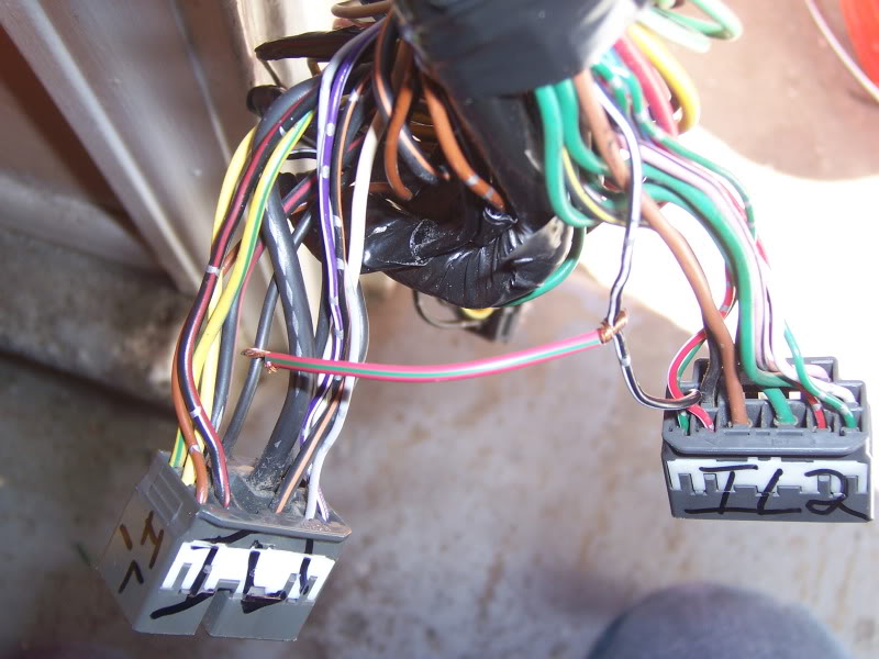

^ well the whole intake needs to come off and all the plastics and stuff on top .. i didnt want to deal with broken clips gaskets and stuff ..
i finished the wiring already and except for having to tone out the wires it wasnt to bad.
the engine is a 93 and the harness i got is from a 92 .. both had 72 wires and all but 2 wires matched as far as color goes ..
the knock sensors on the 92 were green shielded and the ones on the 93 were brown shielded . that was the only difference .

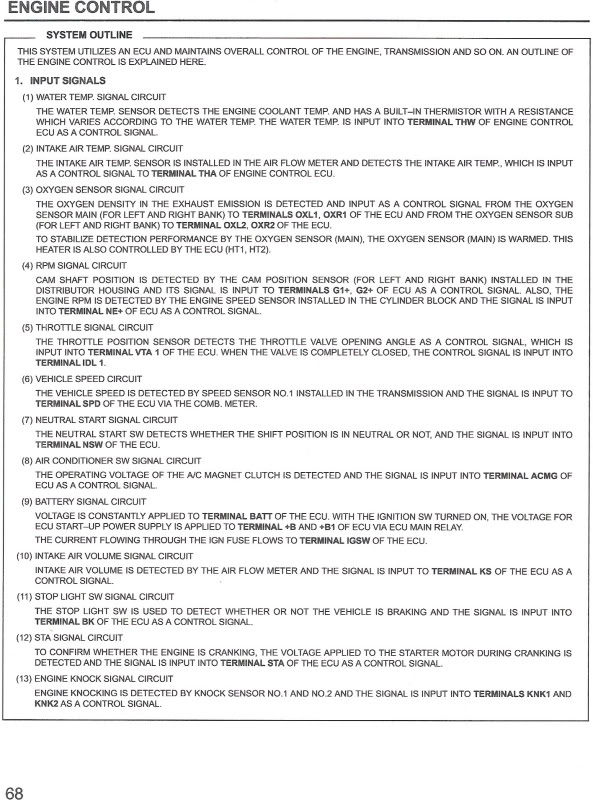

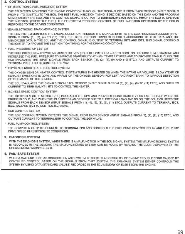

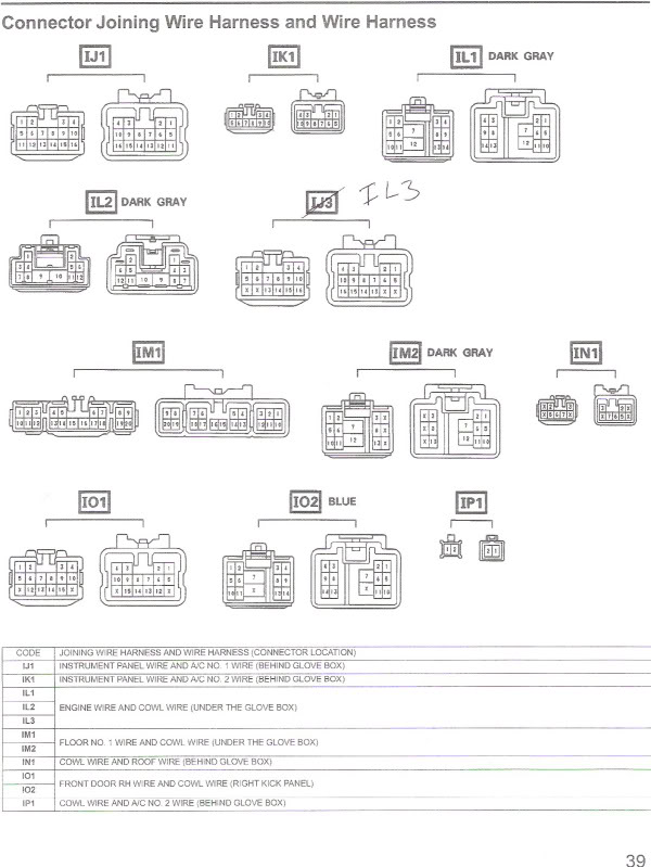

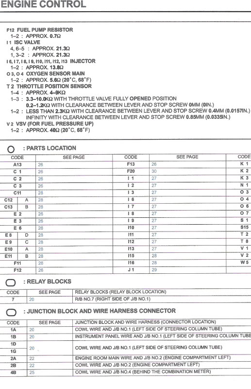

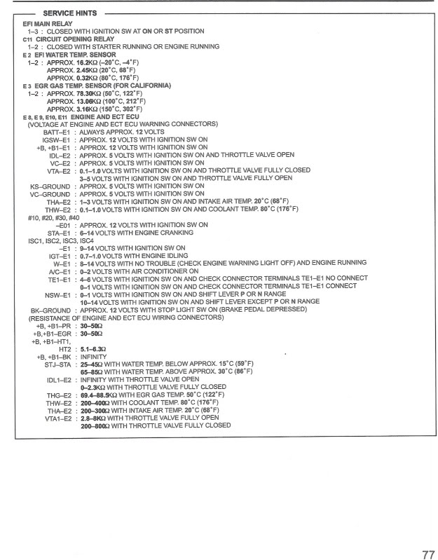

the engine harness should only need 2 wires changed for your manual swap.. thats to bypass the neutral park switch . The IL1 #8 should be spliced with IL2#6 on the engine side thats it for the engine harness .Everything else will be on the body side of E11,IL1,IL2,IL3

another thing .. ive seen some threads where the guys are using manual trannies and they have problems with the engine working right. something having to do with the speed sensor , and that because the ecu relies on signals from the auto ..but i really dont know much more than that about it.

your going to be like sideshow over on lextreme rma.. guys got hundreds of swaps under his belt full of good info too.
with mine i just ran the nssw to key on 12v, i used the factory engine plugs, then just spliced them in to the corresponding wire on the 3v pigtail i cut from my old harness, made things easy and simple all just plug in. it really helps to have a wiring diagram for each vehicle, compare double check, test, wire nut, test confirm, then solder heat shrink.
your go through the process and you should only need to do it once, i am sure rma like everyone else (me too) have had to make changes after reviewing our work this is the wire nut stage.. i got mine running and revving before i soldered anything..
Old Aug 18, 2010 | 08:26 PM
  #339
birdduck's Avatar
Joined: Sep 2009
Posts: 263
From: St George,Ut
o on the vss signal.. don't sweat thinking of a way to trick the ecu, no need to.
i removed every single wire to do with the auto trans.. no issues.. you may get a MIL but
nothing that will hinder the engines operation.
if you look over the diagram there is really only a few inputs to the ecu from the trans, i think they are the two speed sensors for the trans, input and output.. you can trace the wires for the vss and they don't even go into the ecu.
not quite like sideshow , that guys been doing it for a long time .. hes a pro man .. im just trying to learn what i can , i like this stuff.
and yea theres all kinds of way you can do it i guess.
supposedly what you did is possible with some ecus but not all .. some will not let the engine run right , again this is just what i think i read online , not seen it in person.
The Mil light is a big deal here in cali we need to have that thing go off .
so i read about a guy in southern califonia that did a 2uz swap with 5 speed into his 1st gen 4runner , he used resisitors to trick the ecu it had the trans solenoids .. or something like that , but it worked he passed ref.
