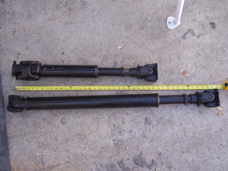

So I got my driveshafts back today had them retubed and the front one was legthened by 5 inches and the rear shortened by 5 inches .

This is the place that did it if your local and need someone .

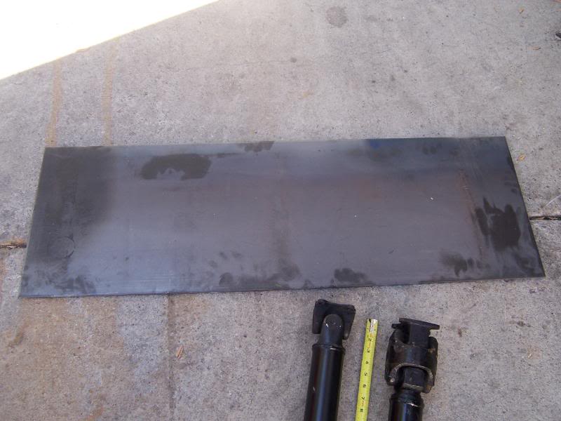

Also one of my neighbors that I never talk to , we just wave at each other when we see each other. Stopped by to see what I was doing with the truck and come to find out he works for a big steel supply company , he Gave me a sheet of plate steel 3/8th by 48 by 16 .. and reffered me to one of their customers so I could have it bent for my crossmember. So Im taking this in tomorrow. Thanks again Mike !!

Hey Dwayne , Thanks alot man , I will definetly post a video of it running when done actually ill post alot of videos when done .
I am trying to post as much info as possible to make it eaiser for others , they can take what they like and ignore what they dont.
I wish I could have posted more info on the wiring but I was really stressed and my brain was hurting with all those diagrams and stuff .Just couldnt do it.
Hopefully if I can get the steel bent by friday and then I can cut and drill what I need to to make the crossmember, if so I can drive this thing this weekend. If not it will have to wait a week , im going on vacation and wont be able to touch this thing all week.
