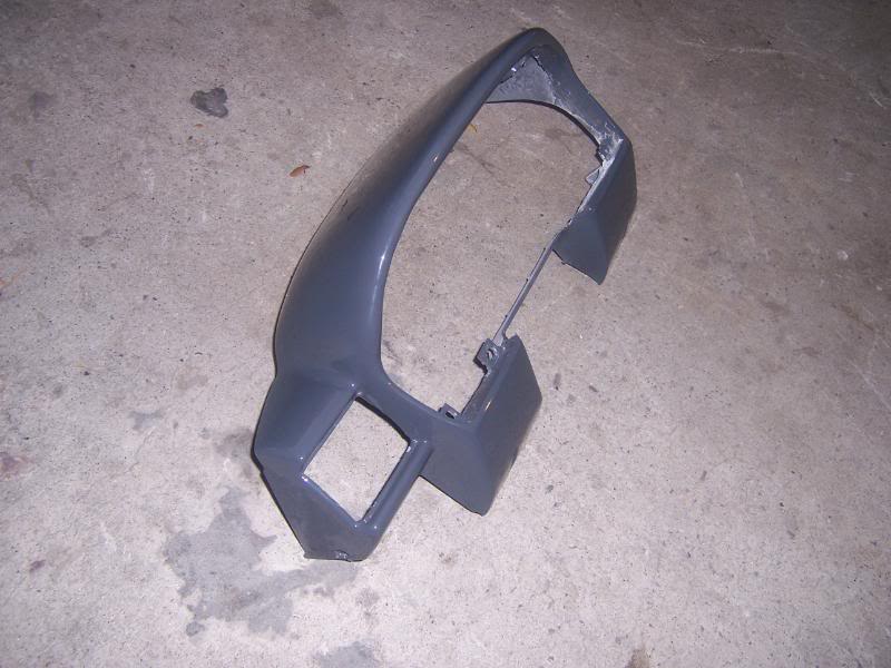

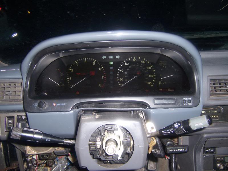

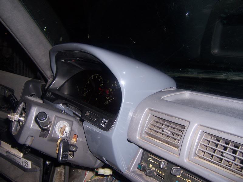

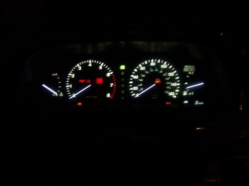

Ok I was able to finally get the rest of the dash from my friend . I think its ok it look fine to me , not perfect but its passable.
So after installing and connecting this thing I was able to see if the check engine light worked , well at first it didnt come on, but after a little trouble shooting it was only the bulb that was bad , thank god.
Here are the pics.

I still need to fine tune the fitment but overall its good.
I may also change the color, but later not now .

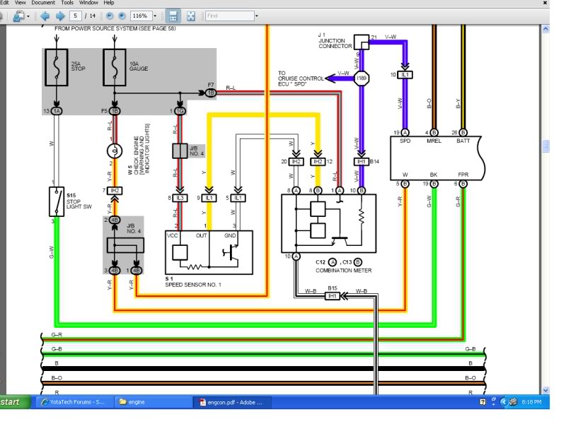

OK I forgot to post some info on the fuel pump .
This picture shows FPR from ECU being used to run the single speed pump .
WEll It didnt look right to me when doing the wiring so I ended up using FC from the ECU to run the 3.0 single speed pump,and so far so good.
