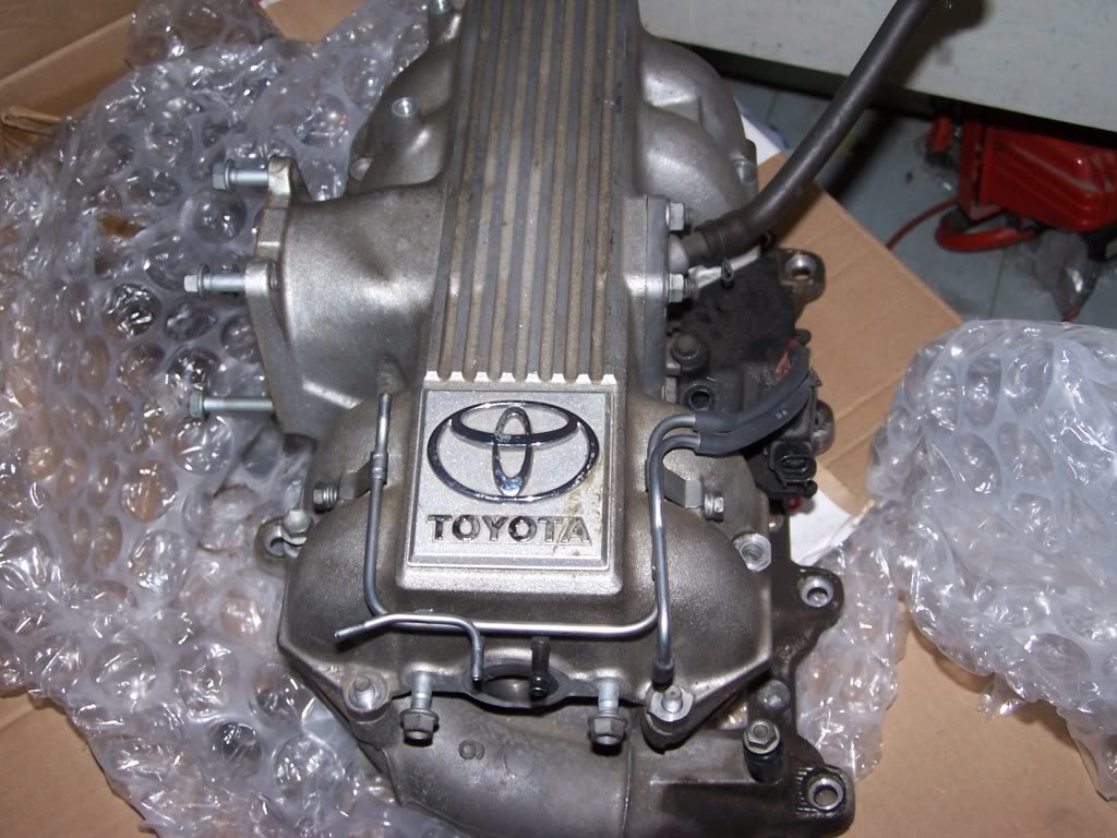

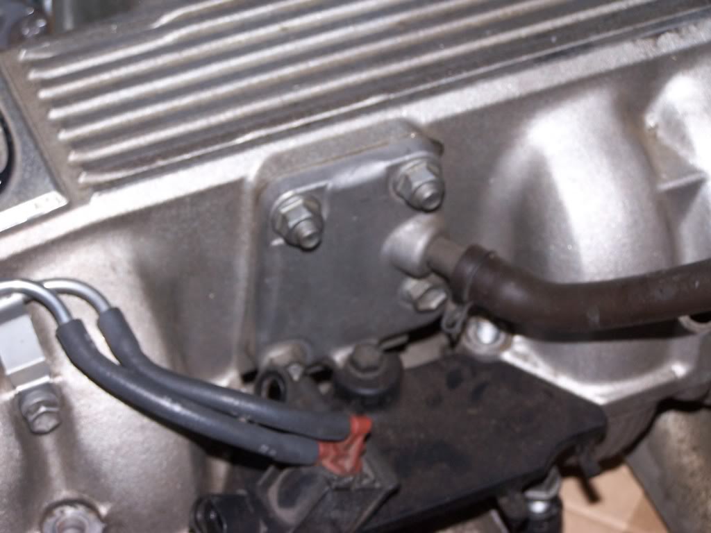

I could do that, but its kind of obvious the egr is gone. The one problem is thse erg tubes are all broken every one I can find at the junk yards , brand new from lexus its around $300 or a little less, then I still have to modifiy it because Im going into the tundra manifolds .
here is the Egr delete kit on lextreme.
http://www.lextreme.com/egr.html
