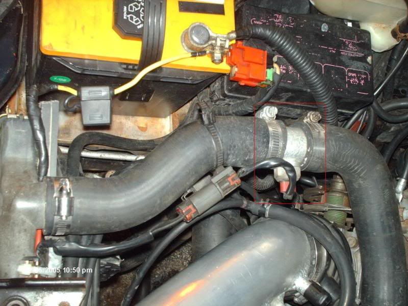

Thanks for that egr tube worked great , cut about a inch off and brazed it back together..
