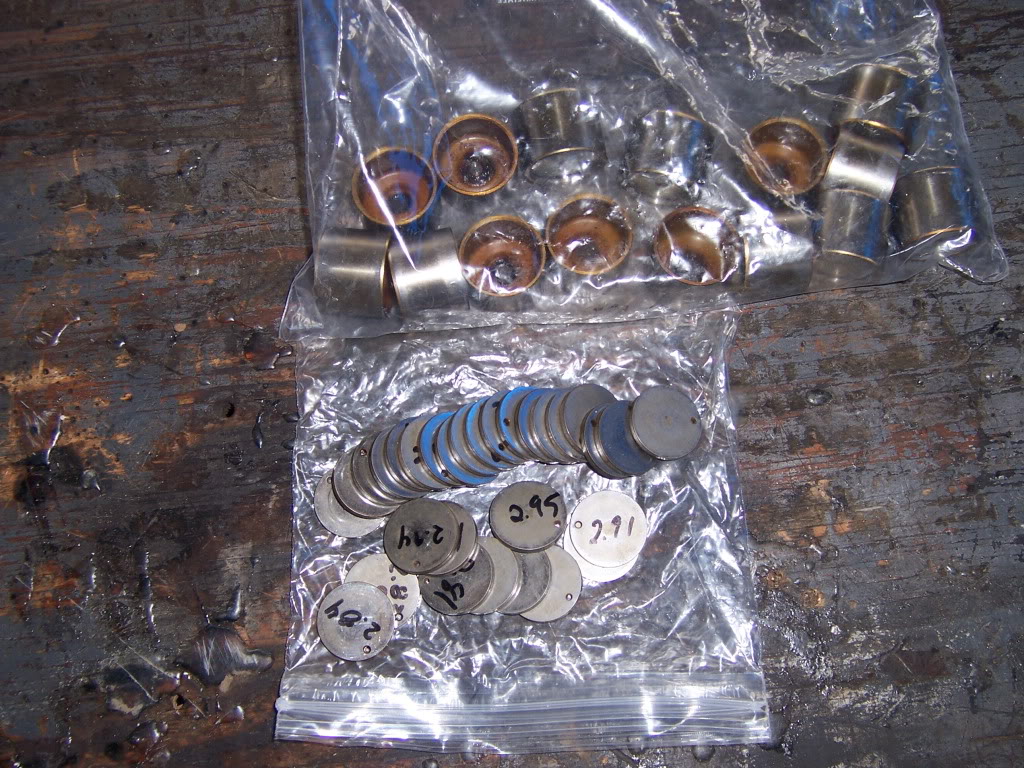

yea man ive been using just regular 87 from shell and thought I was getting good mileage .I am going to run a couple tanks of their premium and see how much better it is .

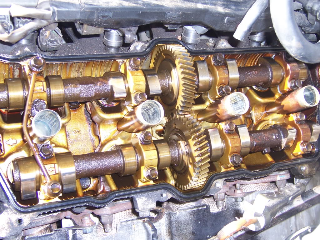

So I had been hearing a loud tick on the drivers side head , figured it was a valve out of adjustment .
Well I finally dove in and checked the valves , all of them on the passenger side were within spec and all but one were ok on the drivers side.
The one that is out of spec is an intake one and its the hardest one to get to , (closest to the firewall) theres no room on the cam to use the special tool . so i had to loosen the cam bolts a little to get to the shim.It measured .40 mm and the specs show 0.15 – 0.25.
T .......... Thickness of used shim
A .......... Measured valve clearance
N .......... Thickness of new shim
using the formula Intake
N = T + (A–0.20 mm (0.008 in.))
mine was
3.10 = 2.90 + (.40-.20)
So I have a bunch of extra shims and none of them would work , I had to order one . Part # 13753 – 50510 3.10 mm.

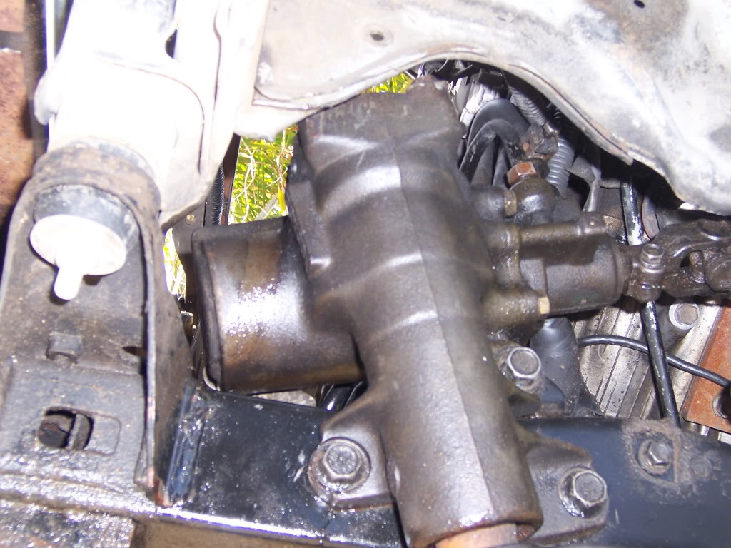

I also installed a new steering box (mine was leaking) and the power steering vaccum valve.
any way I used these 2 sites for help.

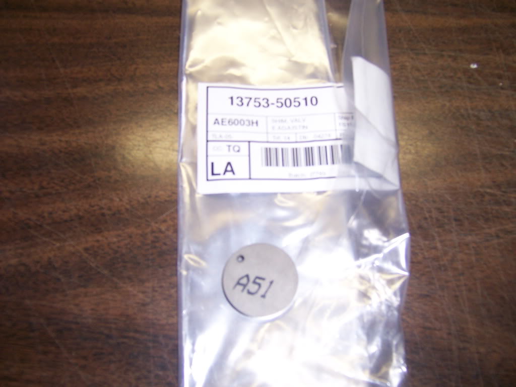

Finally got my shim in today , now time to go to work and close this thing up.its 3.10mm shim
shim part numbers
Table 5 1UZ-FE shim part numbers
Part number
Thickness (mm)
13753 - 50010......2.50
13753 - 50060.......2.60
13753 - 50130......2.70
13750 – 50180.......2.75
13750 – 50230.......2.80
13750 - 50280.......2.85
13753 – 50330.......2.90
13753 – 50380.......2.95
13753 – 50430........3.00
13753 - 50480.......3.05
13753 – 50510........3.10
13753 – 50560........3.20
13753 – 50610.......3.30
13573 – 50620.......2.525
13753 - 50630........2.55
13753 – 50640.......2.575
13753 – 50650.......2.625
13753 – 50660......2.65
13753 – 50670.......2.675
13753 – 50680.......2.725
13753 – 50690........2.775
13753 – 50700.......2.825
13753 – 50710.......2.875
13753 – 50720.......2.925
13753 – 50730.........2.975
13753 – 50740.........3.025
13753 – 50750........3.075
13753 – 50760.......3.125
13753 – 50770.......3.15
13753 – 50780.......3.175
13753 – 50790.......3.225
13753 – 50800......3.25
13753 - 50810.....3.275

Ok well I was using cheap electronic calipers and my measurment of the old shim was wrong. so the new one I installed was not the right one , (now measureing .12 ) so I went and bought some better calipers and now ordered another shim , should be in tomorrow . O well what can I do ...
