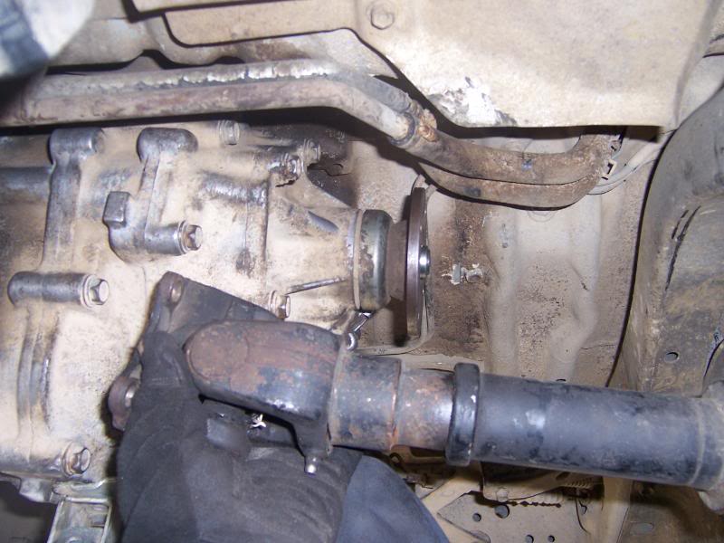

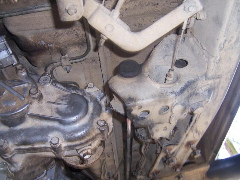

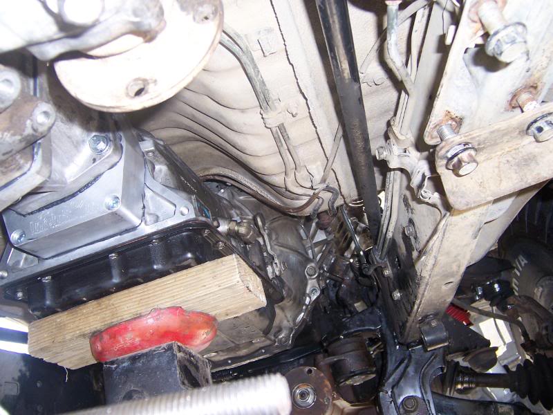

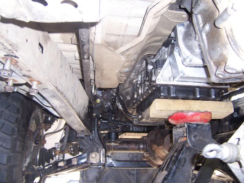

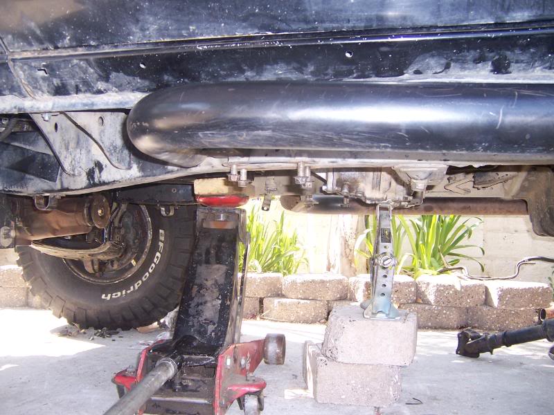

OK so I put the exhaust on the back burner for now and installed the transmission.

so now i need to extend the speed sensor wire, install the transmission cooler and finish installing the fans on the radiator and the controler for the fans .
I guess monday I will drop off the drive shaftes and have the front extended and the back shortened .
I dont know yet what I will do for a cross member I would just like to buy one and make it easy but I think If I do buy one I will just have to customize it , so I will go see about getting some 3/8 or 1/2 plate and do some work on it.

Thanks for that, but if you look at the second pic above you can see the torsion bar supports are in the way they line up right where the cross member would go .
I need to make something that will support from underneath using a reagular mount from the transfer case or one of those heavy duty ones.
