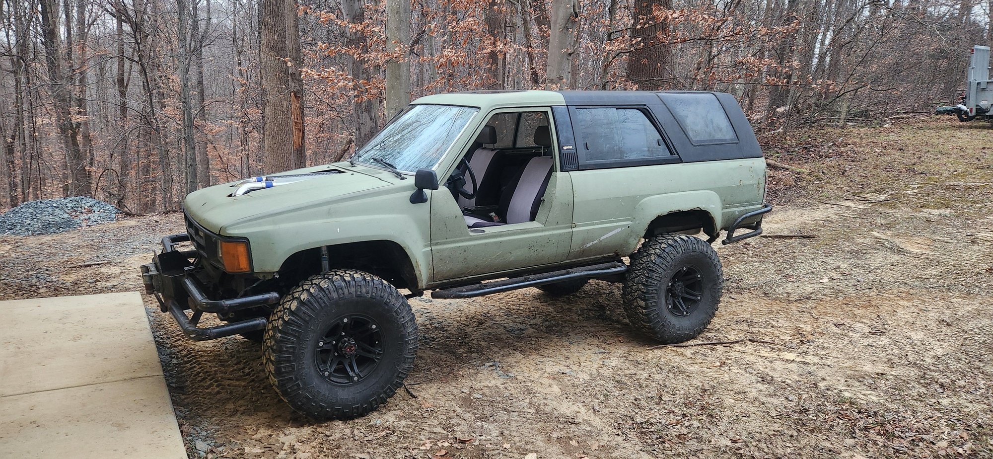

Nothing new, just wanted to show everyone it still exists lol. Little cold but took it out last night for a drive. Kind of at the point with it, of do i wanna tear back into it somewhat rebuilding it again or just selling it and moving on.

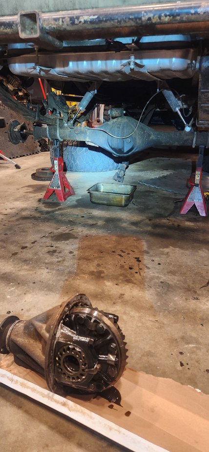

This might be #5, i really don't know at this point lol. Need to just finish my LC rear and get it under the runner.
