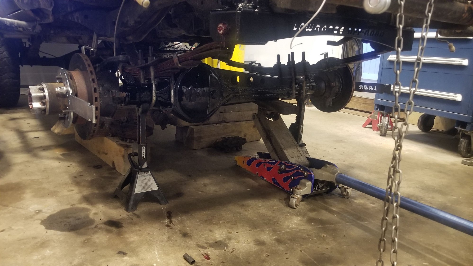

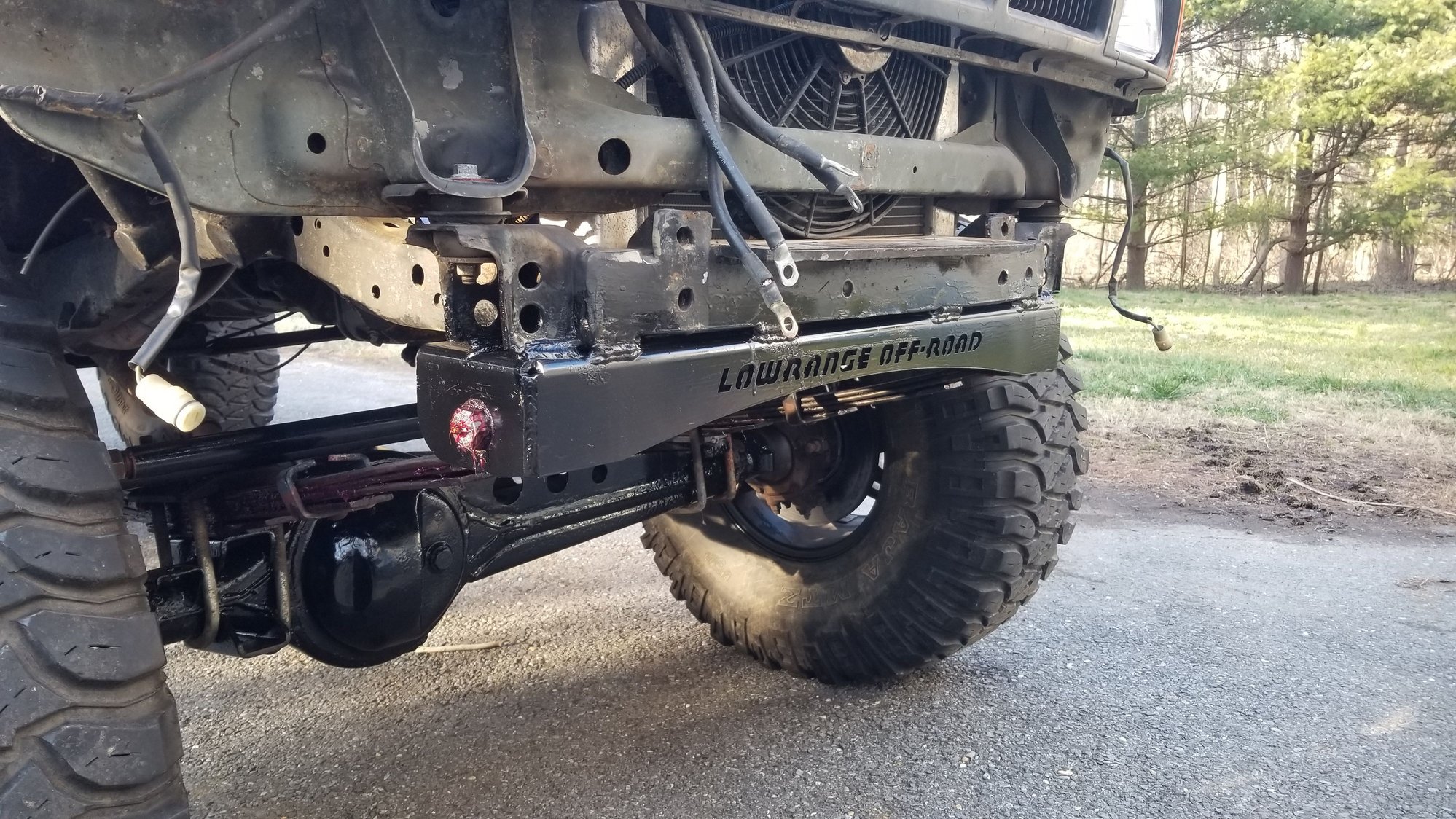

Used the plates from low range offroad to do a quick/rough alignment on the front end. Once everything is done front and rear it'll be going to alignment shop regardless.

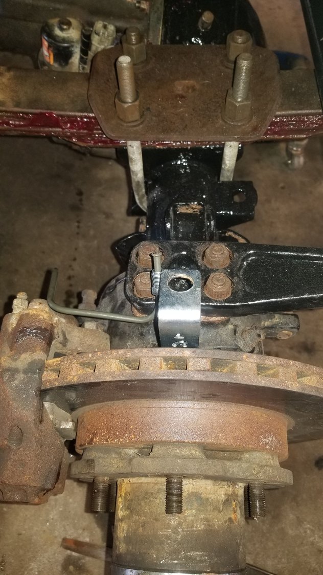

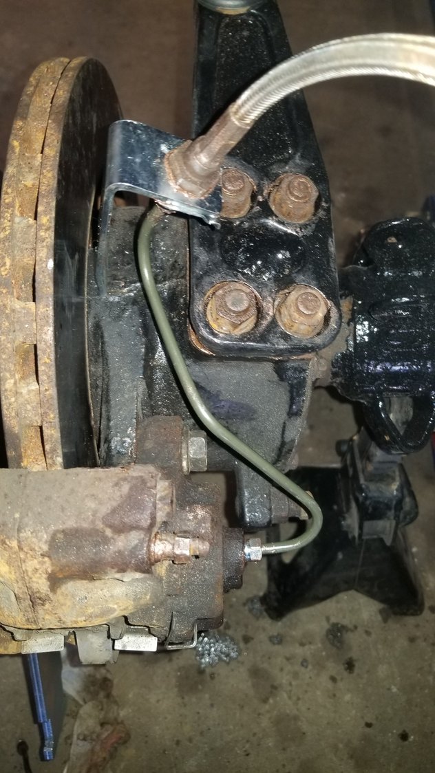

I recently discoverd these on lowrange as well. Backing plate eliminator with a spot to hold brake line. I orderd the new brake lines as well. However im guessing because im running the 2nd gen calipers they were not an exact fit and took some bending and pulling to work. But better the nothing which was what i uad been running for past couple years.
The brake line holder was pretty tight fitting the hoses into place. I did a light sanding on the hose ends and took a 5/8 drill bit and very lightly ran the bit through the bracket.

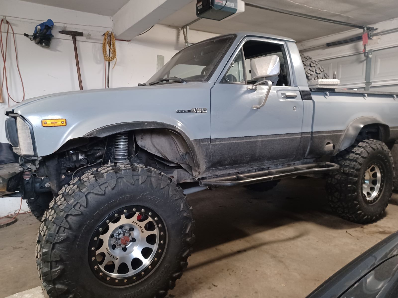

Rolled the Runner outside to get a look at it and immediately noticed something was off. The passenger side tire was sticking past the fender by 1 inch more then the driver and was like wtf is going on now lol.
Checked the bracket on squareness and determined it is absolutely perfect front to back on either side. Checked the left to right squareness which is 1/8" out total which im fine with. Earlier when fitting i measured it was slightly out but decided i wasn't cutting all my tacs just to scoot it to the pass side 1/16". So then i looked at the body......The flare on the fenders is different, Passenger side is aftermarket, driver side Toyota.

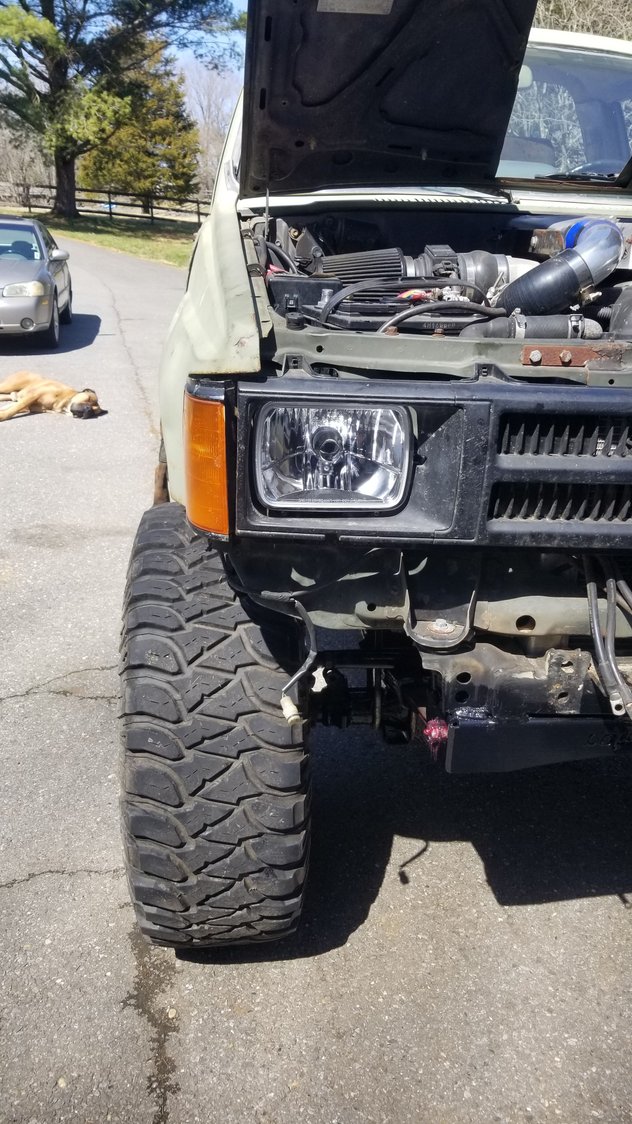

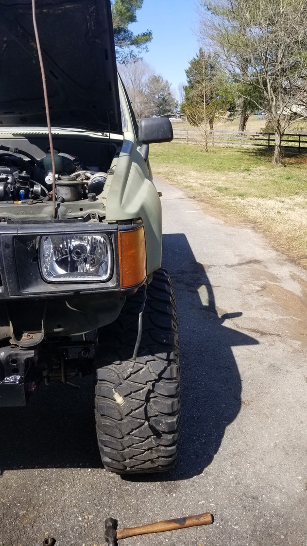

In pics above you'll notice the headlights. I put in Lowrange offroad headlights that accept a bright bulb to ditch the factory ones. I also put in brand new headlight bezel assembly's which are kind of hard to find in the states surprisingly.
so I the ones I used are brand new from overseas for a matching body style hilux surf.
The fitment was not perfect and extremely tight so it is hard to say if that is cause they are for a overseas surf or if it is the aftermarket headlight it'self. The bezzles came with stickers marking left and right. Which I had to switch sides from what the label said and they went in.

So in short, That was alot of work just to lower the front by about 3/4-1" total lol. The bumper does bring it down a smidge more but not that much. I did just drop in 4inch shackles this morning to lower it down some which it did by another 1/2". Looks much better in the garage but currently still dark out so ill roll it out in a few hours. However the only thing im no too crazy about is my shackle angle now with the 4inch. Just sitting they are at 36° and pretty close to my body mount.
I'll probly knotch the body mount just slightly, but currently uncertain if I'll leave these shackles or not

im wondering if you have a 2wd fender on your truck. 4wd had bigger flare. Toyota did this on the 2wd and 4wd trucks until the tacoma came out.

Originally Posted by RBX
Looking good!
. Good call, That completely slipped my mind. I bought that one off ebay from junkyard years and years ago. They probly assumed it was the same as did I apparently lol

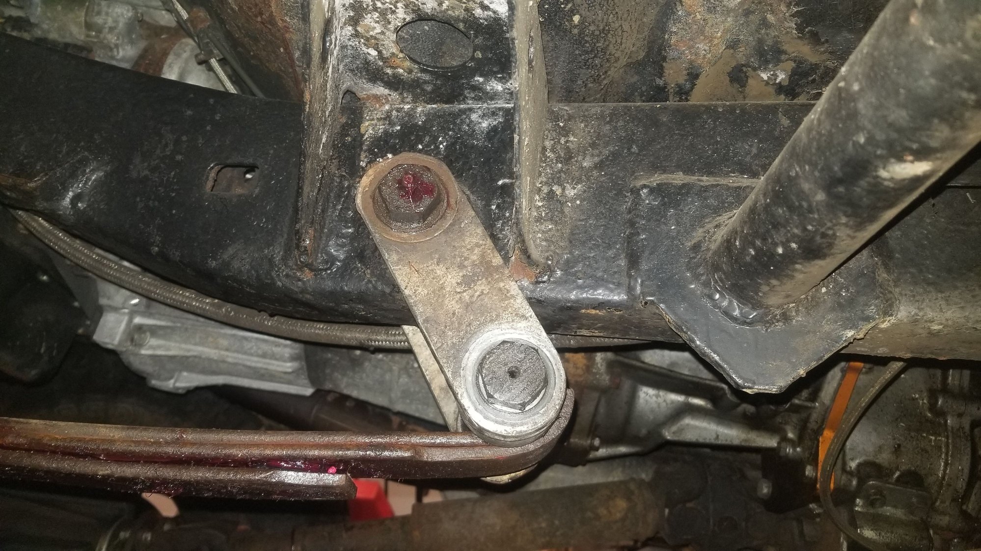

I pulled one of my leaf Springs out to compare it to the 3" Springs that I picked up. I was happy to measure that there is 1" difference between the 2 also noticed that the center pin was more forward on the 3" than it was on the 5" so I proceeded to put new bushings Spring pads and Greece all the leafs on the 3" spring pack. The other one I just throw under quickly without touching it. With that keep in mind that my 5" Springs had the 1st and 3rd leaf removed out of the pack. When I put the 3" Springs under their the spring measurements are slightly different and the shackle angle is almost completely vertical now which of course then raised the truck a few inches. So instead of cutting both rear Spring mounts I'll just keep my 5" Springs and put 4" shackles on them to lower it what little I can.

For years the Runner has sat slightly lower to the passenger side and the only thing I can come up with as for the reason is the rear Spring mount on driver side is 1/8 inch more forward than on the passenger side.
So i'm thinking that 1/8 inch changes the shackle angle just enough to lower the truck to lean on one side over the other. So with that I will try the 4" shackles and then that will dictate if I want to move one Spring mount forward or bring the other one to match backwards. Regardless I'm not cutting both mounts off the frame lol

I put the 5inch springs back under with the 4inch shackles I had laying around. Frame to concrete passenger side 24 1/2"
Driver side 24 heavy 3/4", it's not much but it is very noticeable which is why it has always bugged me over the years. When I was driving it somedays I would have 1inch difference between tire to fender. Seeing how I just reside the front and tore the back out I'm assuming it would get to that point again once everything settled back down. I'll tackle this again later and decide what I'll do. Currently raining here in MD so can't roll the Runner out for comparison pic on the shackles.

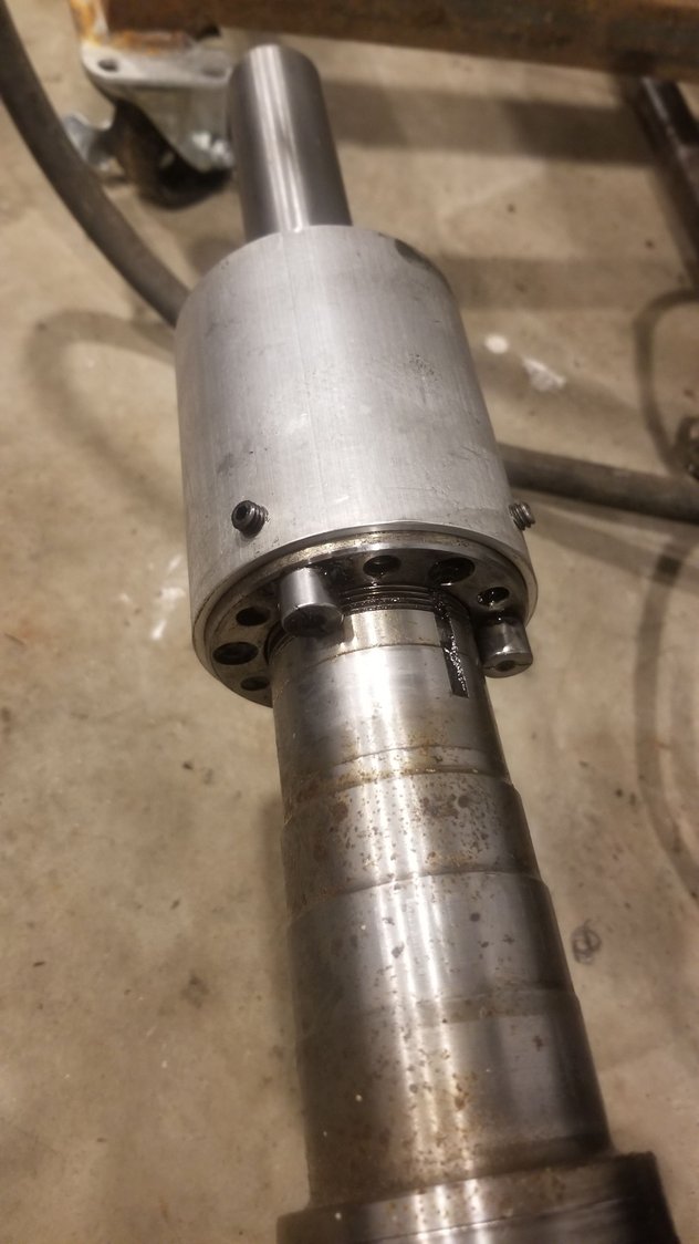

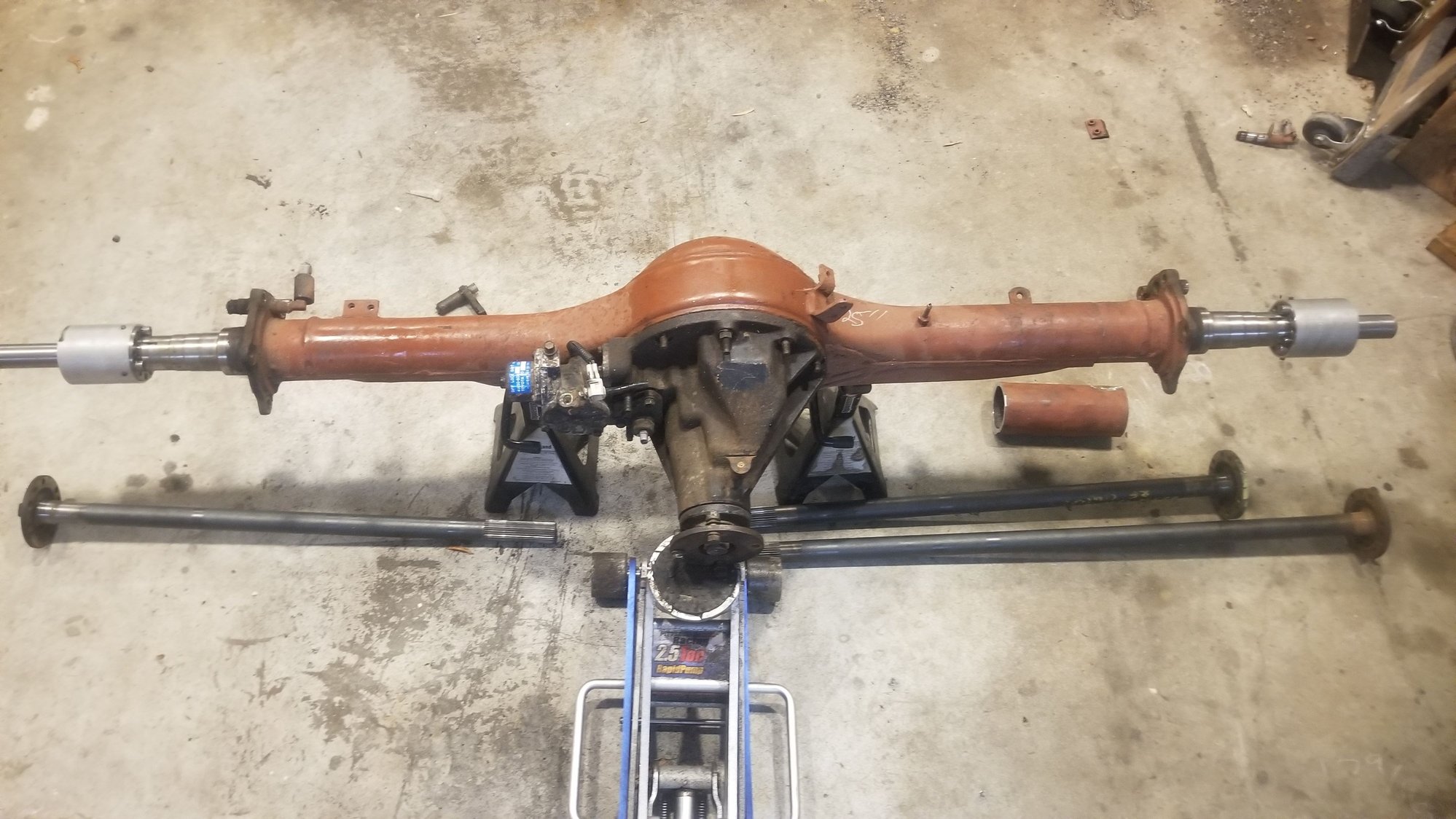

So i did finally decide to cut on the fj80 rear housing to narrow it down. It was a very spur of the moment out of boredom so i did not really do any prep as far as measurements for before and after which is in a way irrelevant untill the hubs and rotors are back on to give a final finished width after fitment and welding it.
Old Jun 1, 2022 | 03:56 PM
  #293
8784 runner's Avatar
Community Builder
Joined: May 2010
Posts: 415
Likes: 6
From: Anne Arundel,MD

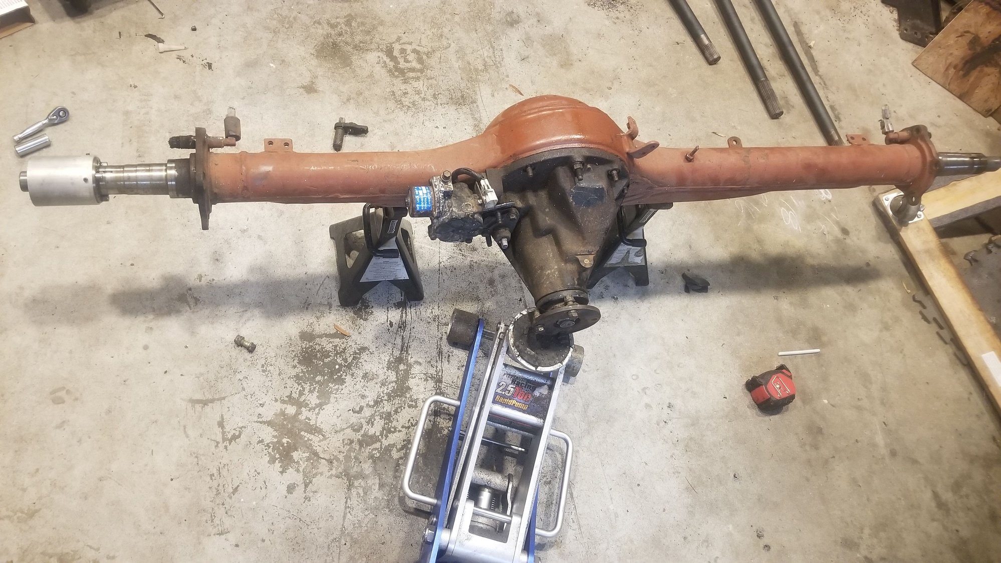

Not welded, just the jig holding it together. The 25" you see on the housing was just a reference measurement to a sharpie mark i put on the housing for a before and after measurement. With the housing and cut piece nut to butt it came to 7 3/8" narrower
Pre cut. To figure how much i wanted to cut out was simple. I took the factory long side shaft i pulled out and measured it to the factory short shaft i bought off ebay while back. The exact difference was 7 9/16". I did not want to try and cut that exact amount for fear i would over shoot and potentially cut to much which in the end would suck the shaft further into the diff. So i measured 7 1/2" and made my cut. Final length removed from axle was 7 3/8" which im fine with.

The shafts have a decent amount of available splines that pulling it out further from the R&P splines by roughly 1/8" i don't see that having any major consequence. Plus currently i did not finish and it is not welded so "Final" width is still subject to minor change. Typing this up now while still fresh from last weekend.
Axle housing: 3.125" O.D .250 wall 2.625" I.D

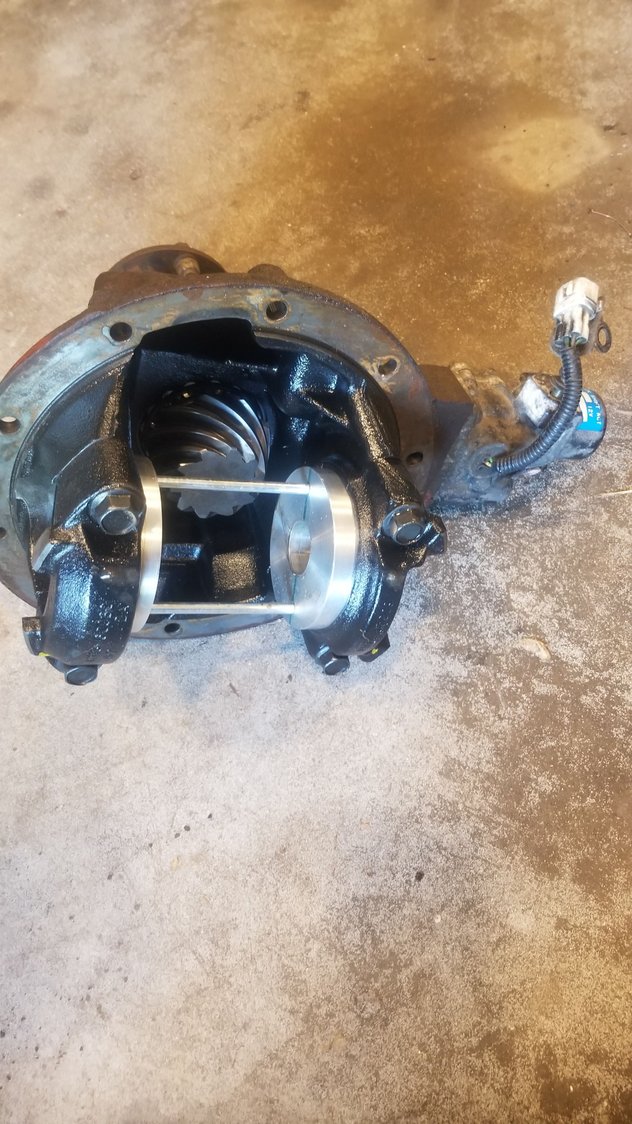

The jig is some machined aluminum. Pretty self evident, no need to explain.
