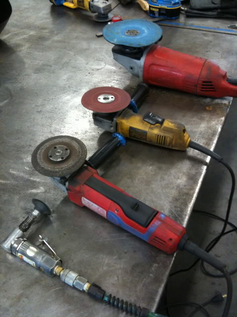

The arsenal...

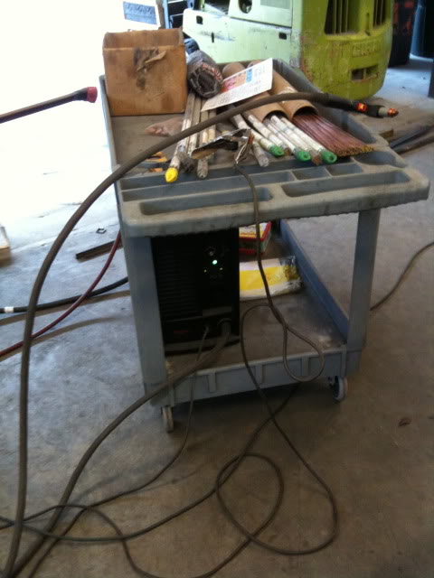

3 Phase PLASMA!!!!

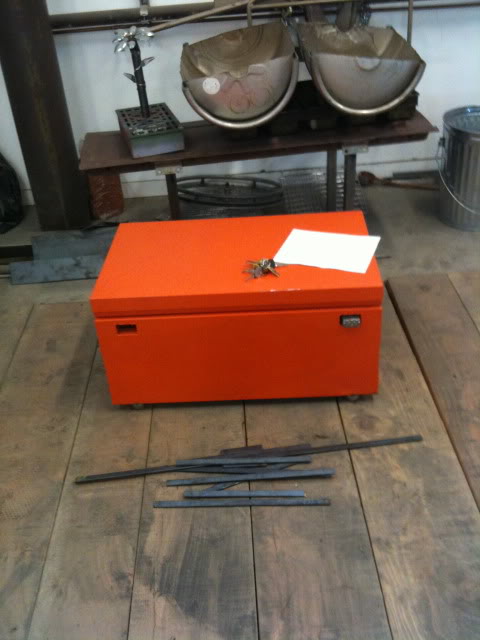

this was my first project for the flatbed. My Home Depot lock box needed new legs.

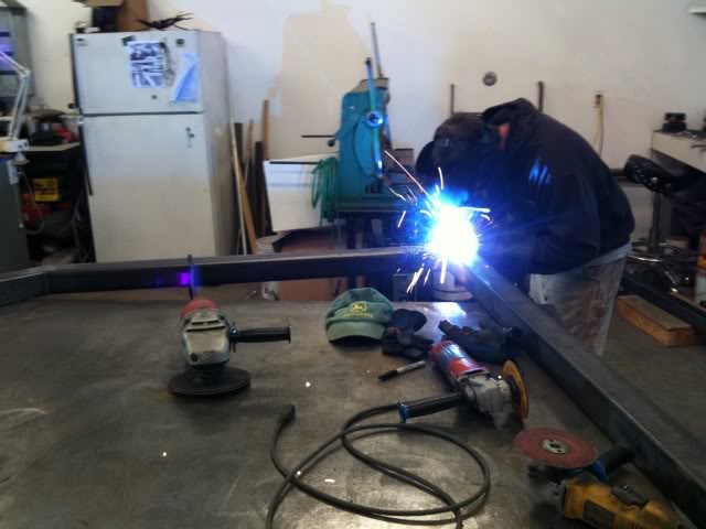

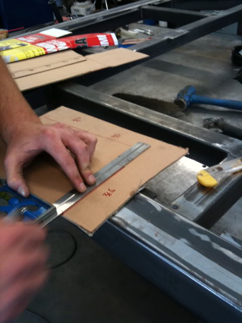

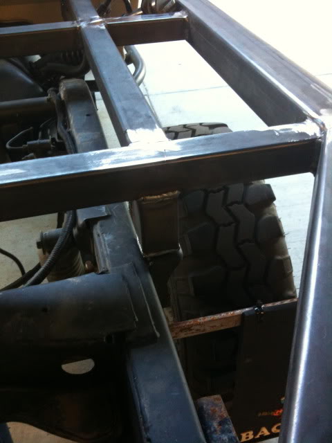

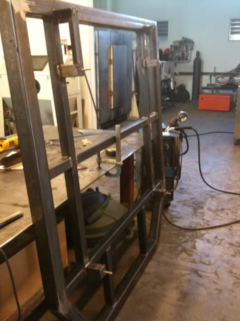

laying out the structure...

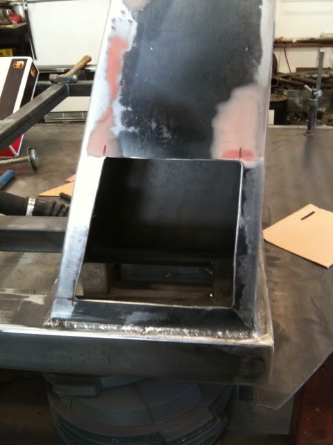

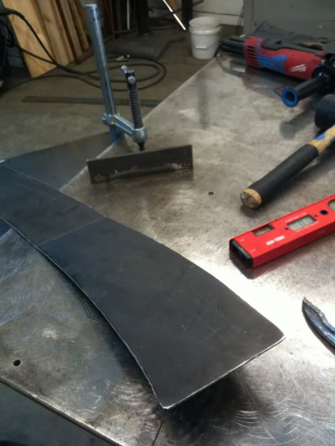

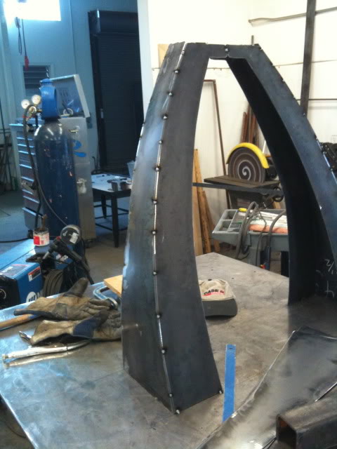

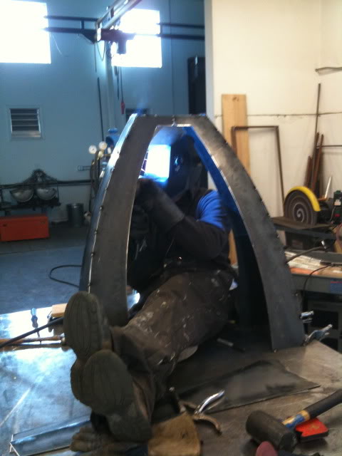

Tracing and cutting the headache rack...

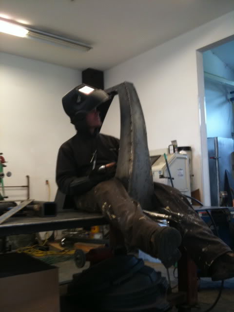

Fabbed up the one side, tacked it and mirrored it with the other...

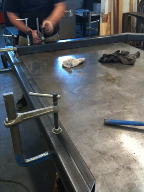

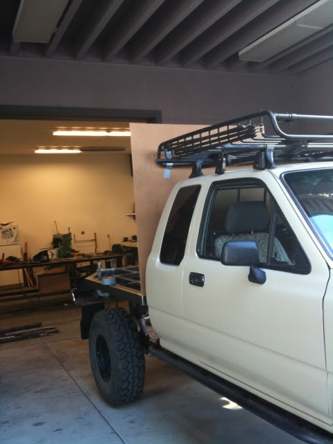

moved the frame in and checked everything out..

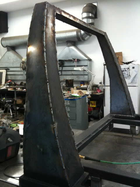

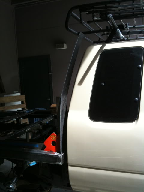

headache rack in place, tacked up...

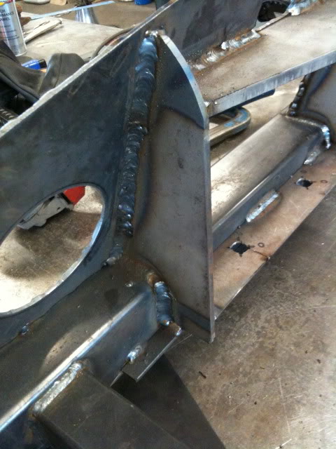

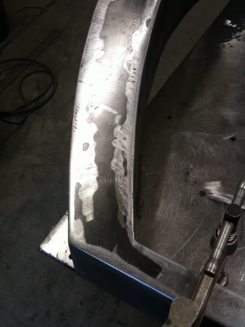

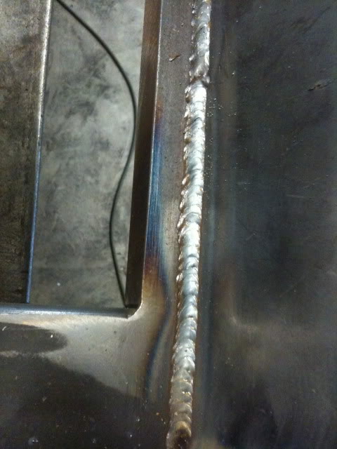

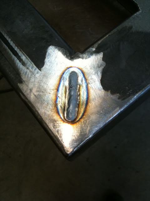

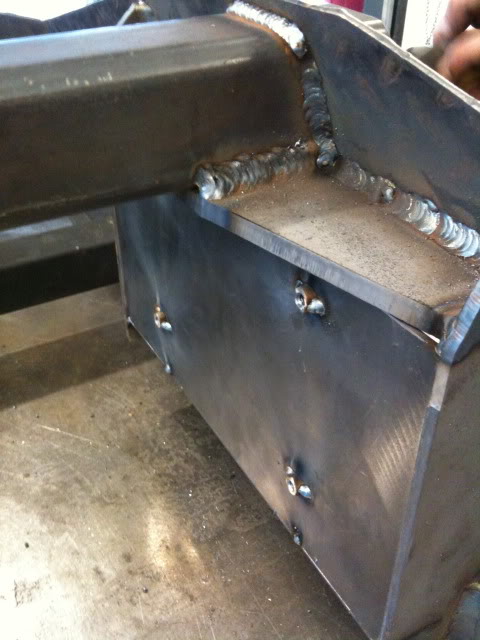

I was sweating that weld... Thats the visible one

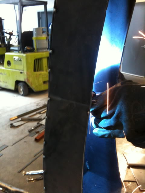

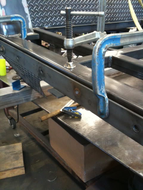

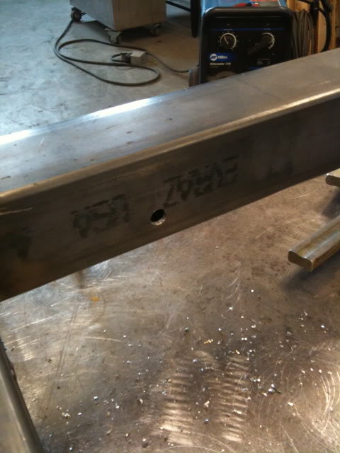

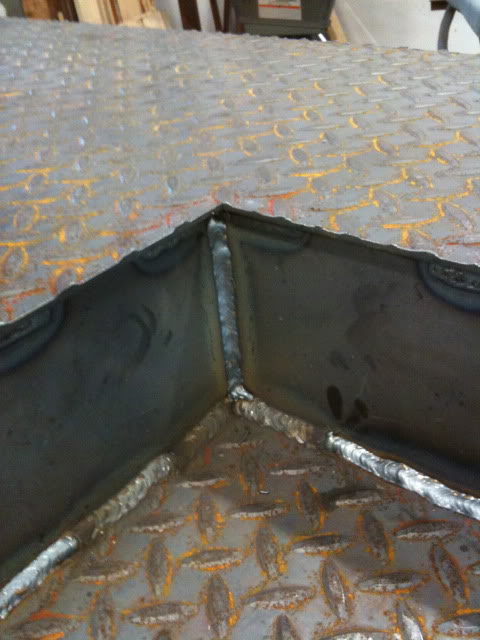

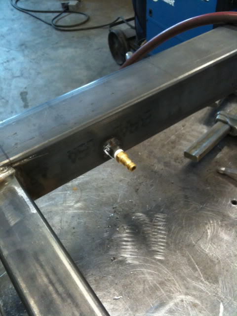

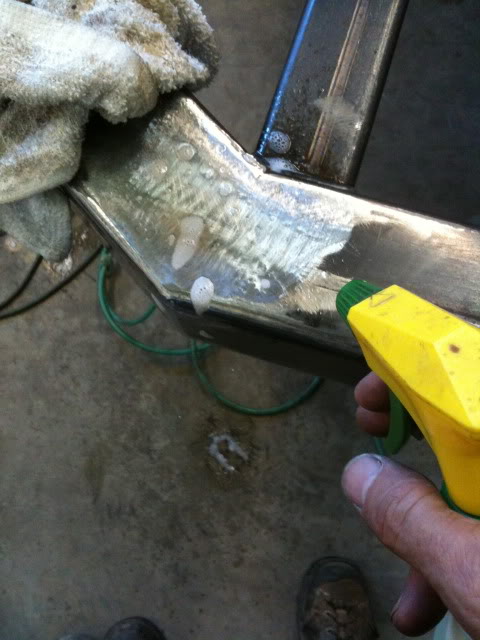

While we were finishing up the 45 degree seams on the frame John made this comment "why not make an air tank out of your flatbed frame "
So we did...

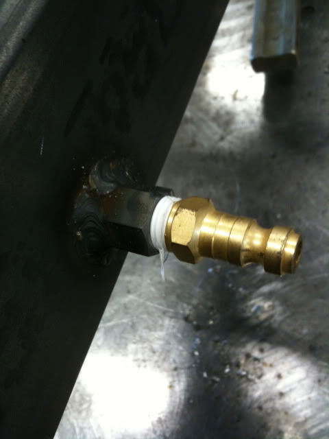

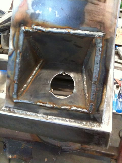

drilled and tapped hole...

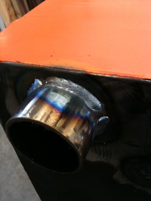

TIG weld nut and fitting...
And there is its home...

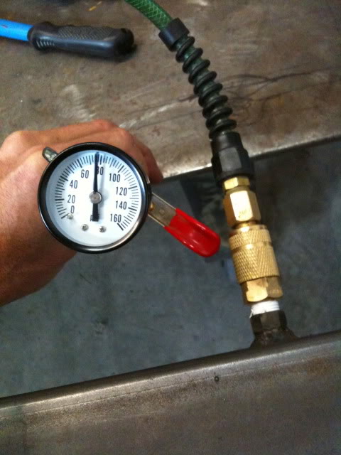

Testing for leaks. Yes there were quite a few. NO PROBLEM, get out the TIG!!
Finally got the leaks under control. This was the shop PSI after a few take on and take offs. It held at 80 PSI for 4 days. Not a drop of air gone
I have a little 12v air compressor rated at 250 PSI. I wired in a cig lighter in the passengers side compartment where the old jack went in addition to the hose and gauge. It works like a charm. An air tight flatbed holding roughly 8 gallons of air

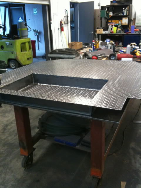

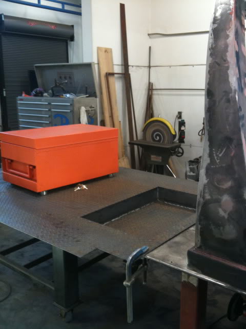

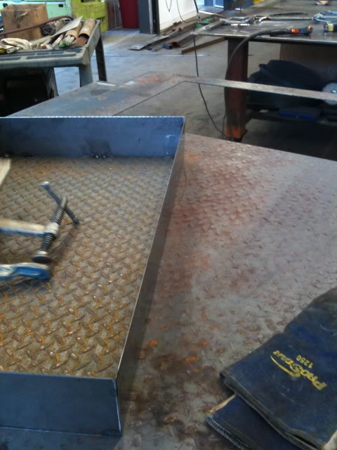

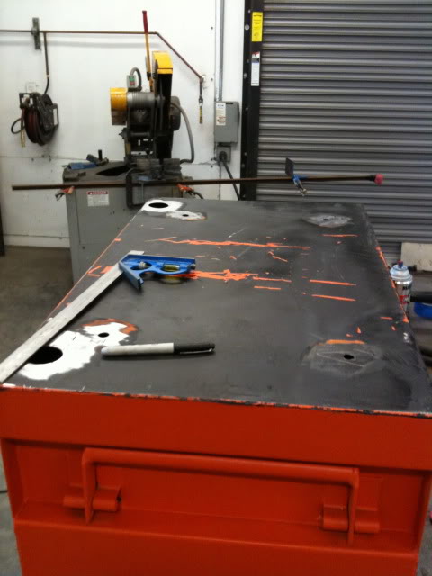

I wanted to recess the lock box down in the empty space above the gas tank. It was roughly 4". This also allowed me to secure the box from being stolen...
I made a box for the lock box to sit down in...

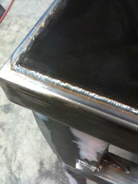

I had to stitch weld it to keep the heat transfer correct.

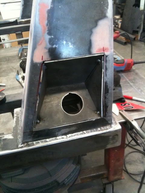

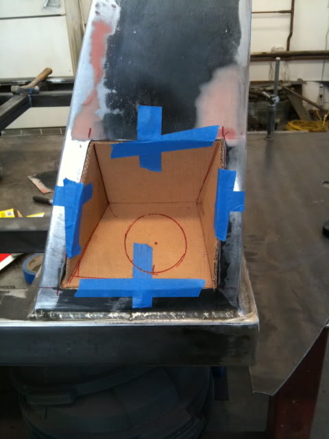

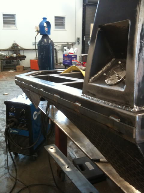

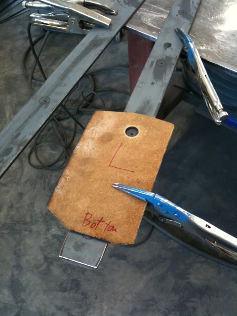

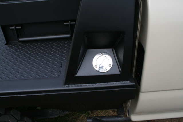

Time for the gas cap..
Cut the hole for placement and did templates for positioning..
Template and the position of the gas cap a little forward to make the hose fitting correct...

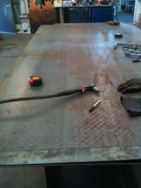

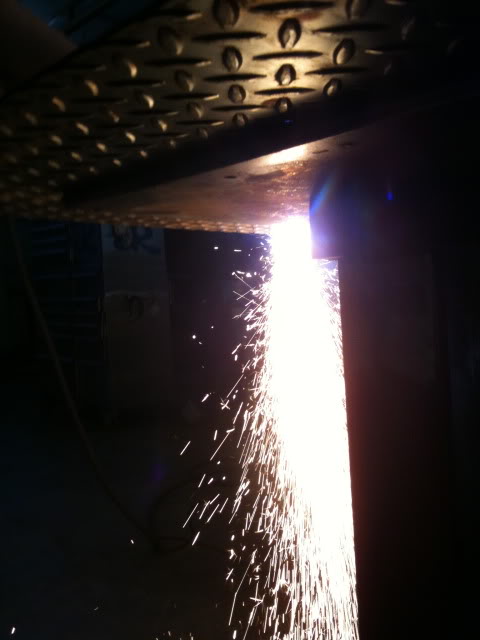

Plasmaed the gas hole...
It was easier to weld off the bed..
welded in little nuts to catch the screws from the cap...

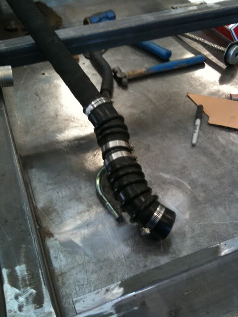

Gas line ready PITA...

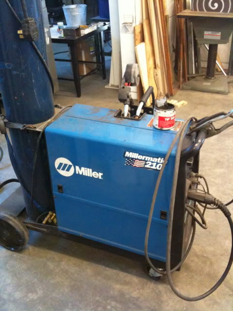

I thought this was interesting. I made a little video of the MIG dialed at 3 with a 35 line speed...

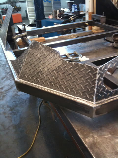

Trailer hitch and diamond place skirting...
I copied the license plate light template

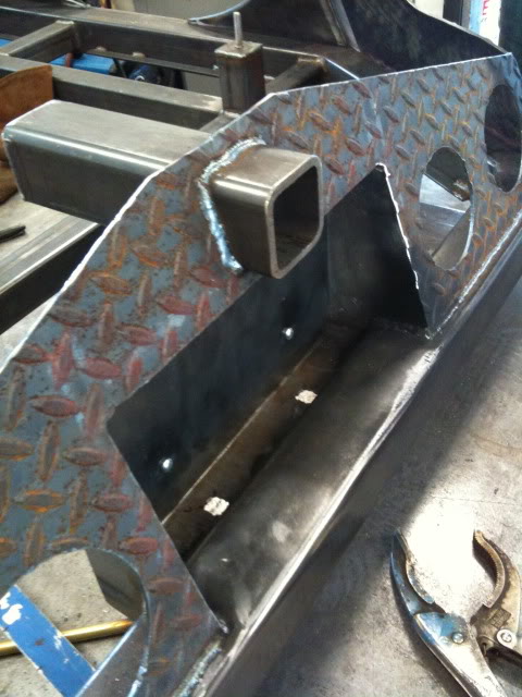

license plate box. It is part of the structure for the hitch..
I had to use deep welds for this...

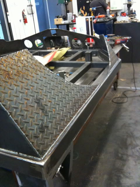

I knew at some point I was going to have to chop chop...
skirting getting welded on and shined up....

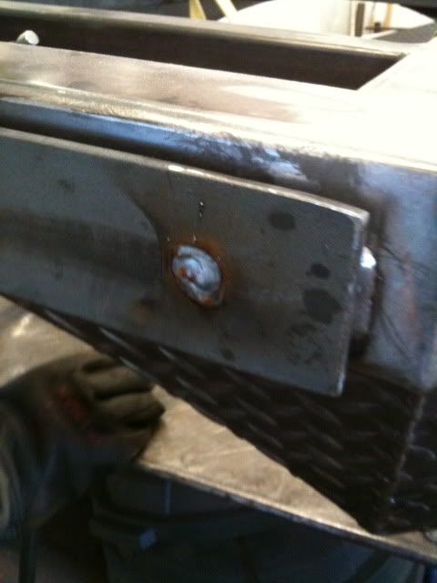

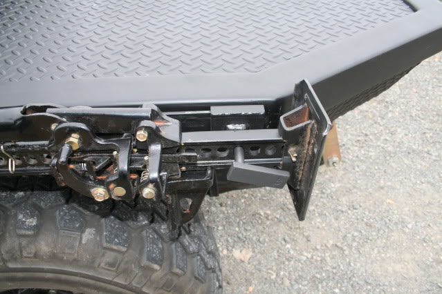

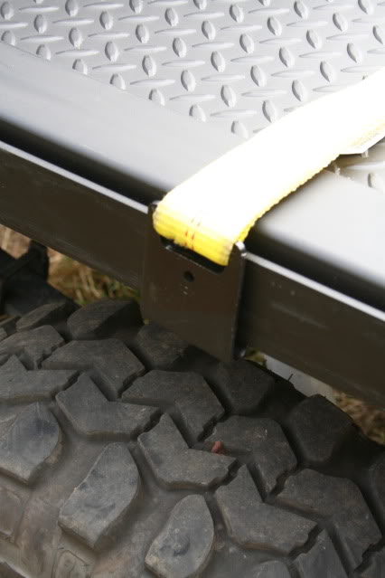

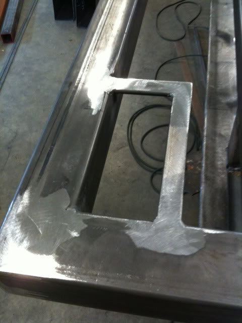

John suggested I make the diamond plate deck removable in order to have it rhino lined. I welded on bolts and angle iron on the frame to attach a lock nut and washer...

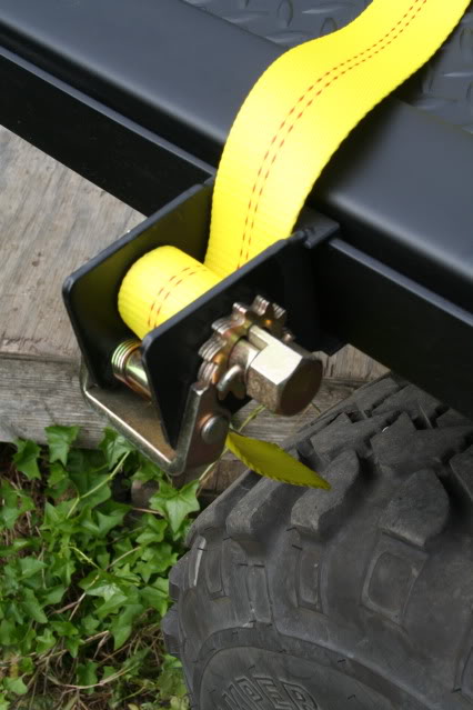

This was similar to what John had done on his rig. This set up is for the highlift jack to slide on and off as well as the winches..
I stitch welded the inside bar, plasmaed the holes and plug welded them on the frame and then sanded it all smooth...

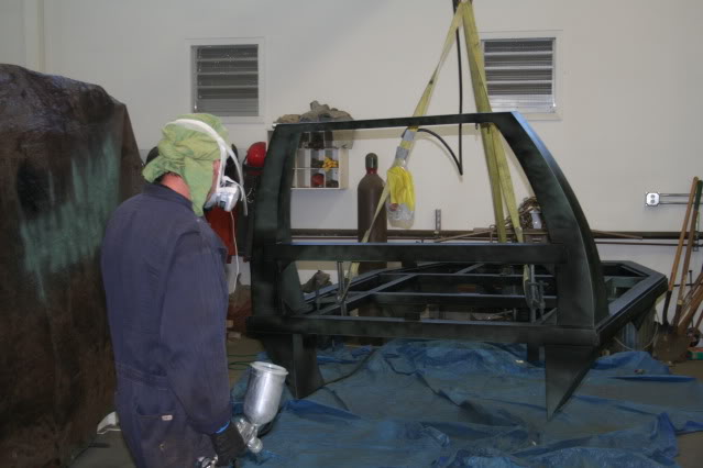

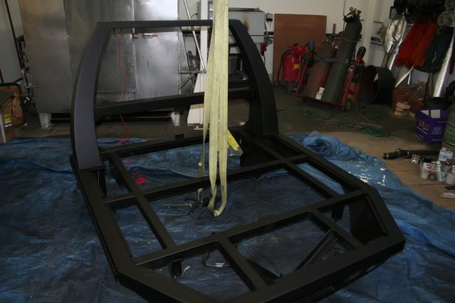

Time for PAINT!!!
I used an acid based primer and the paint is an industrial enamel used on most flatbeds...
Primer..
Paint tack coat... Kinda looks like I am facing off some giant evil metal creature.
PAINTED!!!

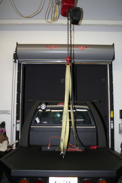

everyone needs a 1 ton hoist!!

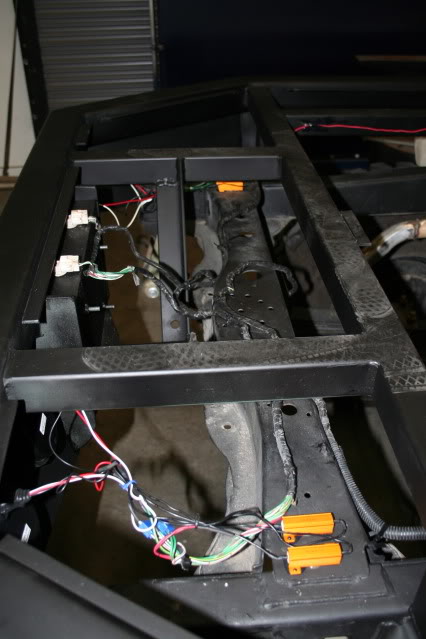

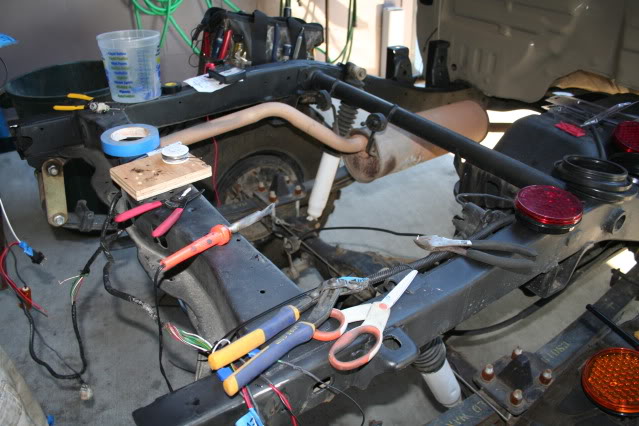

LED wiring..
LED load resistors...

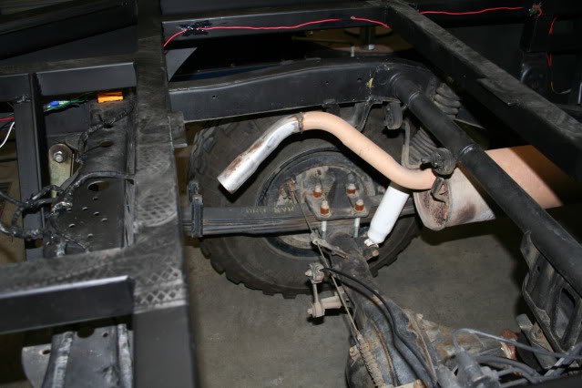

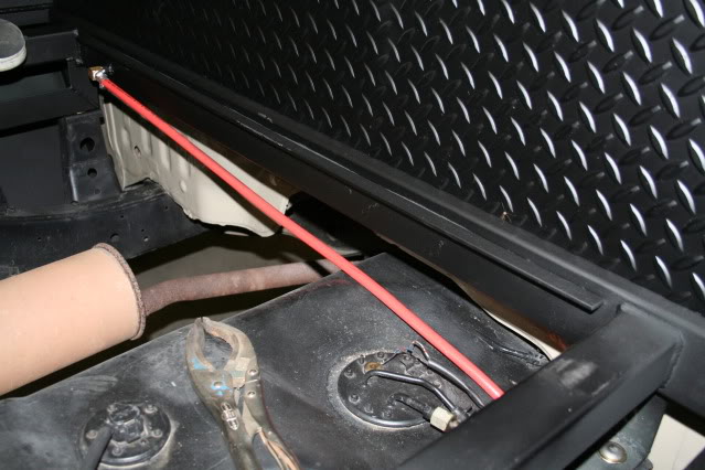

Air hose run under the passenger side firewall...
I had some issues with the muffler. I had to cut a chunk out and re weld it...
All wired in...

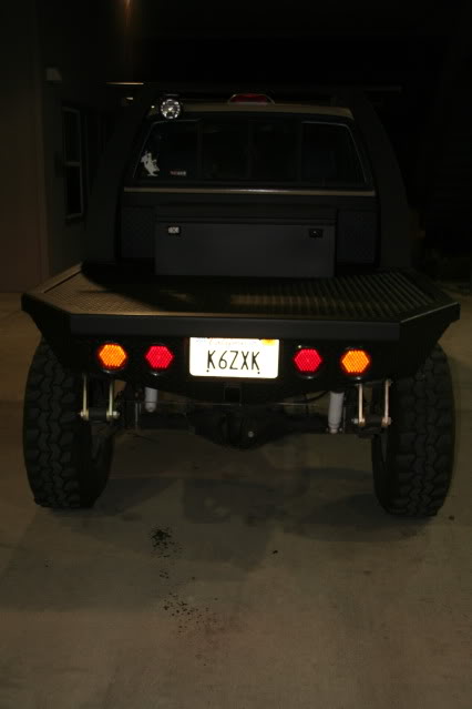

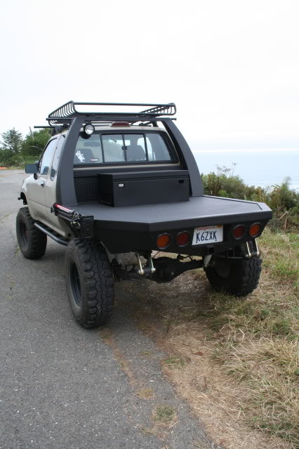

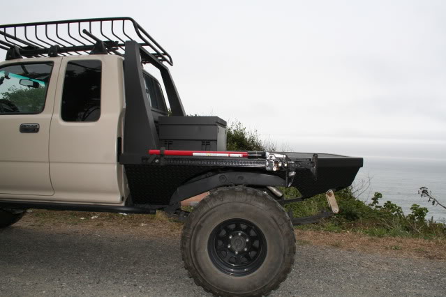

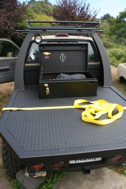

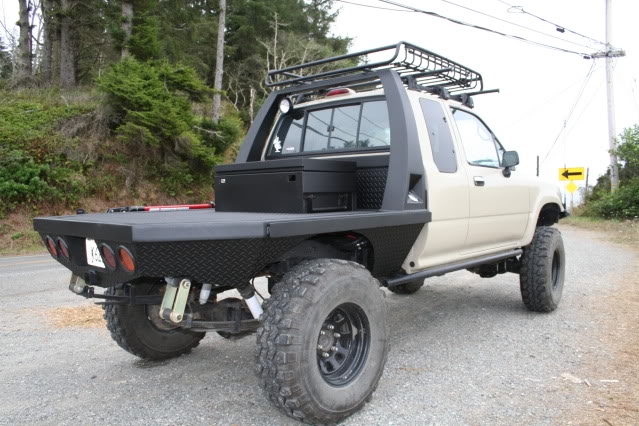

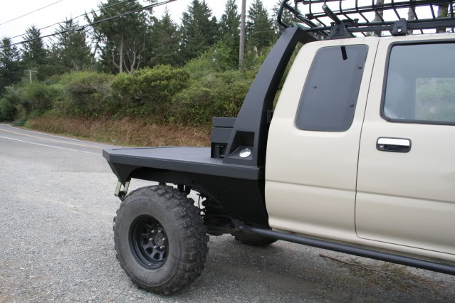

FINISHED!!!!!

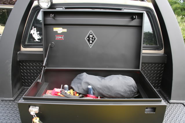

Here is what keeps it safe at night

BTW, that air compressor in the the frame is ingenious.
Old Sep 16, 2009 | 08:43 PM
lostINtheSAUCE's Avatar
Joined: Sep 2009
Posts: 29
From: Roswell ?
im gonna have to agree with everyone else on here. Thats pretty bad ass!!!
Old Sep 16, 2009 | 09:07 PM
malteserunner's Avatar
Joined: Sep 2006
Posts: 1,537
From: Ca
Well worth the wait! That is the best looking flatbed I've seen yet. The paint turned out awesome. Great job!
Old Sep 16, 2009 | 09:19 PM
pennywize's Avatar
Joined: Jul 2006
Posts: 284
From: Humboldt County, CA
omg, that thing looks awesome! good work!
Old Sep 16, 2009 | 09:38 PM
xyzalvarez's Avatar
Joined: Aug 2009
Posts: 43
WOW!
attention to detail ! clean work right there! congrats !
PS when you get this flat beds on manufacture process , i want one !
Bad @ss !
Old Sep 16, 2009 | 09:47 PM
sweet trav's Avatar
Joined: Jul 2008
Posts: 171
From: ...where the redwoods meet the ocean...
I agree...VERY nice! Where's the spare tire mount?
Old Sep 16, 2009 | 09:56 PM
Lama glama's Avatar
Joined: Oct 2008
Posts: 58
From: College Place, WA
No one could ever accuse you of doing anything half-a$s!! Now all you need is a 3.4L!
Old Sep 16, 2009 | 10:22 PM
camo31_10.50's Avatar
Joined: Aug 2007
Posts: 5,334
From: Vian, OK
holy ....
its
its
its BEAUTIFUL!!!!!
it is EASILY the MOST AMAZINGLY built flatbed EVER!!!!!
only thing i would add are like maybe a 1" or 2" rail going all the way around..just to keep things from rolling off ya know
but still..thats incredible..too bad your all the way in nor cal or i'd be paying you to build my front and rear bumpers..wow
Old Sep 16, 2009 | 10:24 PM
toylocost's Avatar
Joined: Jul 2007
Posts: 1,705
Likes: 12
From: Yotatech, because Pirate is too expensive. NorCal.
OK the frame isnt an air compressor. Its an air tank.
Other than that, its very nice. Best flatbed I've seen. You lay down some nice welds too. Nice shop btw.
Old Sep 16, 2009 | 11:52 PM
RMP8080's Avatar
Joined: Mar 2009
Posts: 1,169
From: (LSD) Lower Slower Delaware
As my Friends from the Great White North would say “Great Job A”
Old Sep 17, 2009 | 12:53 AM
RiCh_90-yota's Avatar
Joined: Jul 2008
Posts: 197
From: Reno NV/Oxnard CA (805)
Best looking flatbed Ive seen Good work
Old Sep 17, 2009 | 02:51 AM
YeloSub7's Avatar
Joined: Mar 2005
Posts: 1,010
From: San Jose, CA
I have to agree, best flatbed I have ever seen! Nice work! I mean great work!!
Old Sep 17, 2009 | 04:07 AM
85TurboRunner's Avatar
Joined: Aug 2004
Posts: 2,077
From: Vancouver, WA
Great work. That is the nicest flat bed I've seen. It looks factory but better.
Old Sep 17, 2009 | 04:16 AM
HazMat's Avatar
Joined: Sep 2008
Posts: 478
From: Mechanicsburg, PA
ehhhh. I like the softopper better. J/k man that is a beautiful, well thought out project done to perfection. Very nice job.
Old Sep 17, 2009 | 04:41 AM
stock as possible's Avatar
Posts: 414
From: North Carolina
Mighty fine, mighty fine.
