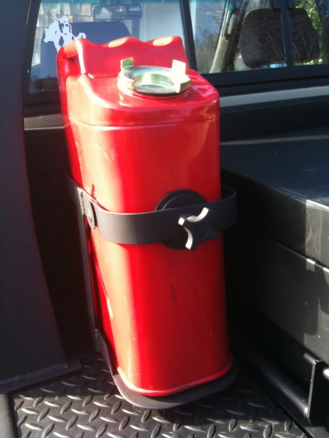

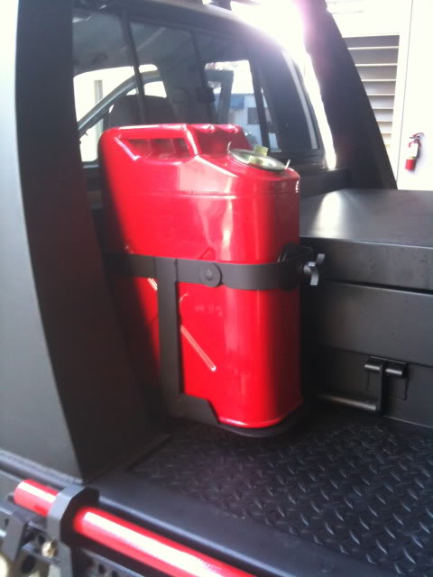

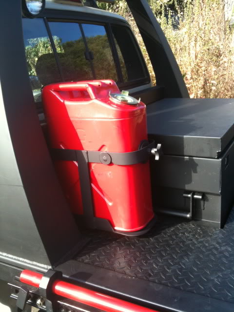

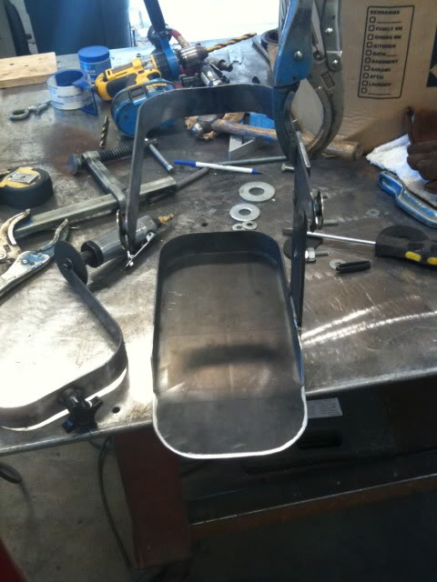

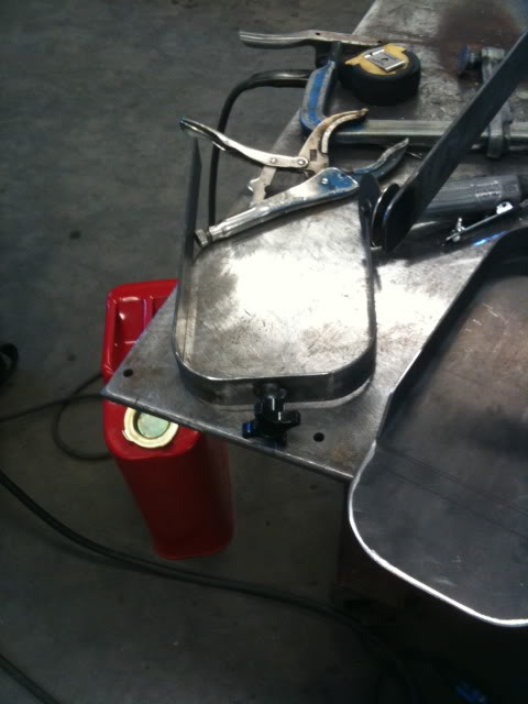

I had far too many issues with my gas jerry can on my last wheeling trip so I decided to come up with something new. I had John help me with the desgin. It is super solid and strong!!

here is where it is mounted- To the tool box...

floats off the bed by a few inches...

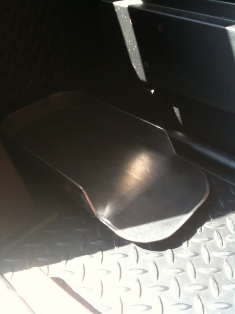

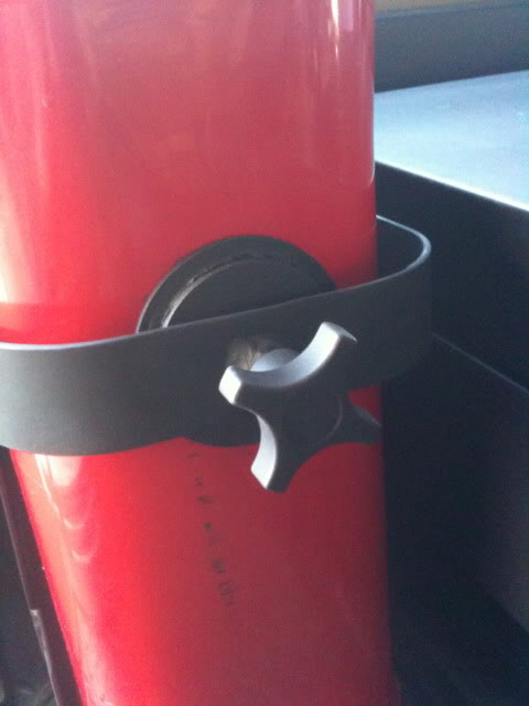

welded a big washer and glued a rubber stopper to hold it in place with the turn knob...

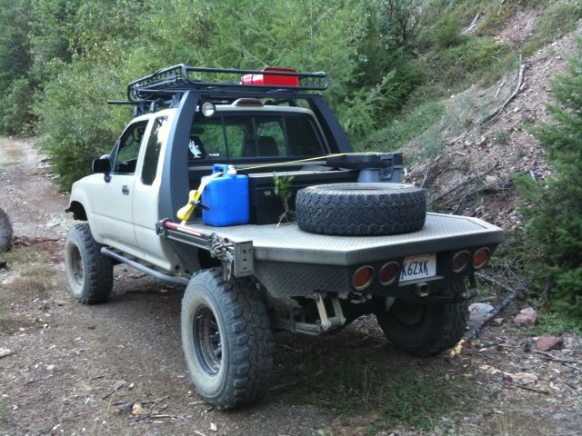

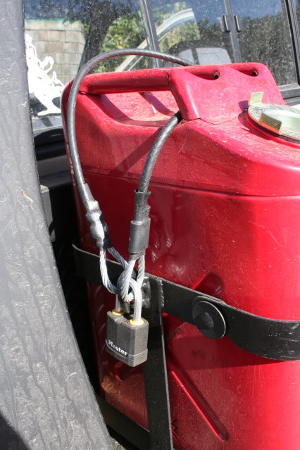

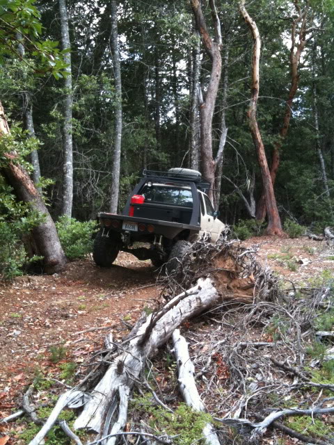

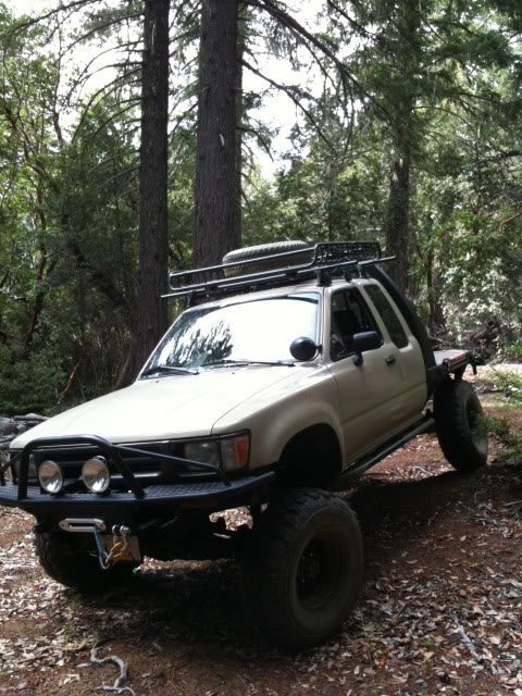

Got the gas can secured. It won't keep them for stealing it but it will take them a little longer
Took it out for a spin. Did some pretty decent wheeling. No wheeling shots (I was alone and couldn't get any decent pics of it in action.)
With the the gearing, the Aussie and the flatbed (weight) the thing will literally climb a Redwood tree! I am totally amazed at what this little truck will do. And it hasn't even started raining yet
