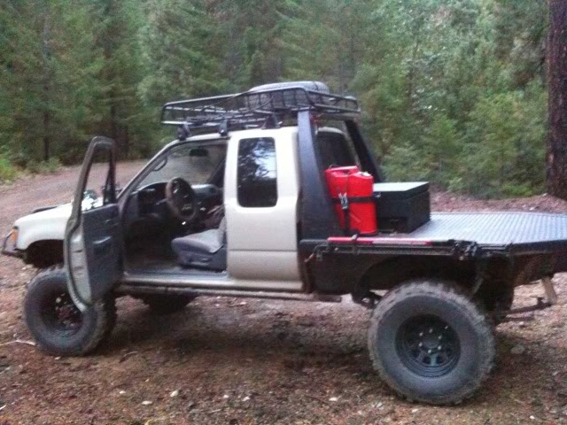

It is working out great! I added a leaf to bring it up to level. I had a little bit of a sag and I had an extra 2 leafs that would fit the OmE leaf pack. It brought it up just a little in the back. I kinda like the look of a slightly raised back end. I really rides nice. The weight is toward the middle of the rig and it is a little different than the stocker bed. I really like it. Wheels incredible. I did some decent wheeling in the past few weeks. my only regret is it is really muddy and dirty. But, eh thats what its for.
Thanks again!
Kind of a bad pic-
