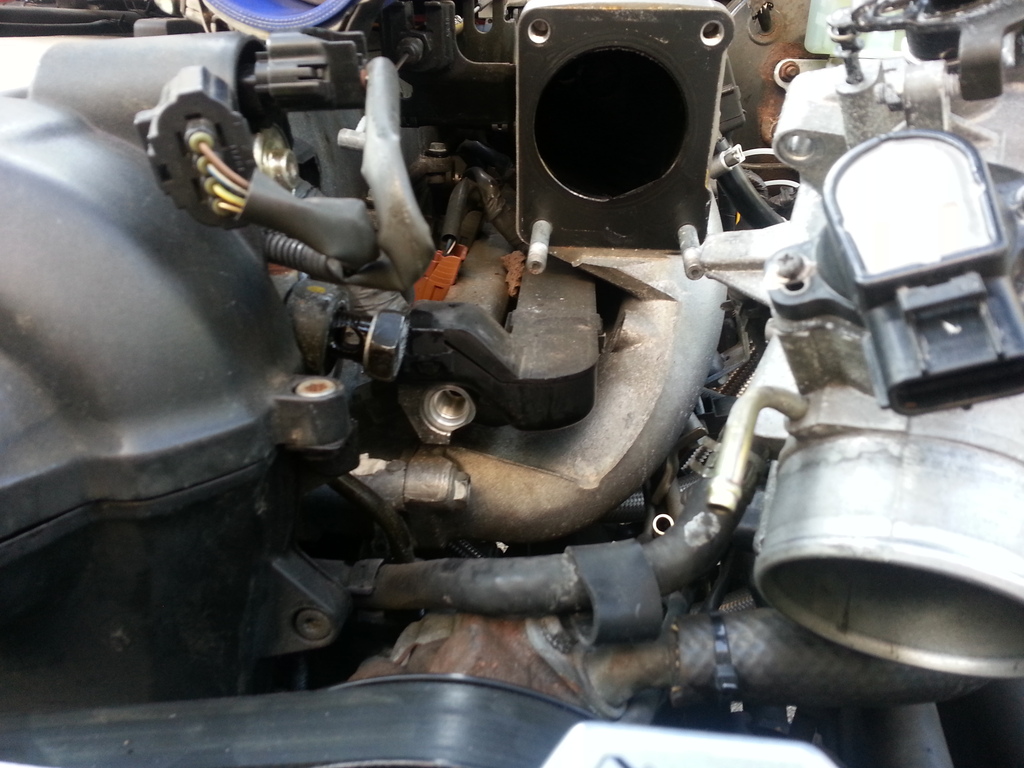

Originally Posted by captainslow

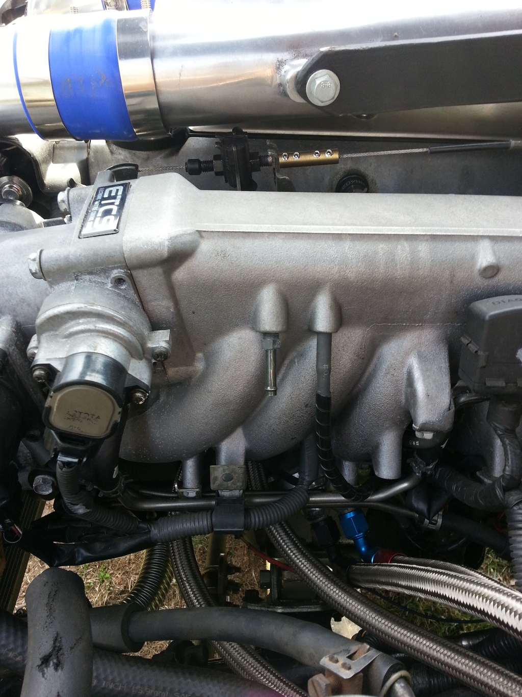

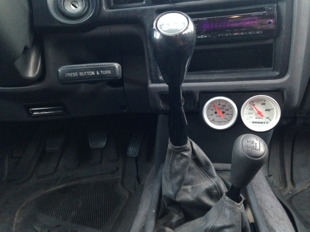

oh that looks so good! I've thought about doing that with the overhead jdm helix 2nd gen version, but right now by pyrometer and boost gauge replaced the ash tray
I'm curious to see how much boost your making.. where are you going to plumb it off the motor?
Put a picture up, id like to see how that looks.

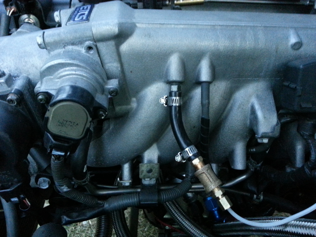

Here is mine, there was a spare nipple that I capped off when I did the swap.
Lol PLEASE do not judge me on my hookup for the airline. Hardware store was slacking in the fitting I wanted so I had to use what I could to make it work.
At idle I have about -22 in a vacum. On the street I get about 11 maybe 12 pounds of boost.

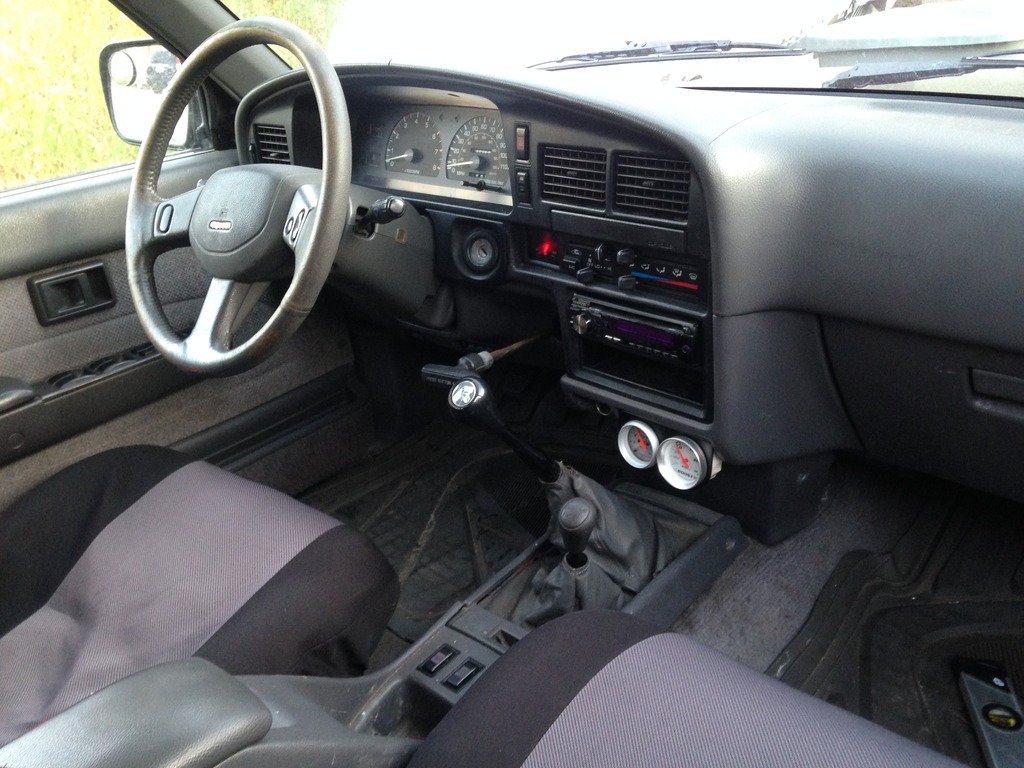

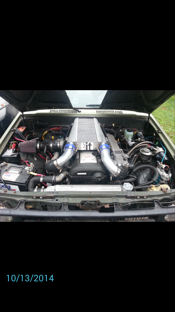

Looks like we plumbed it in similar locations. And we're making similar boost. I won't poke fun at your fitting, so long as you don't poke fun at me using 2 different gauges... (soon to be fixed)
here is the interior, you can see the ash tray bezel
and here is where the boost is plugged in
And here's the latest engine bay shot... on the left - have the custom air box, you can see the tower bracing we added from cutting out the stock front bracing to make room for the radiator. which also means no more hood latch, converted to pins. On the right the aluminum box houses the ECU.

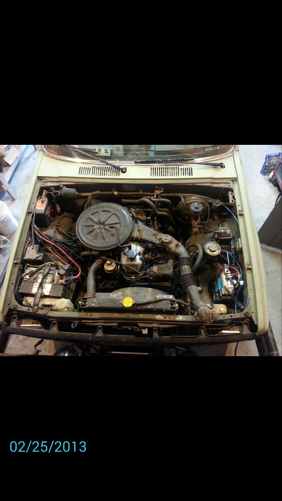

Just cause its late and im bored here is a before and after picture for the thread

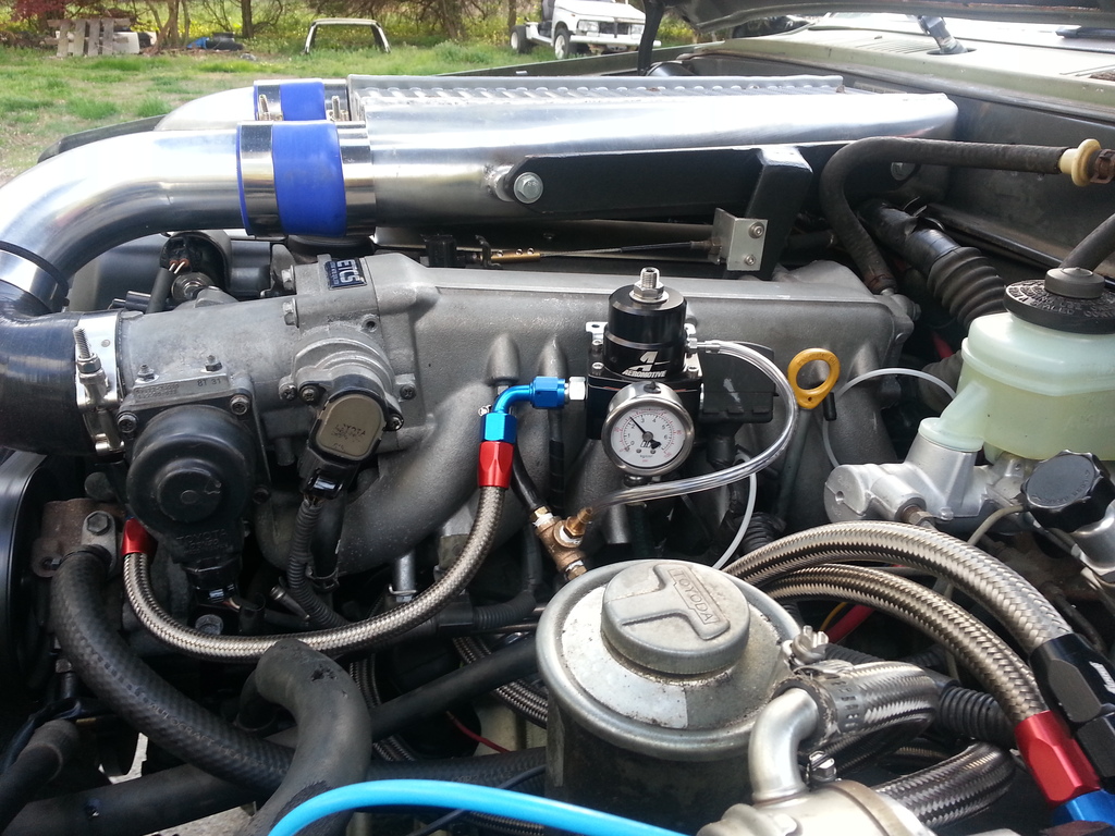

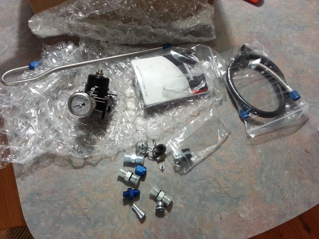

this is the Aeromotive fuel pressure I installed. I had ordered the whole kit from Driftmotion.com. It was listed for the 1jz gte but did not say if it did or did not work with the vvti. We'll is certainly Does Not. The prebent hard line they send to run towards the back of the motor tucked in by the intake manifold doesn't fit close to the way it should. Not really big deal just mean I spent more money then needed and had to make my own line to go from the fuel rail to my Regulator. All that's left is to weld a small bracket of Aluminum to the intake manifold to bolt the regulator to. Had to remove the throttle body to get the stock regulator and install the fitting needed to go from 12mm threads to AN6 hose.
Once installed with just the fuel pump running and no vac line connected I turned it down to 38-39 psi. Connected the vac/boost line started the motor and brought me down to about 34psi. what an UNBELIEVABLE difference it made. Instantly it idled smoother, throttle response was much snappier and really feels like I picked up some more torque on the low end. It's no longer getting double the amount of fuel it wants and can actually burn everything being fed to it.

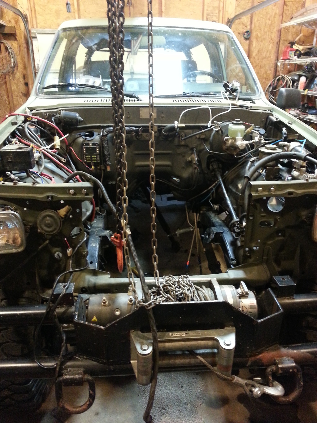

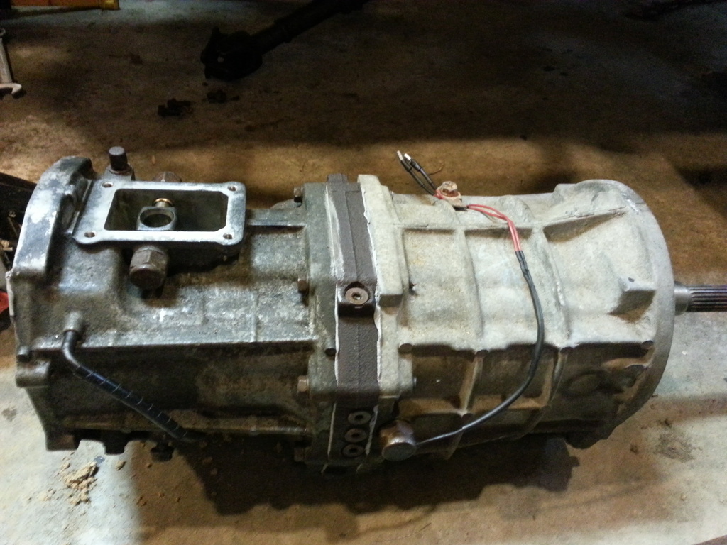

On a side note. This is the current state of my Runner. The main input bearing finally got bad enough and too loud that I finally had to pull the trans out. Trans guy said he could not break it down due to the rust that had siezed some components from when it sat in the junkyard full of rain water.
Luckily enough I found another one out of a running truck that rusted out at 120,000 miles.
It's such a tight fit in the Runner I had to pull the whole motor and drivtrain assembly to get it.

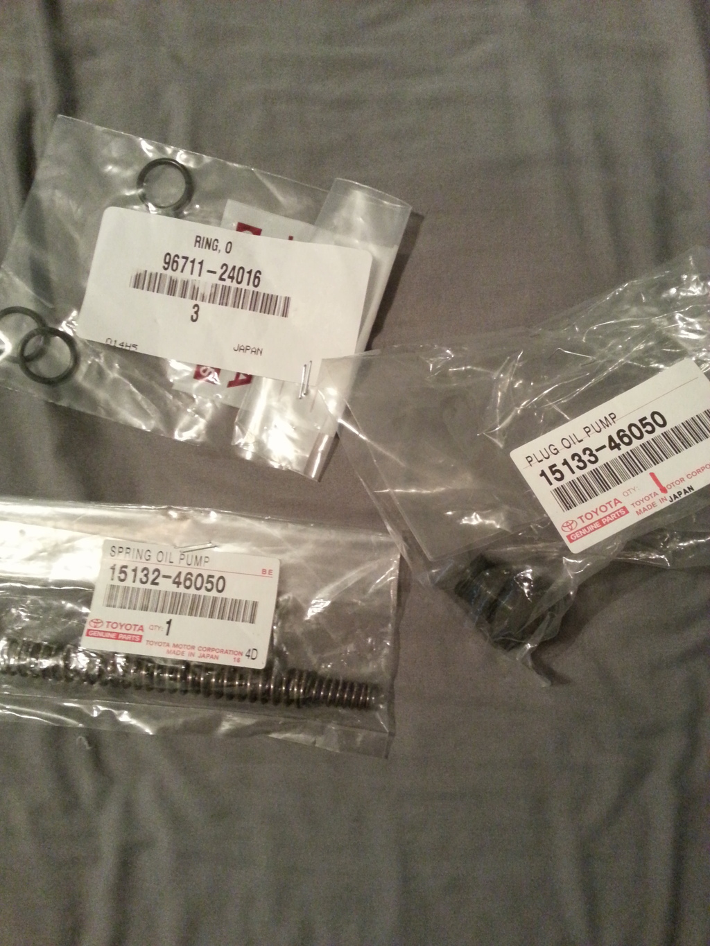

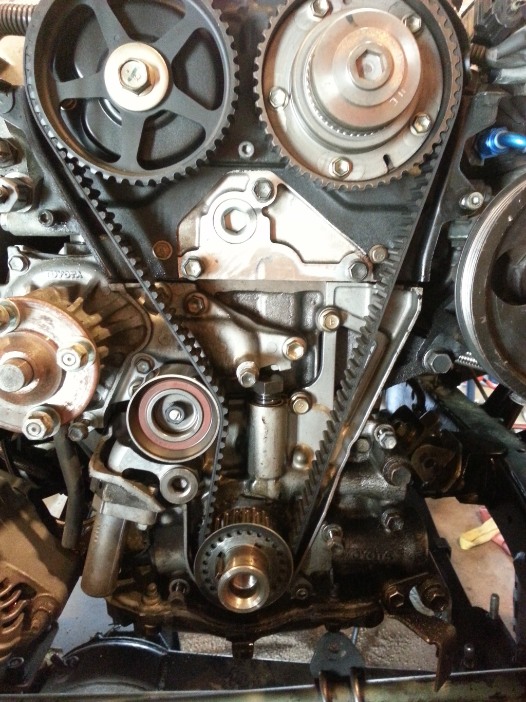

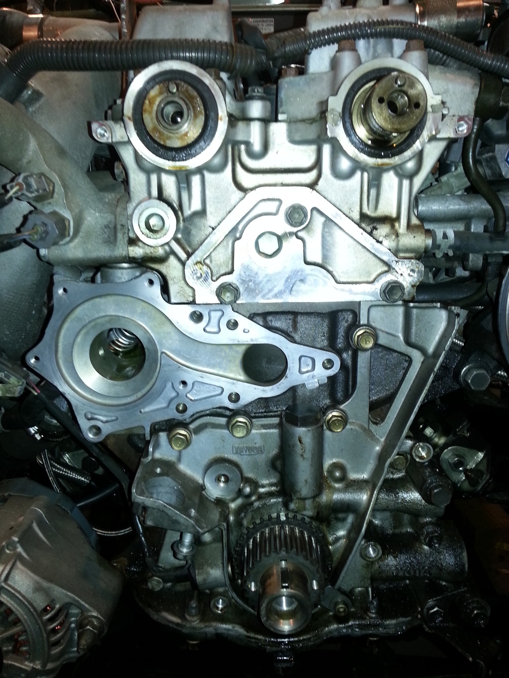

So it has been awhile. Everything is back together been driving for a few weeks now. Just some updates, for the motor I did. When the motor was in prior to taking apart I noticed an oil leak. I thought it was just the lower oil pan gasket. But once the motor was out and got a better look and doing some reading on forums I realized I had a much bigger problem. A lot of people it seems with the JZ motors have a problem with the oil pressure relief plug and seal on the top side of the oil pump. Name:  20150827_170645.jpg
Size:  619.4 KB People who use generic Orings around the plug seem to have the leak return so I found a genuine Toyota part to replace it. Once I realized what all has to be done just to get the plug out. I decided to to do a full front end 100k service on the motor. The bag in the top of the picture is the part number for the Oring. Bag on the right is the plug Name:  20150827_165751.jpg
Also torque when reinstalling the new plug I belive was 20 or 22ft LBS.

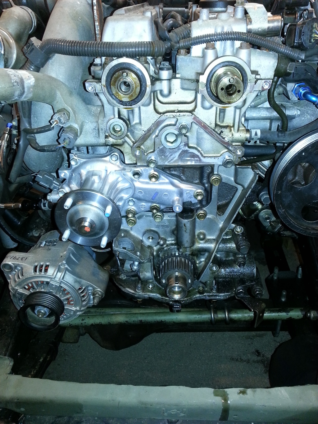

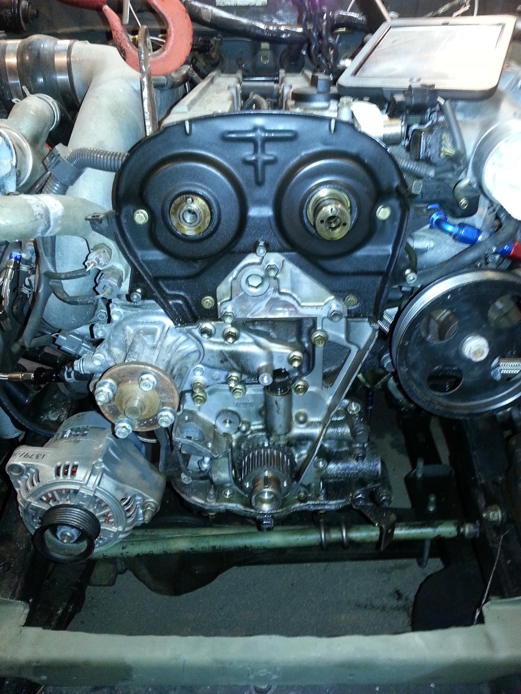

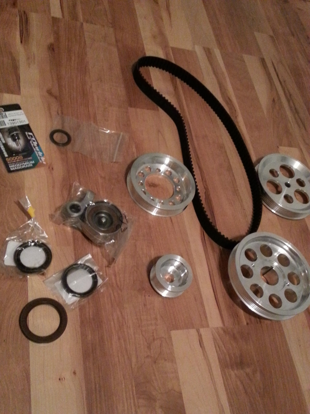

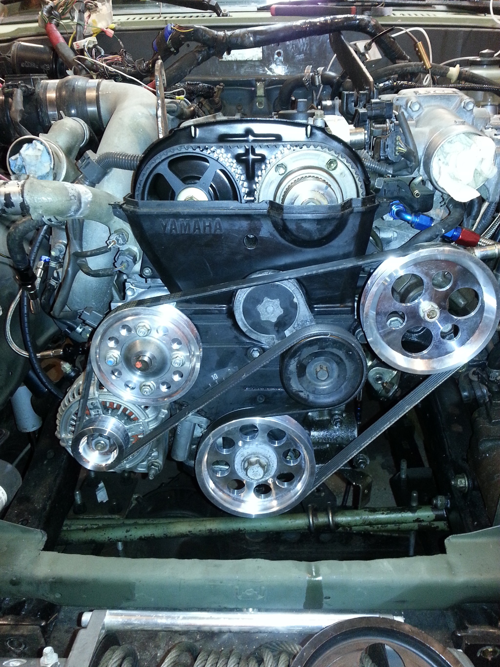

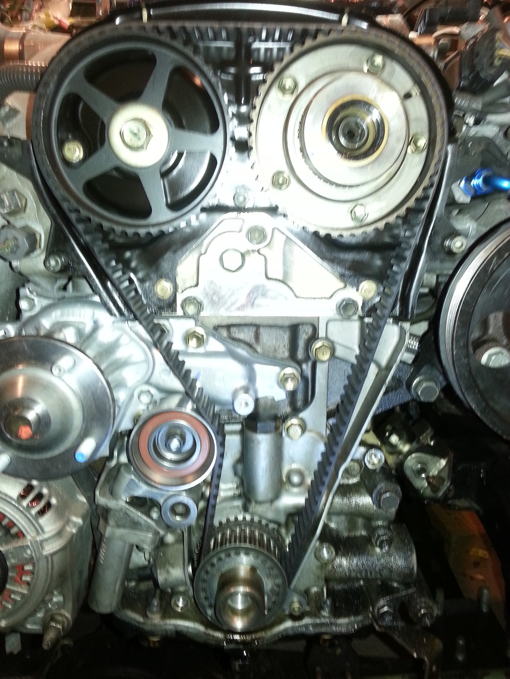

For the motor I did, New water pump Timing belt and timing belt idler pulley assembly with new bearing. I did not replace the tensioner New front main seal and front cam seal for intake and exhaust Aluminum pulley set The water pump for 1jzgte vvti was extremely hard to find in the states. They were on ebay out of Austraila but that all I could find. So while reading on forums I had read some dispute about a 2jz Supra water pump working. So to decide I just went and bought on from Autozone and it is an identical match. Except! The pulley bolt pattern is different so you will need a 2jz water pump pulley. All I replaced was the front pump not the entire housing. The seals are realitively simple just take time to do your timing correct in setting the cam gear marks to TDC when you take the cam pulleys off. Name:  20150826_204236.jpg
Size:  483.4 KB Name:  20150827_191731.jpg
Size:  686.4 KB Name:  20150827_193853.jpg
Size:  570.8 KB Name:  20150827_195255.jpg
Size:  719.2 KB Name:  20150827_212824.jpg
Size:  586.4 KB Name:  20150827_223902.jpg

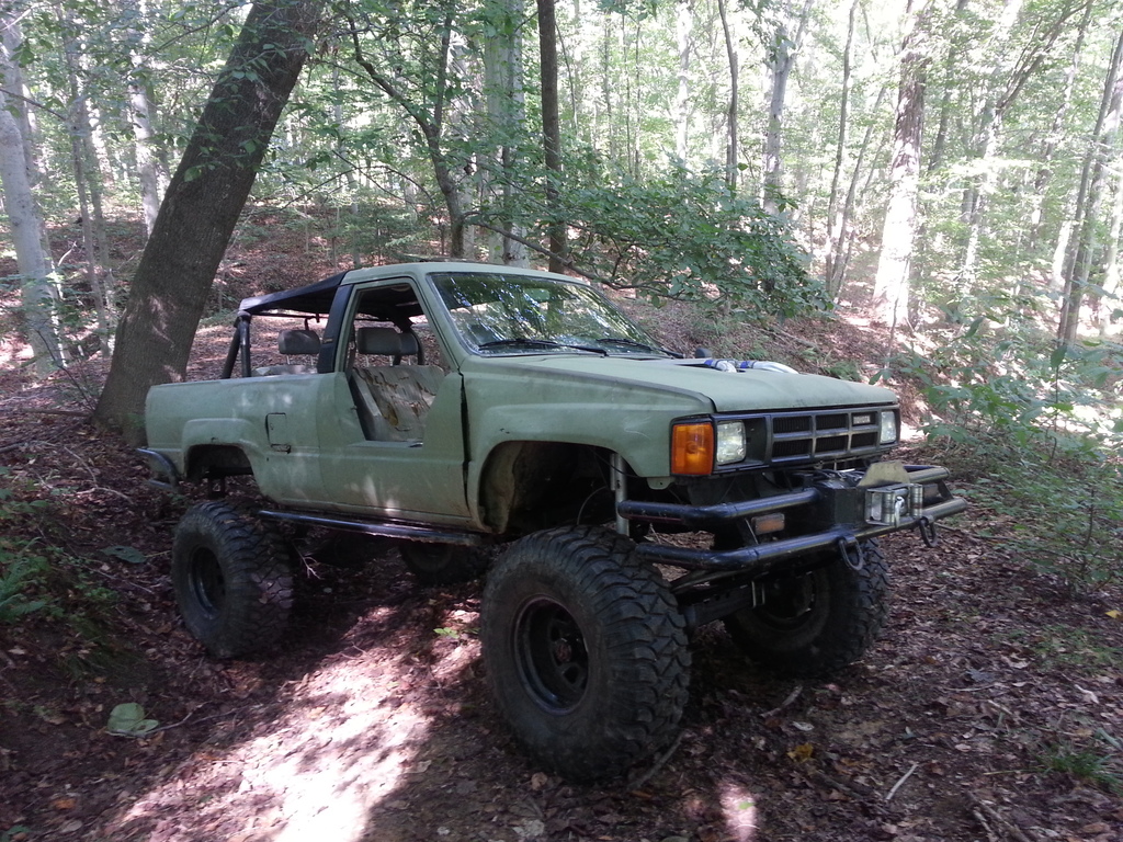

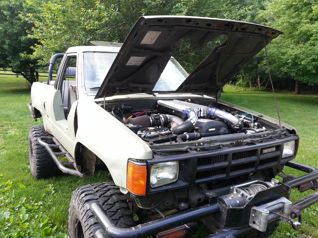

Took this just yesterday while getting a fallen tree out of my woods with the winch for some firewood

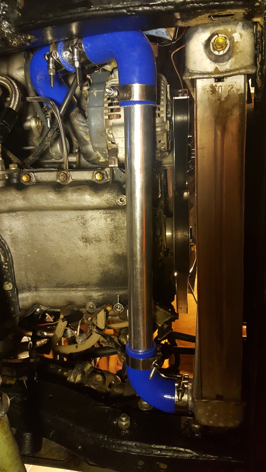

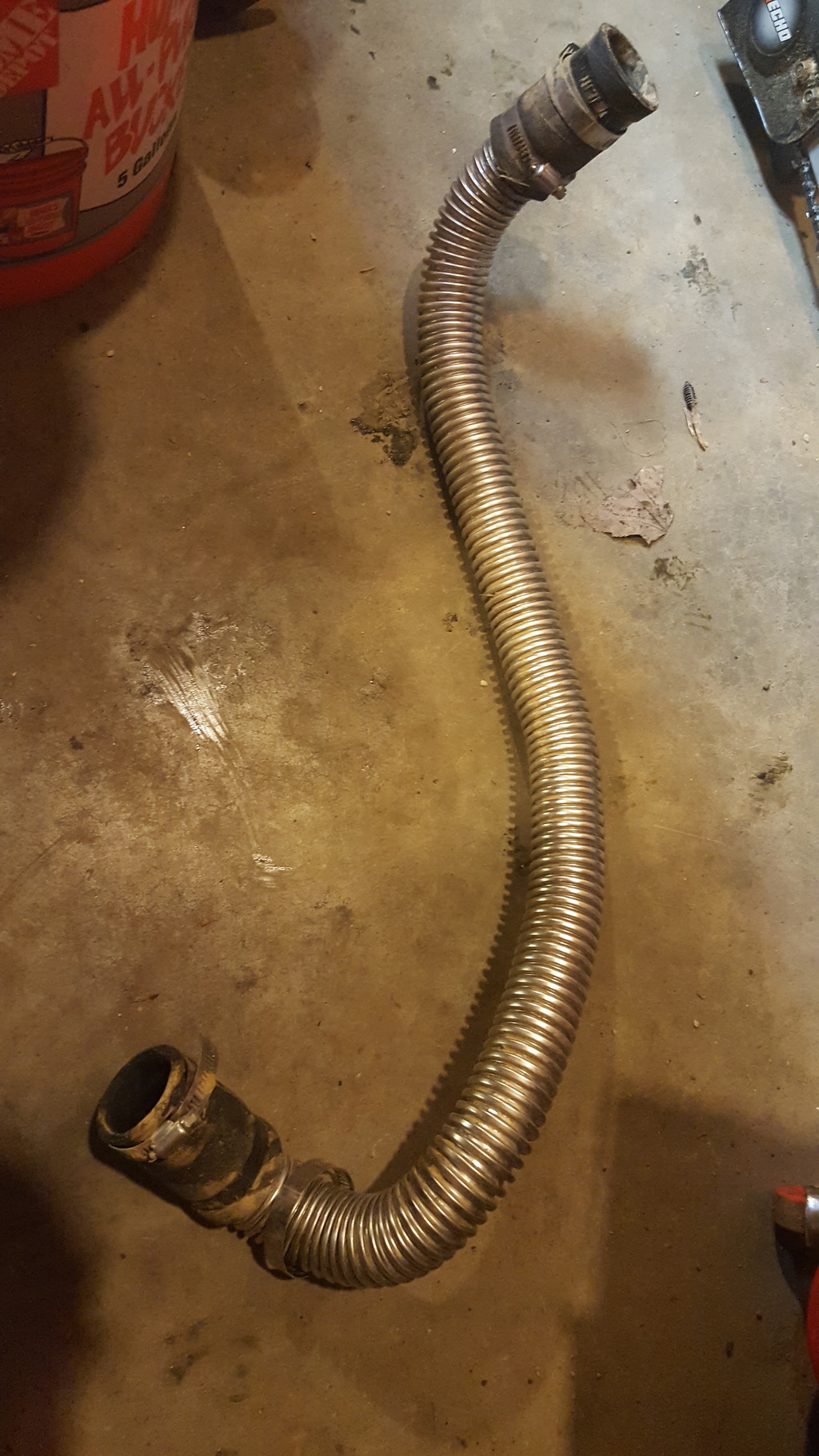

We'll since I had this on the road my coolant has been the stainless flex line with Rubber couplings which I did not really like or trust since it always leaked no matter what I did but at the time it was quick,cheap and easy. So I finally ordered some fittings and pipe and replaced it with a much more reliable setup. Some 1 1/2" 90's and 2ft of aluminum pipe with stainless steel clamps. I doesn't half to worry about this blowing out on me going down the road. I'll be posting some pics soon and posts soon. Recently had to tear the transfer case out and some minor tabs and perches came so I can roll my piņon angle in the rear and build my own trac bar!!
