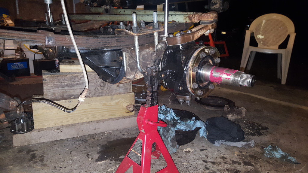

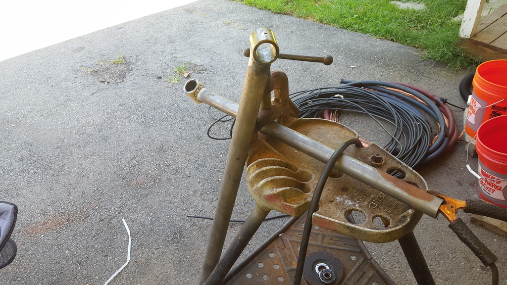

So since I first finished the swap it became very apparent very fast that I needed a trac bar to help the leaf springs hold the rear axle in place. So finally with a free Saturday a few weeks ago I managed to finally make one. The pipe had been laying for my bender and the bushings I orderd months ago so they'd be here waiting when I was ready.
The bottom half is 1 3/4" and the top is 1 1/2". True O.D pipe with 1/8" wall has a very tight tolerance but is perfect fit to fit inside one another. As my suspension travels the bigger pipe slides up and down the 1 1/2" with minimal play. The triangulated piece puts itself in a bind against the 1 1/2" when I'm on the gas keeping the axle from rolling either direction. A friend of mine at the marina showed me a picture of his friends 4runner that gave me the idea for this. Probly may not work to well if I was full flexing every weekend but for my occasional ride through the woods or swamp it's perfect.

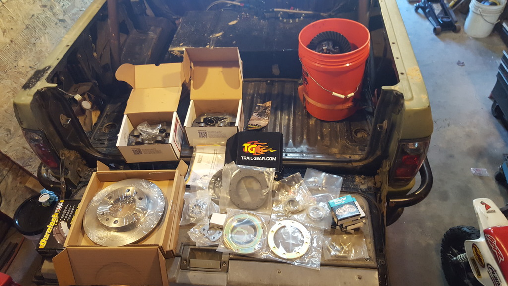

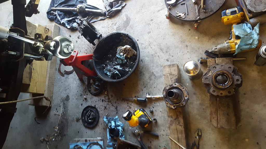

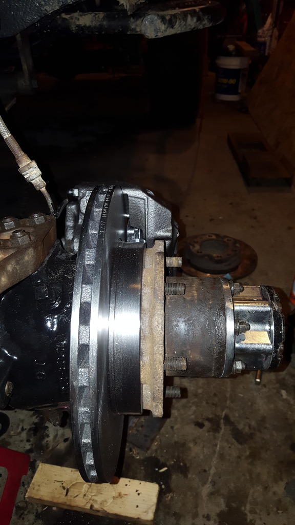

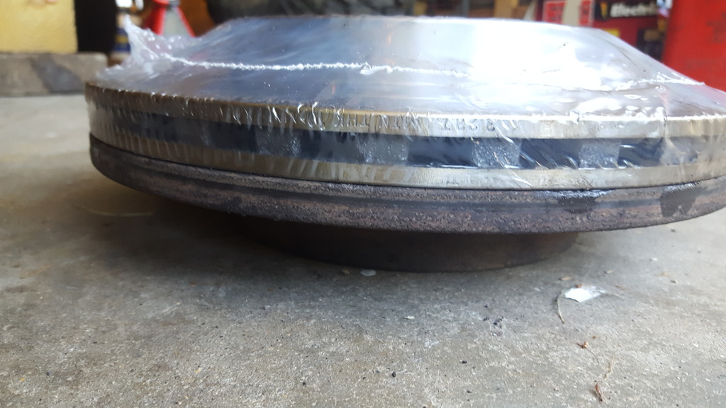

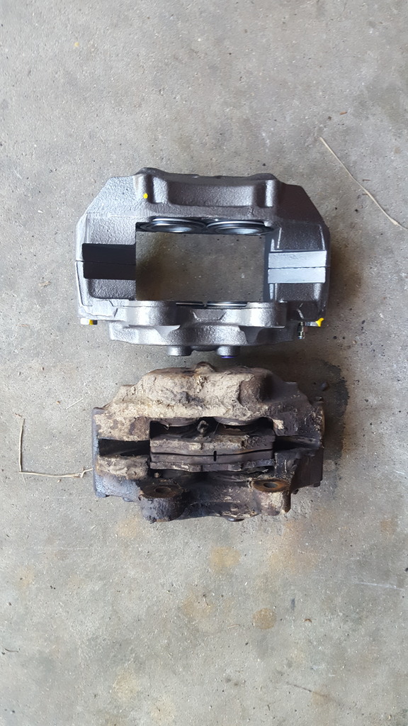

As of today this is what I've got going on. Yesterday I drove up to Baltimore and picked up another fj80 high pinion front end. It's been a few times my front driveshaft has pulled apart on me. Rather than lengthiness it again I wanted to try a HP instead. Plus not I have a front diff to match my rear end. Sadly however I went from a air locker in the rear and tru trac up front to just plain open diffs now eventually I'll rebuild both and put my lockers back in but not anytime soon.
So with the diff in hand it was time to start my front axle rebuild. This is what I have for it.
Trail Gear knuckle rebuild kit
Inner and outer wheel bearings for both sides
Trail Gear backing plate eliminator
FJ 60 front brake Rotors (Non vented)
93 v6 4Runner calipers with pads

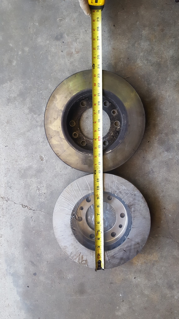

I think that's everything. The stock rotors to the FJ 60 rotors are the same diameter but different thickness. The calipers do seem to be a little bit larger. As much as people talk this brake upgrade I was expecting more but hopefully my braking will be noticeably improved when all this is done. Only had about 2hrs with it today and managed to get the passenger knuckle broken down and cleaned up.
I know they look different in pic but it was hard to hold tape across the two and center my phone up for the pic.
Lol trust me they are the same

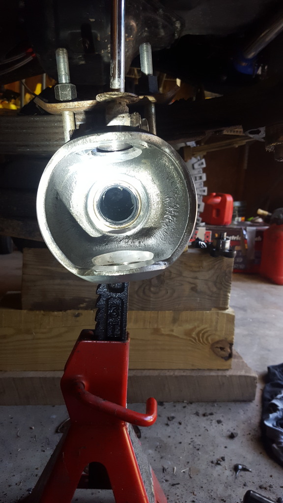

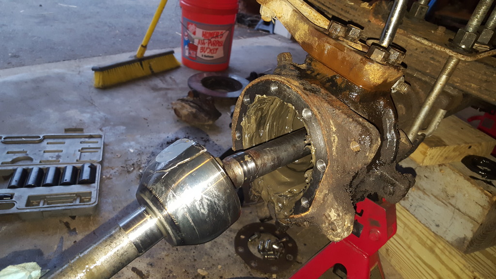

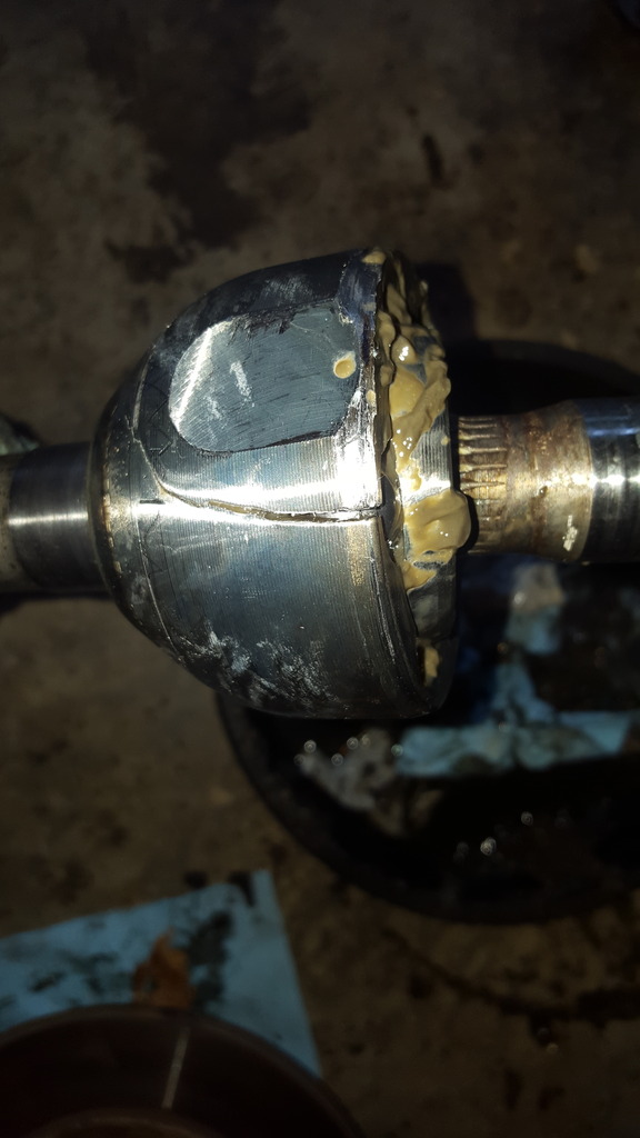

So I was knocking out the driver side this evening and came to an abrupt stop when I discovered this. Not sure when it exactly happened but lol I have a feeling my motor might be the cause of it.
Old Sep 26, 2016 | 05:56 PM
  #233
RBX's Avatar
RBX
Joined: Jan 2010
Posts: 3,795
Likes: 33
From: Bloodymore
I'm guessing that's a stock birf?
and looks like you need axle seals buy the soup in the knuckle. While your in there, tap a grease fitting to the square plug, makes keeping you knuckle greased convenient.

Yup, stock birfield. I really don't wanna spend any more money at the moment for trail gear birfield. I have a spare axle off an 85 pickup luckily so I'll be able to pull it out of that. And the knuckles were always just seeping out a thinned out gear oil grease mix from both inner axle seals leaking

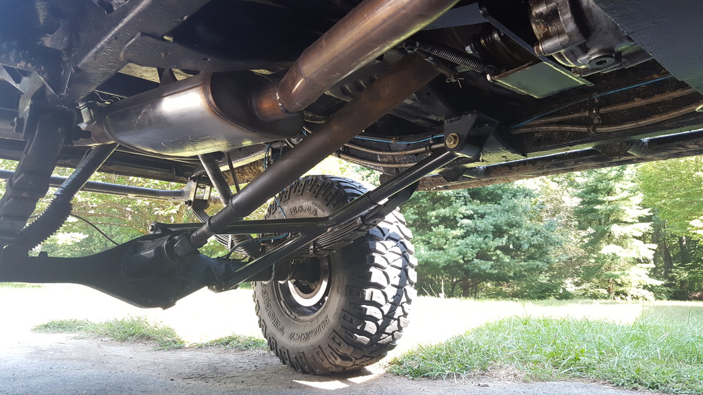

Everything is back on for the most part, Gonna order 1" wheel spacers and a brake booster for a v6 4runner to put on as well. Aside from that I have the high pinion bolted in and I also took the painstaking time to clean,prep,and paint the steering knuckles with some left over POR-15 paint I used on the frame a while back in the initial build.
