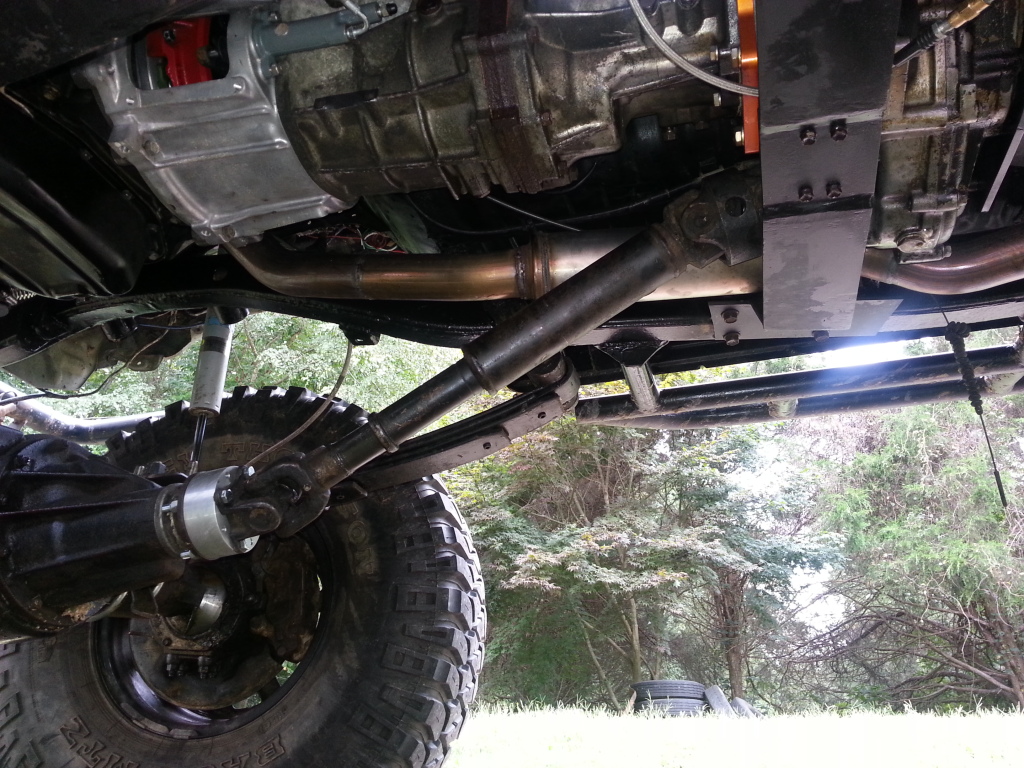

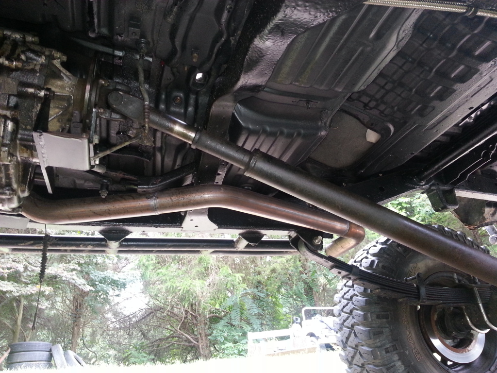

Also captainslow, what did you do for exhaust? I did a straight threw "muffler" right after the turbo and straight piped by the leaf spring.
It sounds like something nasty but it's just too loud. It's not bad just cruising but the sec you punch it's just ridiculously loud lol.

You should throw a video/sound bite of up your exhaust! I'm curious.

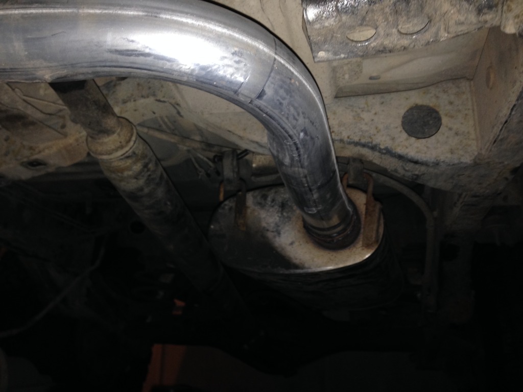

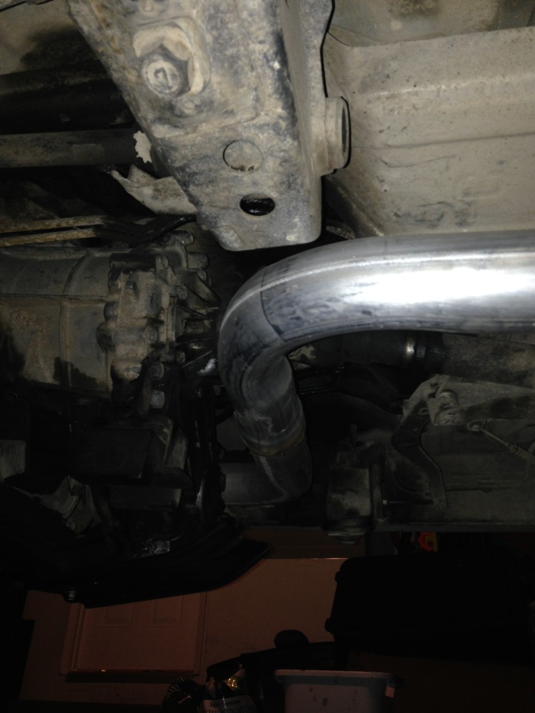

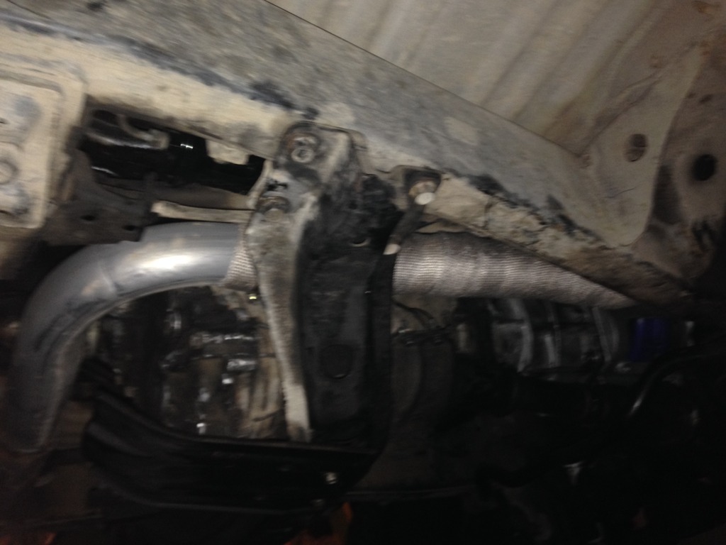

Mine stays up fairly high, makes the turn after the transfer case to the stock muffler location. Its a pretty big magnaflow I got off craigslist for $25 so it's quiet, but then that means you hear the turbos screaming in the cab when you put your foot into it.

Sorry the photos suck, it's dark because I just spent the last daylight hours pulling the gas tank. Walbro 255 goes in tomorrow, hopefully that works out.

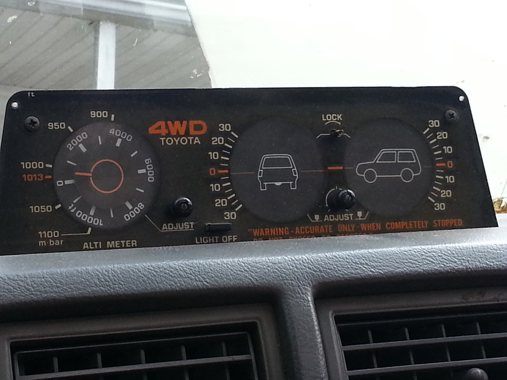

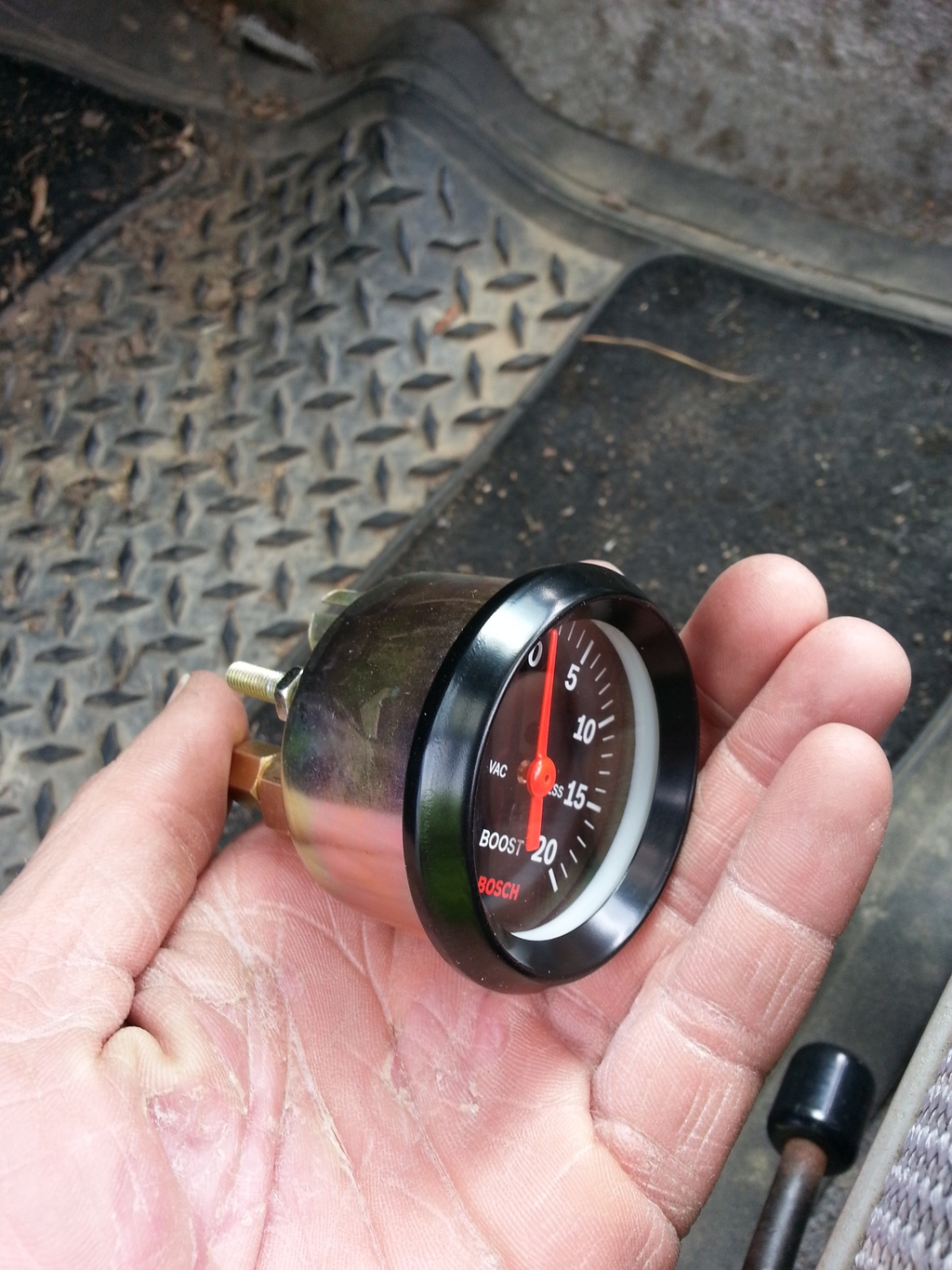

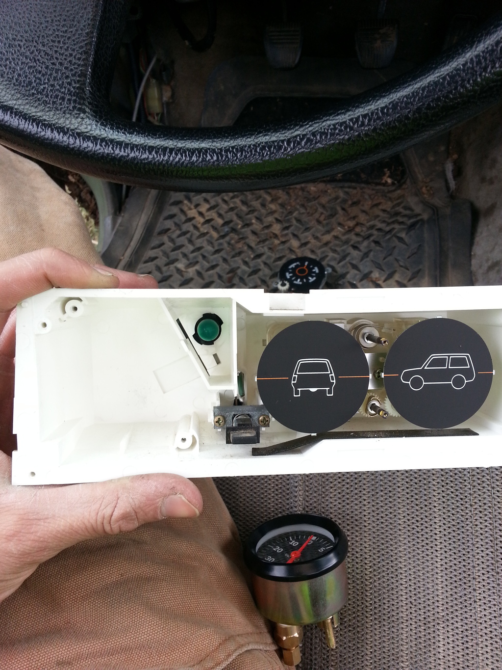

So I finally got around to getting my Boost gauge put in where I want it. It was pretty nice outside so as soon as I got home from work I went straight for my Runner.
Boost gauge is just a regular Bosch but I did do some looking around cause I wanted to make sure the face would fit in place of the altitude meter. Nothing too in depth pretty cut and dry. Although the stock housing did take some modifying, cutting and measuring to make room and to mount it. Here are the pics.

The cutting and drilling is not pictured. I'll put in the truck later this week. I still half to swap the light socket so I can use the factory green light. Run the hose then drill and tap it.

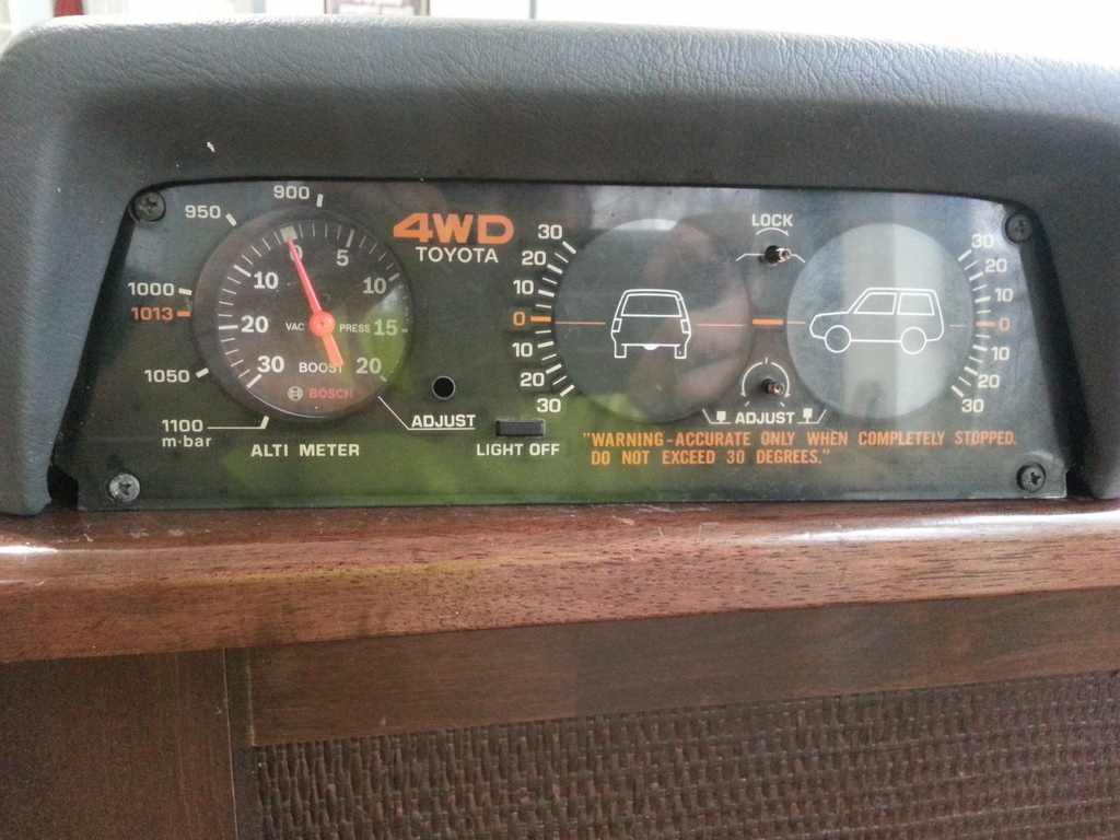

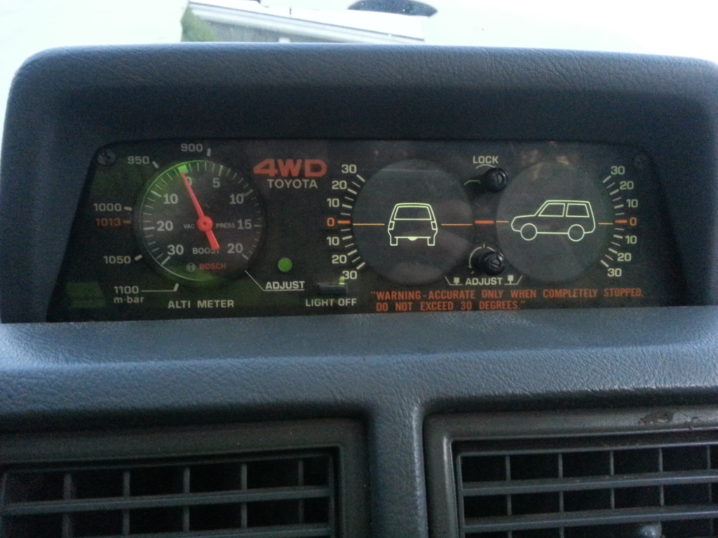

Here is my boost gauge installed in the cluster. Ran the air line through the dash just half to get it through the firewall to the motor.

oh that looks so good! I've thought about doing that with the overhead jdm helix 2nd gen version, but right now by pyrometer and boost gauge replaced the ash tray
I'm curious to see how much boost your making.. where are you going to plumb it off the motor?
