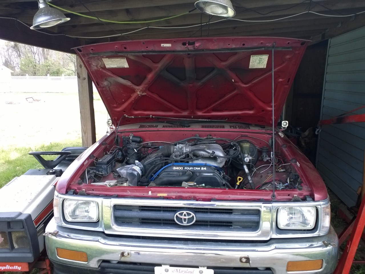

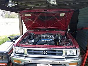

Got the hood bolted back on. lined up perfect the first try.
Feels like I'm working on my truck again, and not just some lawn ornament.

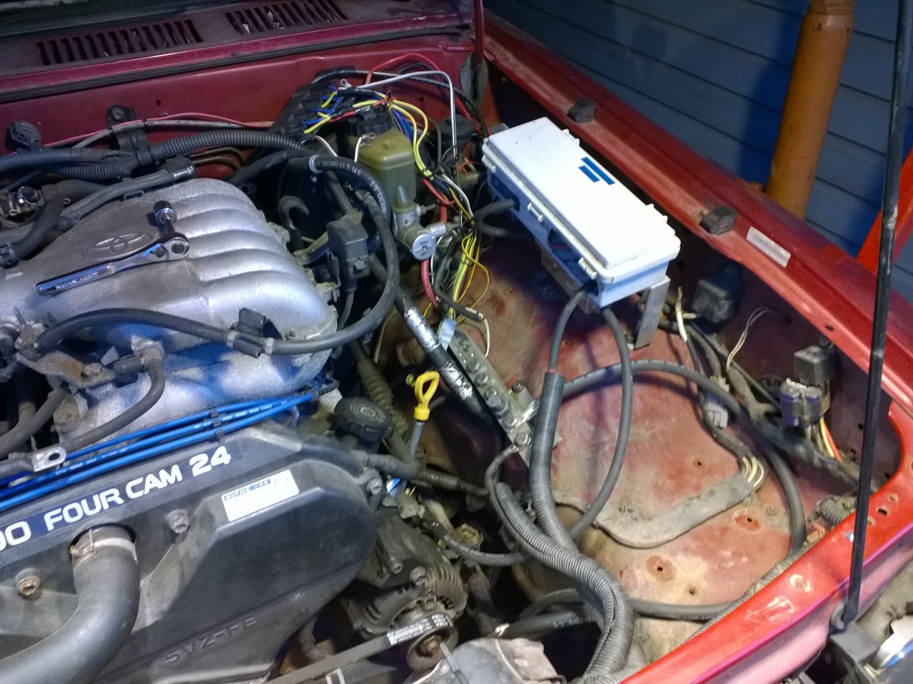

Started making some new bus bars, but my taps are cheap and dull (too dull for even copper)
irab88 adds another liter: 22R-EC to 5VZ-FE-rukpdly.jpg
Old system, slightly modified. I plan on using the 4Runner body fuse box as an accessory fuse box with relays. It's got glue drying right now, I'll try to figure out mounting later.
irab88 adds another liter: 22R-EC to 5VZ-FE-bk2wkoh.jpg
Left to do:
-Exhaust (parts ordered, on the way)
-Driveshaft (found a semi-local company, might not get done for a few weeks)
-Battery mounting (inside the toolbox for now)
-ECU wiring (probably 6 wires)
-Fluids

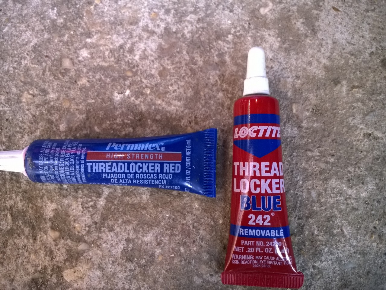

Also...
irab88 adds another liter: 22R-EC to 5VZ-FE-o5zvhoa.jpg

Nice work. It's always bothered me that the blue thread locker is in a red tube and vice versa.

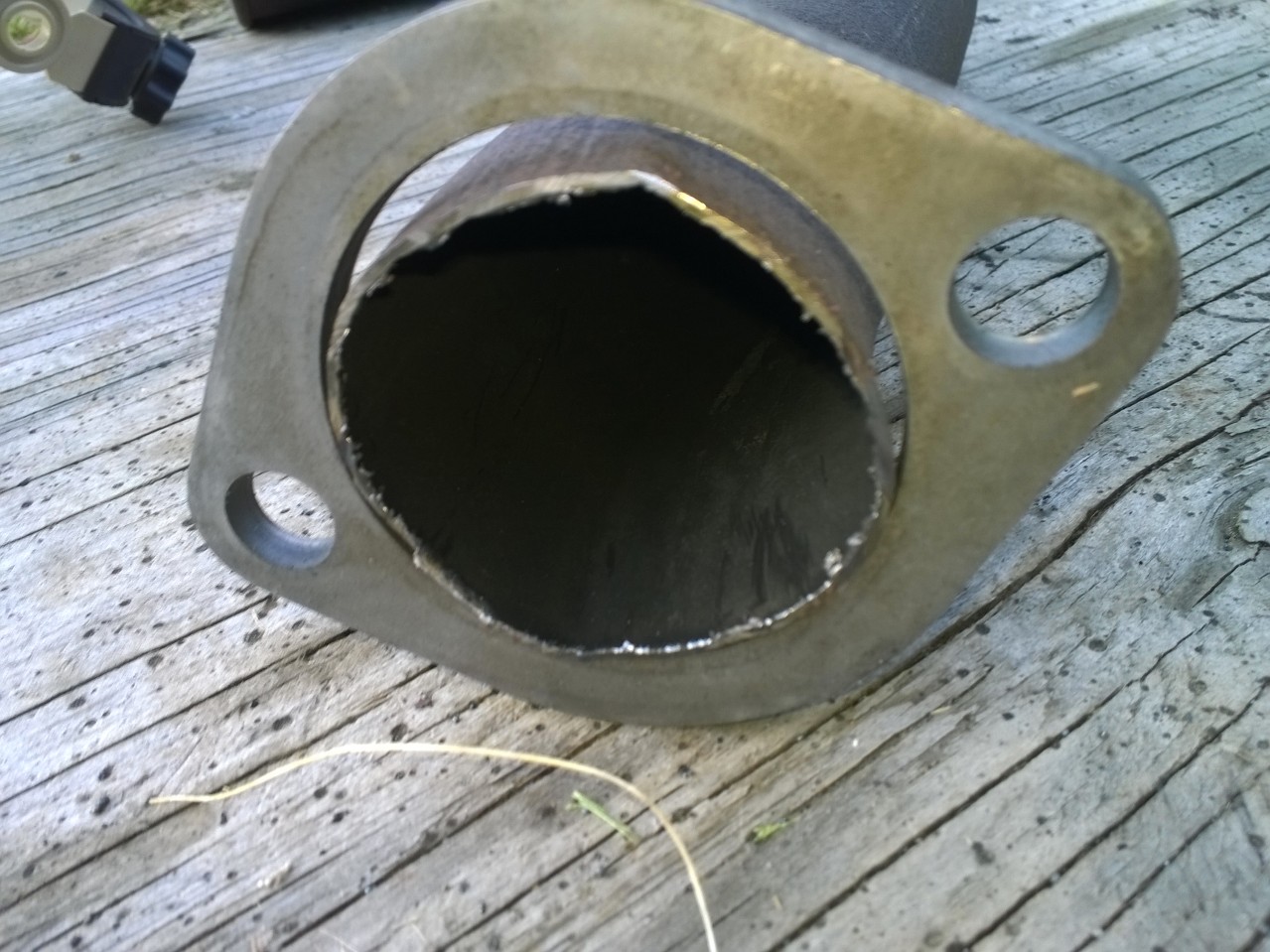

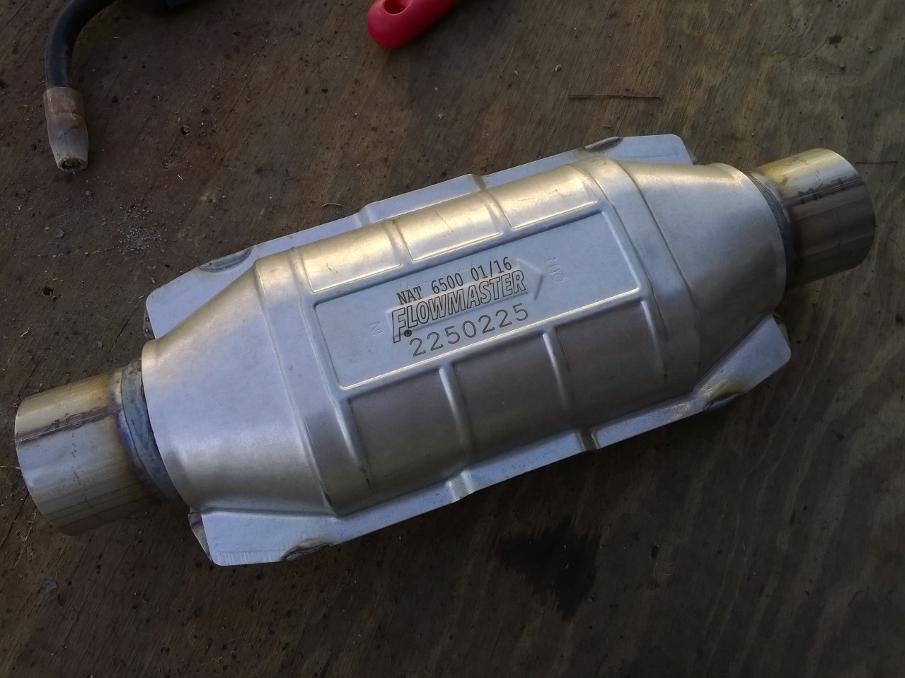

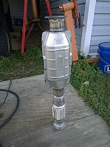

I worked on exhaust this afternoon, since my parts showed up.

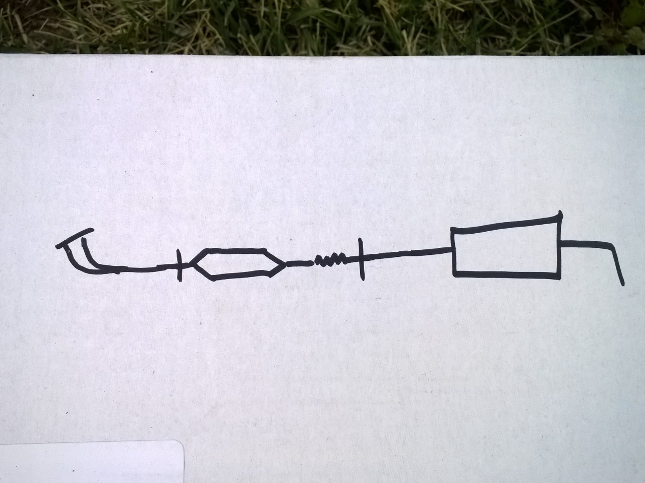

My top of the line exhaust diagram:
irab88 adds another liter: 22R-EC to 5VZ-FE-cexbtto.jpg
(downpipe - flanges - cat - flex - flange - muffler/tailpipe)

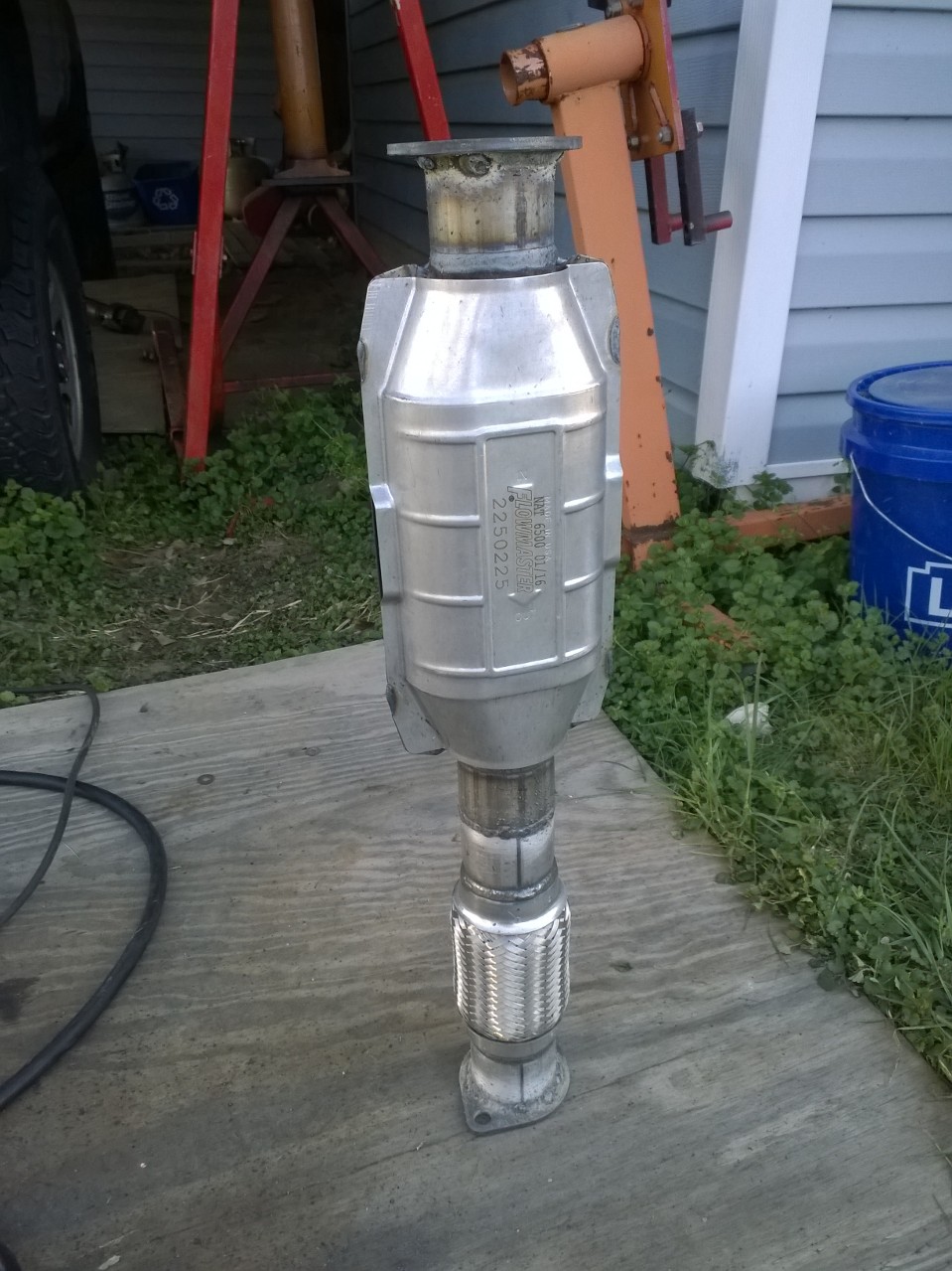

Shiny
irab88 adds another liter: 22R-EC to 5VZ-FE-tdizzx3.jpg
All new parts, welded tight
irab88 adds another liter: 22R-EC to 5VZ-FE-ctpmmzy.jpg

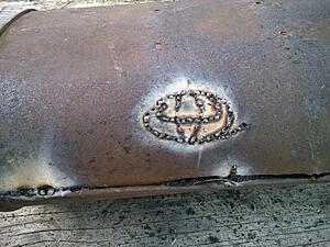

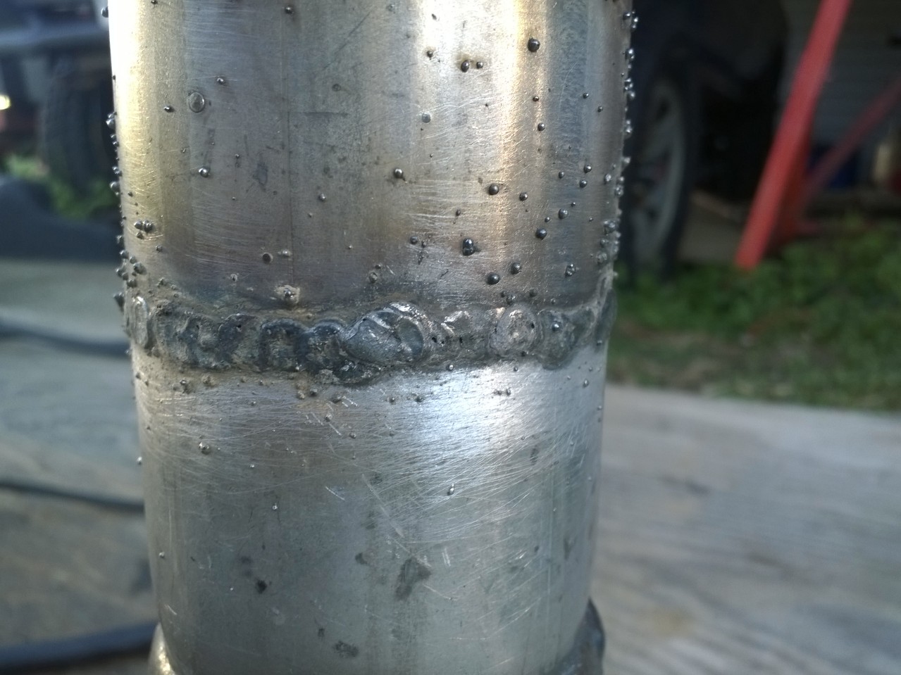

My crap-ish thin-wall welds. Not terrible, I'm getting better though

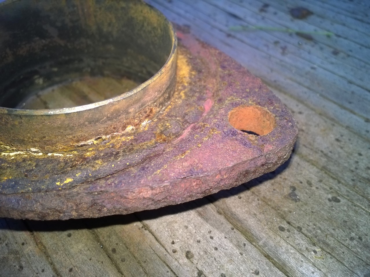

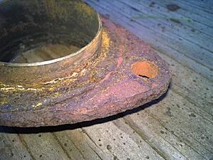

The old flanges look like they came off the Titanic
irab88 adds another liter: 22R-EC to 5VZ-FE-ttve05z.jpg

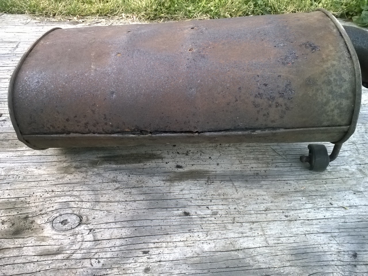

I thought about using the old muffler...
irab88 adds another liter: 22R-EC to 5VZ-FE-wrmhmas.jpg
but...

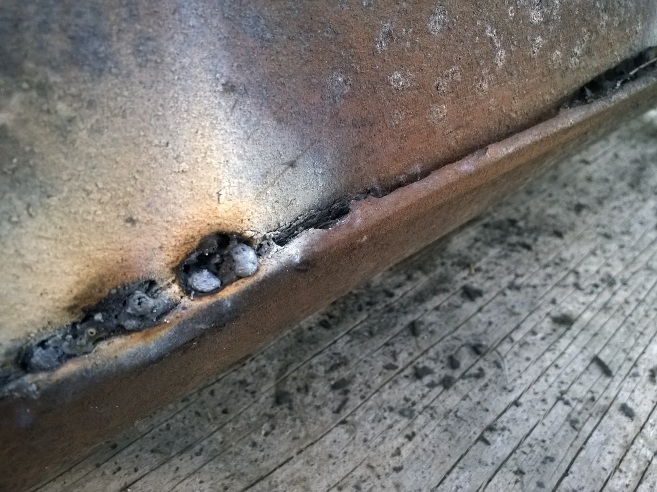

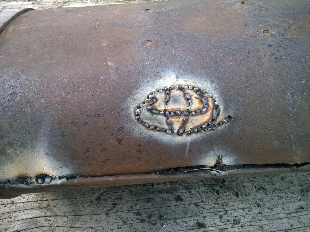

...trying to weld up the seam was more like a plasma torch.
irab88 adds another liter: 22R-EC to 5VZ-FE-tprqm8r.jpg
irab88 adds another liter: 22R-EC to 5VZ-FE-6rfedfj.jpg

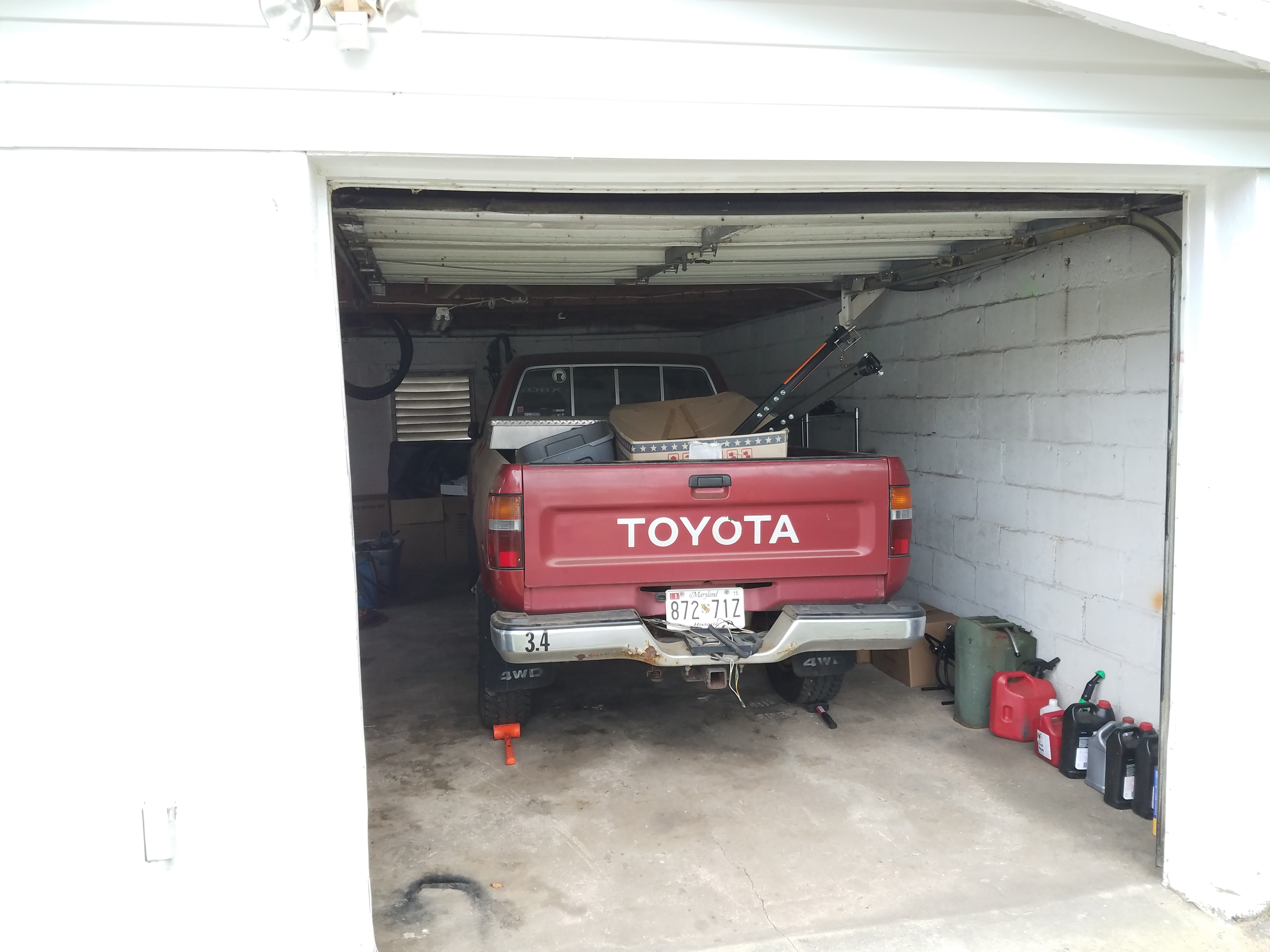

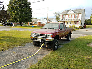

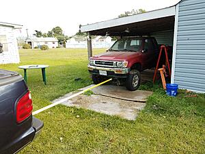

I moved, and took my trucks with me...
irab88 adds another liter: 22R-EC to 5VZ-FE-asatgtq.jpg

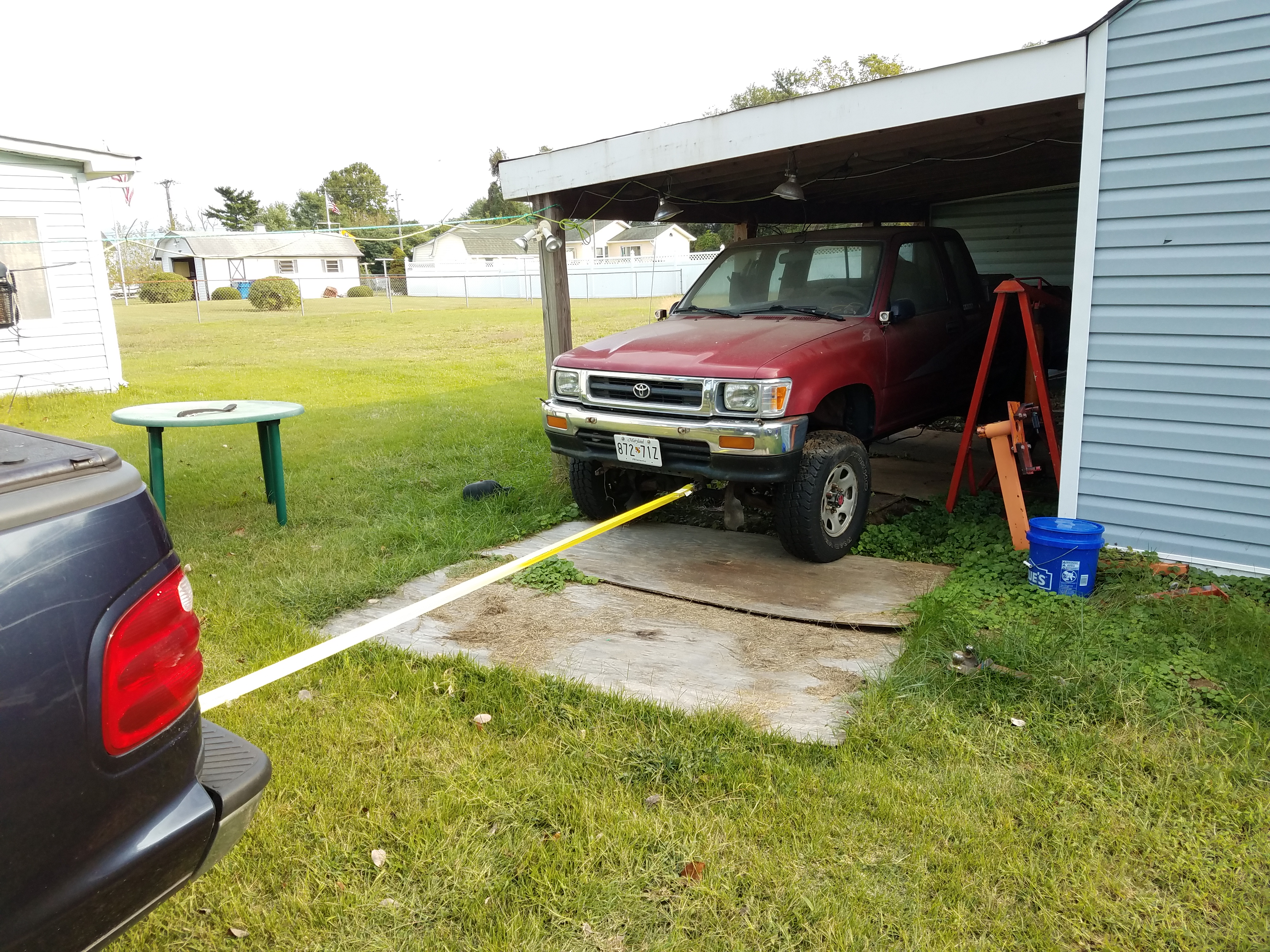

Pulling it out was frustrating, but after a good pull from my dad's truck, it moved for the first time in over two years
irab88 adds another liter: 22R-EC to 5VZ-FE-zf46dwe.jpg

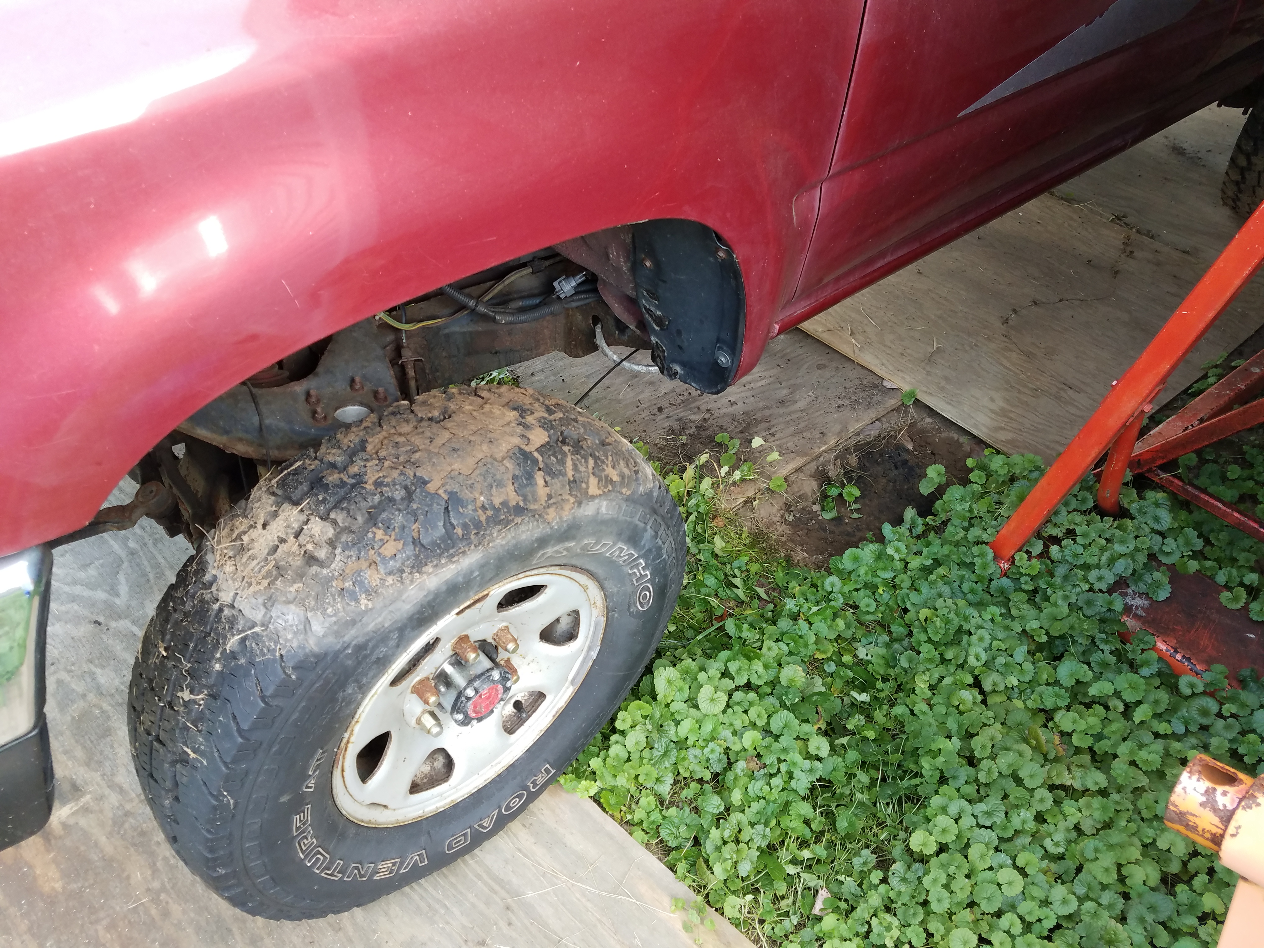

It was at this point that I tried pushing it down my new driveway, into the garage...
irab88 adds another liter: 22R-EC to 5VZ-FE-xexzigo.jpg
...only to realize the parking brake had seized up. A few whacks with a hammer, and she's all in place, ready for more work!
irab88 adds another liter: 22R-EC to 5VZ-FE-84tv36b.jpg
(said hammers as chocks, for now)

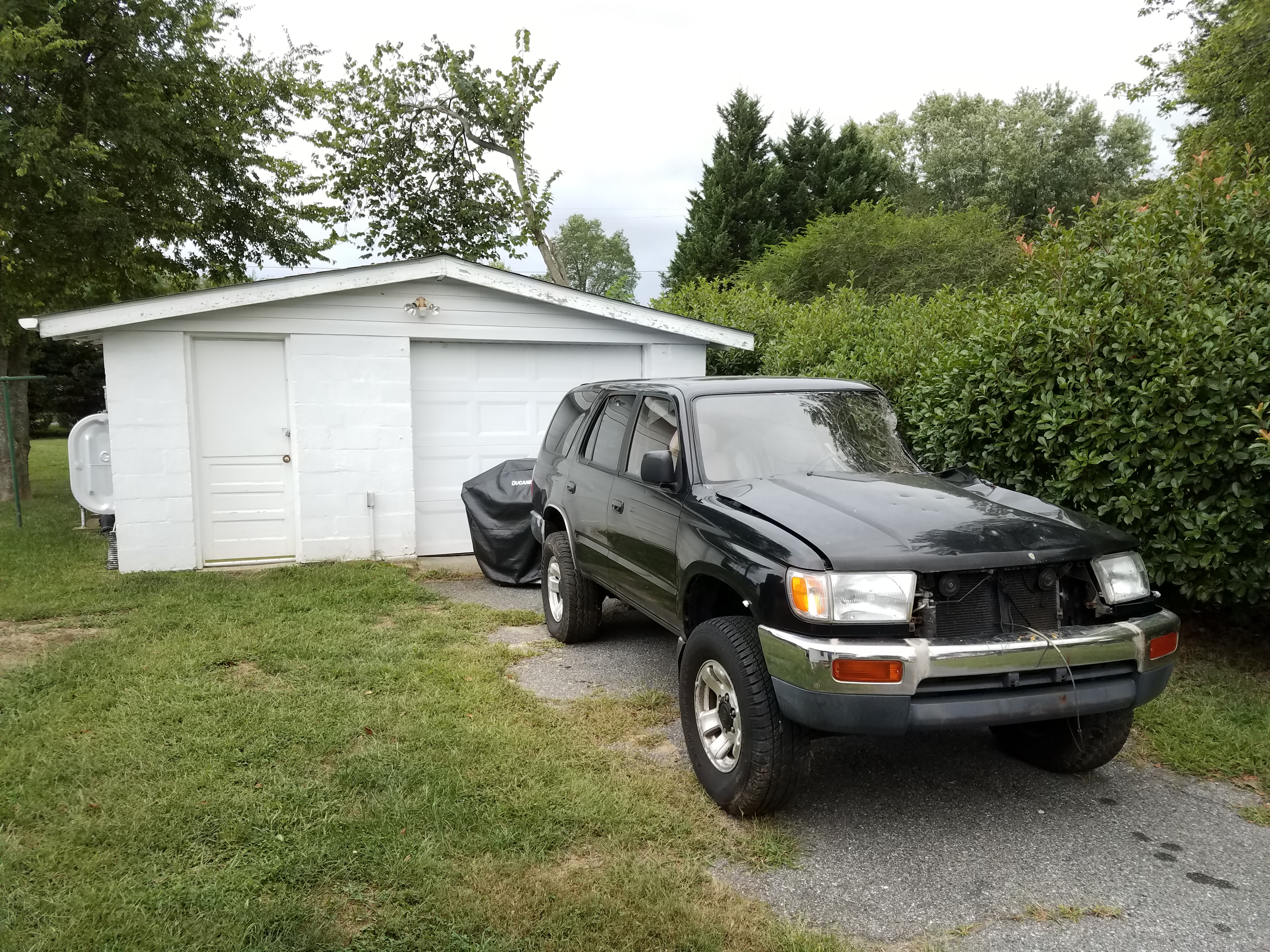

The NoRunner got dragged backwards the whole way, resting just outside the garage.

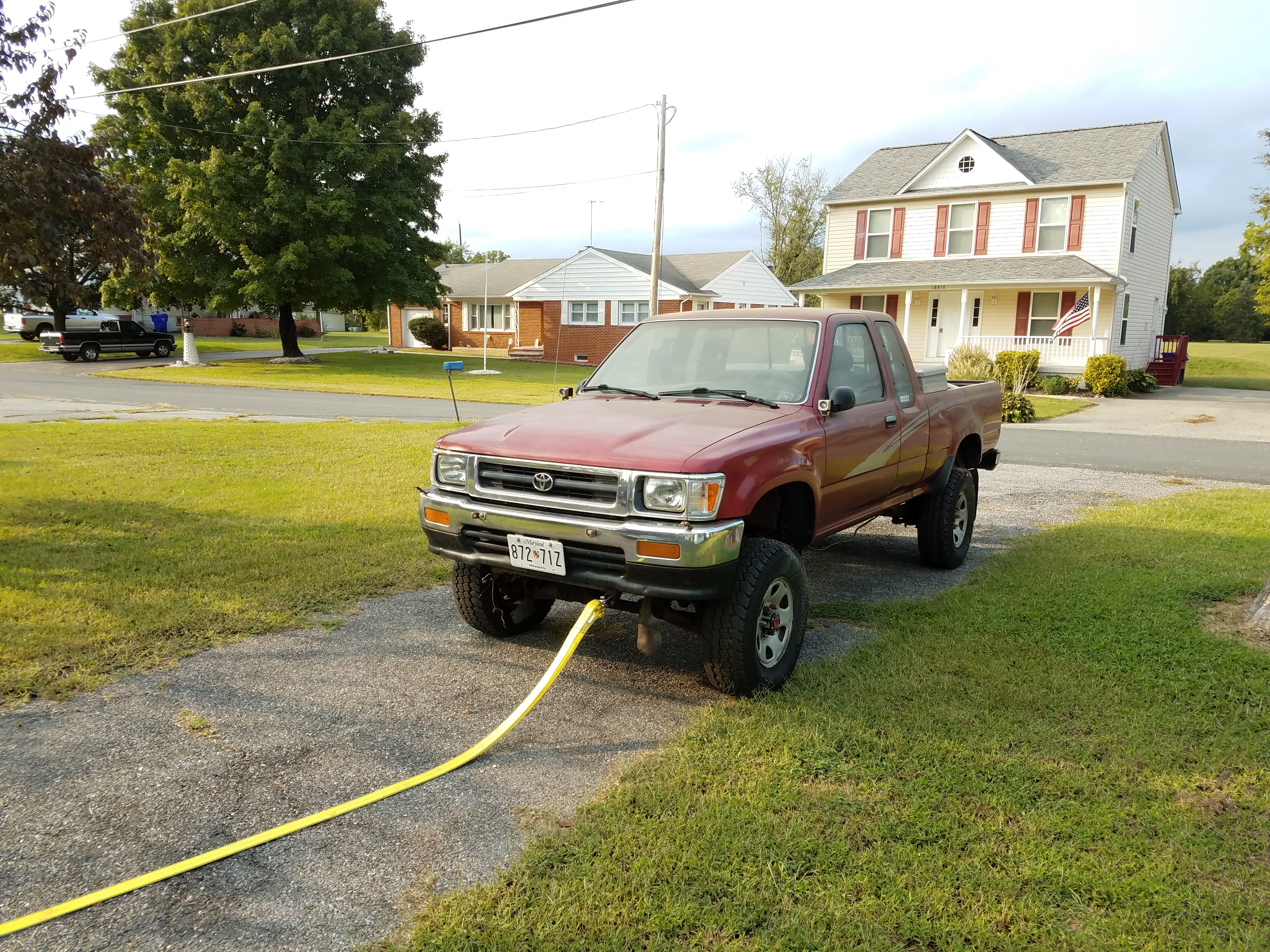

irab88 adds another liter: 22R-EC to 5VZ-FE-mzclfiu.jpg
I moved literally across the street, so I just towed these with my dad's truck the 1/8 of a mile down the road. My girlfriend did a great job of driving slowly, and I sat in the trucks working the steering and brakes. Hopefully the next time the truck moves, it will be under her own power.

By the way I think your exhaust welds came out great.

Thanks. I was in the zone when I did those welds.
