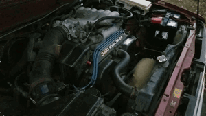

A few pics from last night. I have a meeting at work today, but once I get home... vroom vroom.
Needs to be washed... badly. This is 3.5 years of dust, pollen, and whatever else decided to coat the entire thing.

You know what really helps the engine start? The starter solenoid wire.
This thing, that I neglected to install...
And the obligatory empty garage shot:
After that snafu, it fired right up. The first time, it started smoking. I spilled a bit of oil previously. The second time the power steering pump started squealing for more of that delicious fluid. So now I wait for it to charge up some.
I'm pumped that I might be able to drive this up to my parent's house for thanksgiving.
