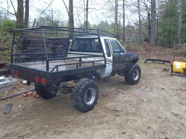

sweet, that'd be awesome! yeah, i'm looking at something like those (really sweet-looking), but i also like bttr's bed (before he rolled it):
and another. i also want to add a bunch of lights of the led-variety

Originally Posted by irab88
snip....
HAHA, this was the exact pic I was going to post in here before as the style I like. However, I'd add low bed sides that hinge down perhaps. just my 2¢

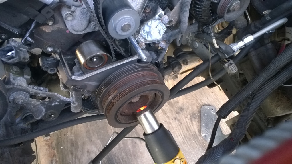

weekend update: timing belt change

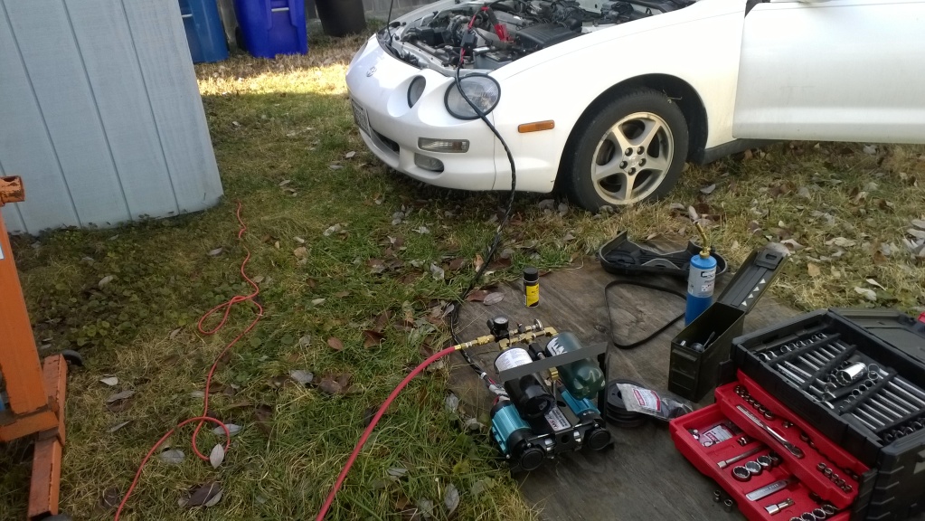

i had to get the crank bolt out, so i pulled out my 12v compressor, heat gun, and torch. the bolt popped right out; easier than the starter trick

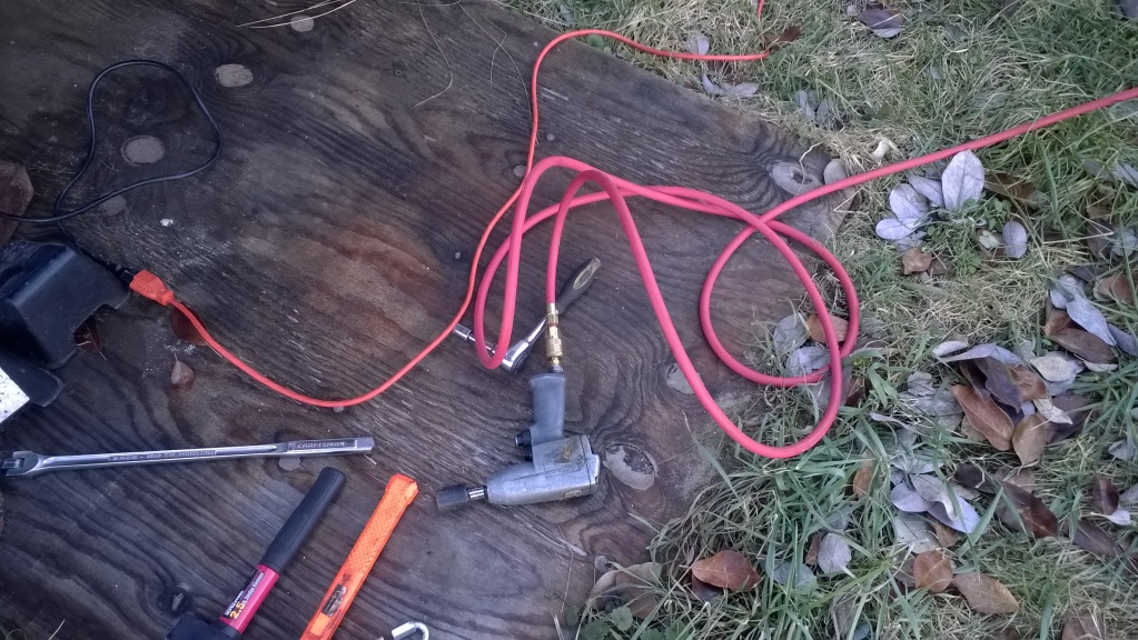

i forgot that i had this laying around, and it worked like a charm

heat gun didn't work, but propane torch for ~2 mins did
