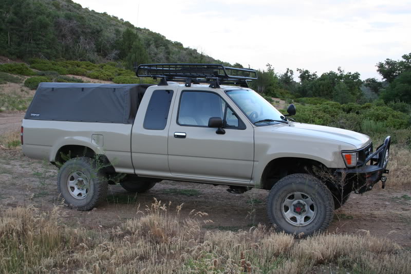

ToyoSpearo:
I'm not gonna lie. I didn't take the time to read this whole thread. But I got to tell you:
That is my most favorite Yota I've ever seen. Hands down.
