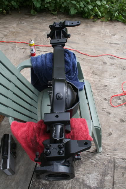

Sweet Jesus! Almost painted! One more coat and that is it
You gotta love my redneck shop- crappy porch chair for my axle stand and other crappy porch chair and 4" x 4" piece of scrap wood for my paint drying room!

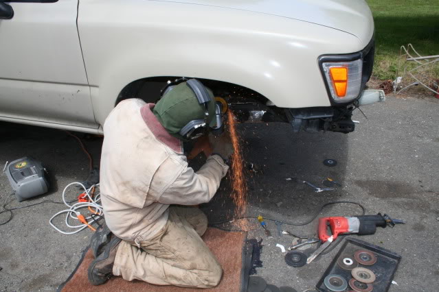

From: way way nor cal
Close, so close
Todays carnage
My Harbor Freight grinder couldn't keep up RIP

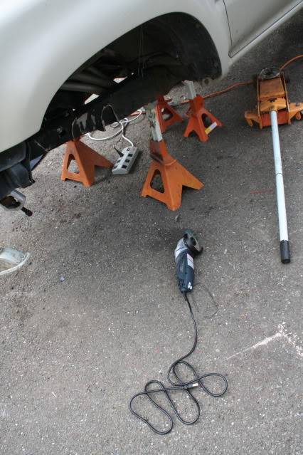

Sawzalled

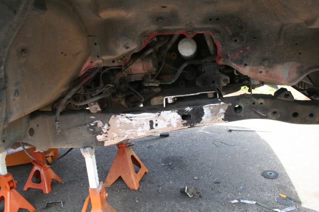

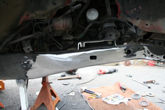

Looks like a grenade went off under my truck
Cut these in all the excitement

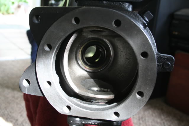

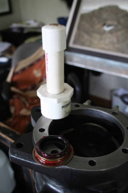

Marlins beefy seals finally showed up. I had to yank the old ones to do some more welding.

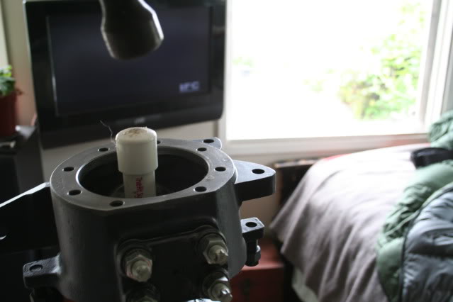

My hillbill seal driver!! The Outlaw Josey Whales on in the background
in and ready
Birfs in and knuckle packed

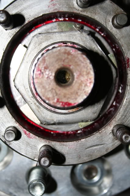

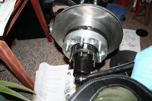

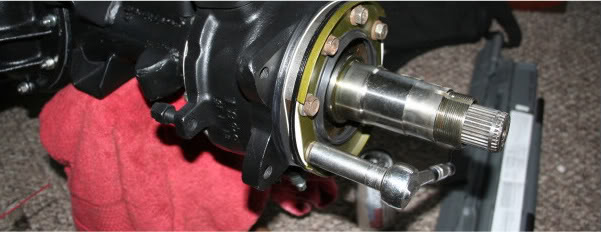

Spindle on and nuts torqued
hub on
Spindle nut torqued

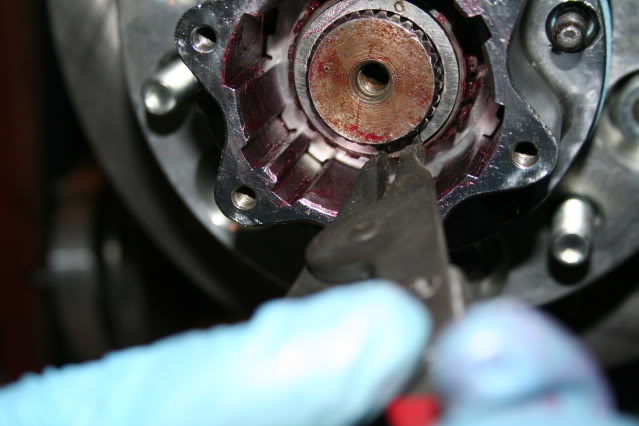

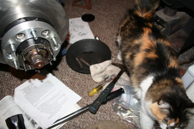

cat came by to make sure I am doing things right

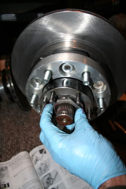

hub on and snap ring in

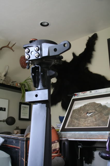

A 1983 complete rebuilt SA, Aussie with 4.88's
Yes that is my living room. I am a TOTAL redneck
