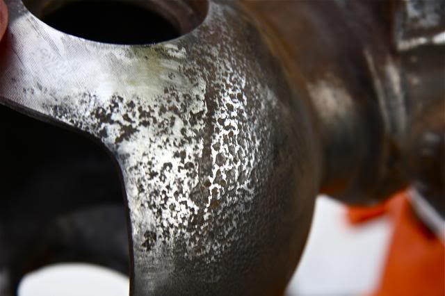

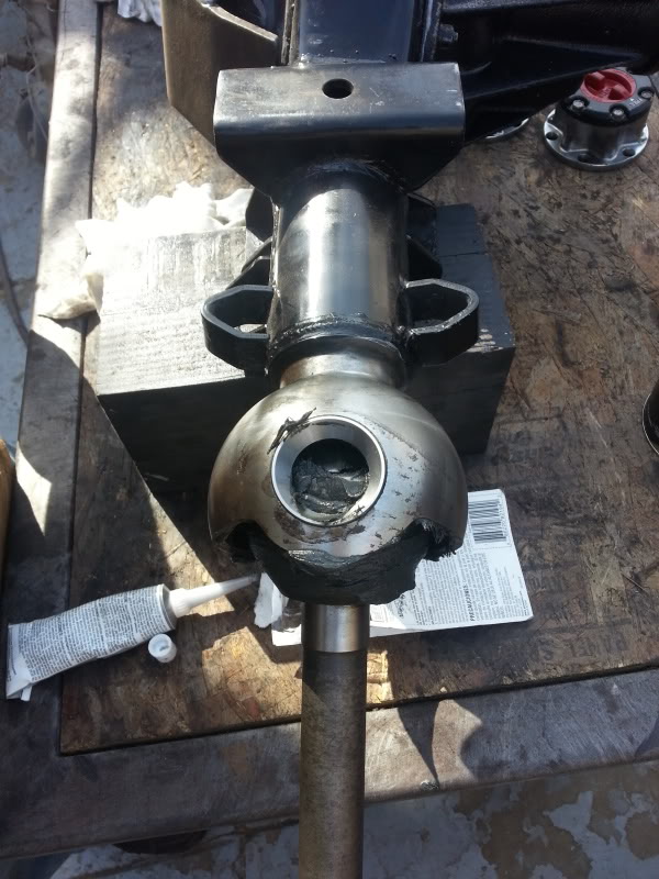

You've may have already answered this but. Do you have to make your own shock mounts or can you use the ones that are already on the axle housing. And my next question, what's the point of the JB weld on the knuckle balls?
I know this ain't my thread but thought I'd give you my 2cents on your question.
I recently did an SAS and I just reused the same shock mounts on my axle housing. But, It is nicer to have the other ones that are included in the sas/ifs eliminator kits instead because they are beefier. More heavy duty(but its not like the stock ones are gonna break on you when you wheel. After all its iust a shock not a leaf spring). At least that's what I concluded when I compare the ones that came in the kit and the ones still on the axle.
Here's mine.
As for the JB weld. Sometimes those ends have a few rust pores when it should be smooth thus explaining the usage of JB weld. (To fill those pores and make it smooth again). I have seen a few pix of some in pretty bad shape with loads of rust pores. I'm sure if that's why he used that method.
Here is one of mine. Nevermind the grease.

Mine were nasty.Name:  IMG_1589_zpsab615d65.jpg

THATS WHERE I SAW IT!!! lol I knew I had seen one in bad condition recently haha Great Technique for whoever thought of doing that lol

Actually I got it from Toyospearo. Look in his, (My SAS Thread).
