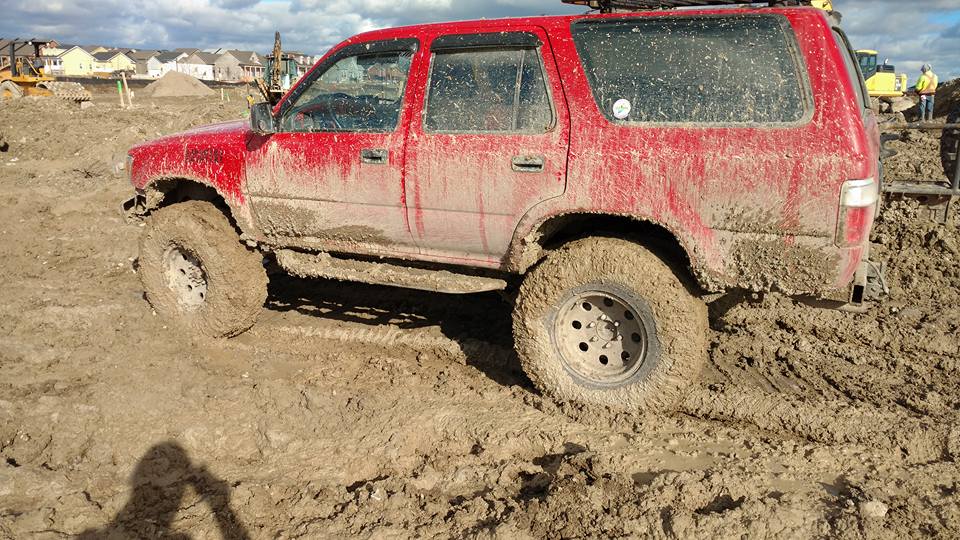

Here is my truck It has BJ spacer coils and 3" body lift currently. I have the SAS kit, front axle, drive shaft kit and was thinking about running rear springs out of a pickup on the front and have seen a few people run the lifted stock rear setup and figured it would be fine. But i am having a hard time finding springs and when the lift kit came the springs look so nice and have the military wrap which the pickup springs don't. So I was just wondering if the rear setup would handle that much lift or should I grab the rear leaf setup as well.

You'll probably find it alot easier to match the lift in the front you get with a 4" SAS if you convert the rear to leafpacks...just not much out there for the rear coils.....different situation if you had a Jeep TJ as they can get the 5" Rubicon coil lifts. Longer coils from a Jeep would not work for you as it's the geometry that gets so far out of sync.
