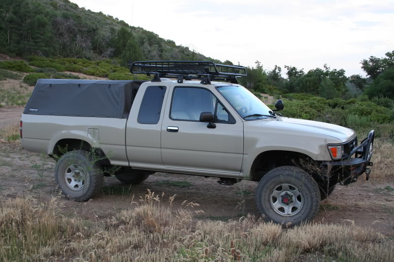

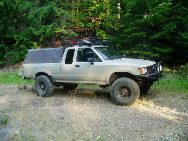

My truck- 1994 22re ext. cab

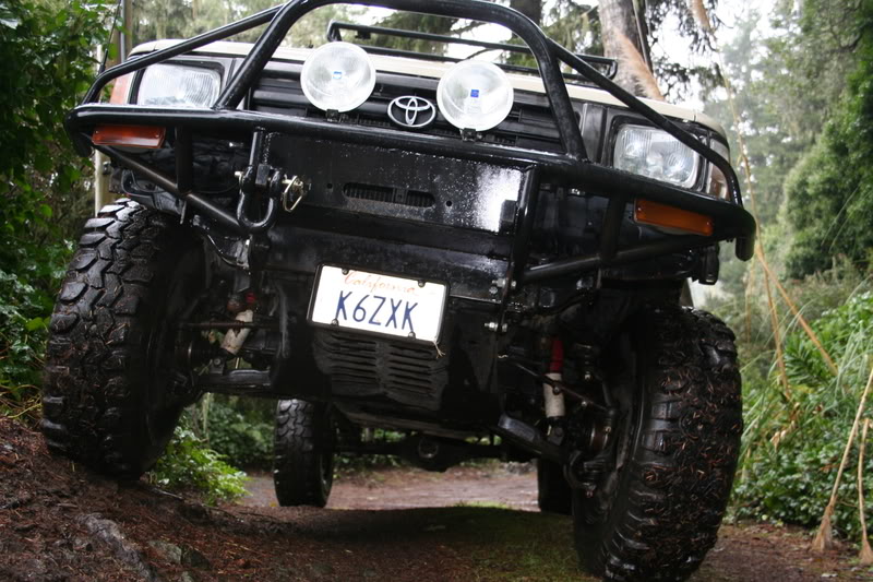

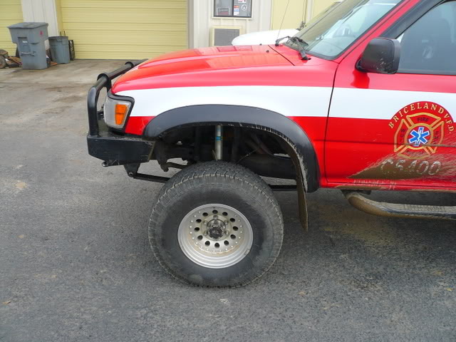

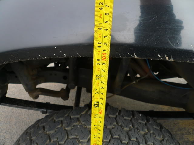

This is the lift height mine will be. This was done similar to what I am doing by Mikes Specialty Repair.

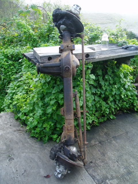

1983 SA I got from Mike at MSR. I beat the brush for an 84 or 85. I found one 85 but the pitting was too much. It is near impossible to find an SA that isn't rusted beyond belief around here. I figured I would be driving 8 hrs north or south to get an 84 or 85 and I decided to settle on the 83.

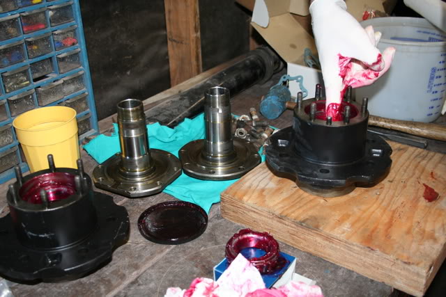

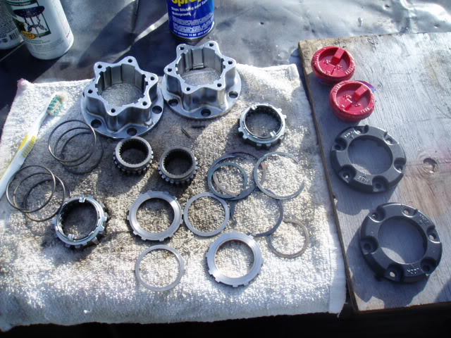

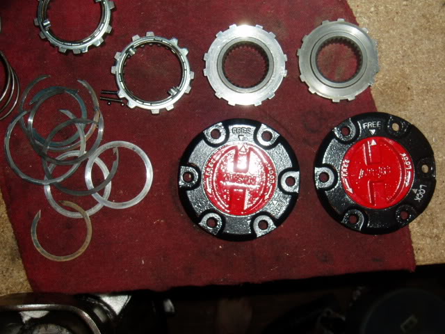

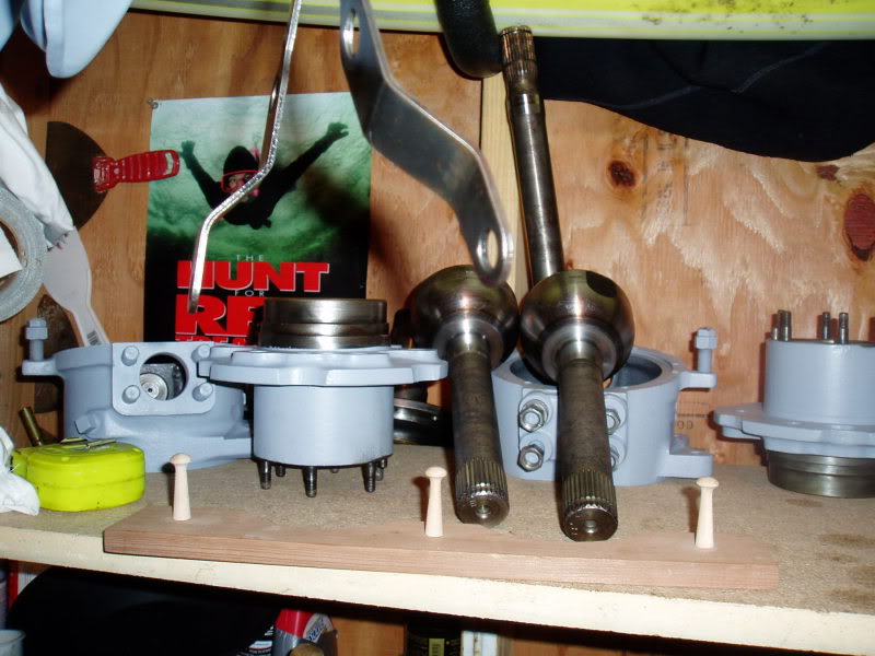

Hubs rebuilt, powder coated, and cleaned

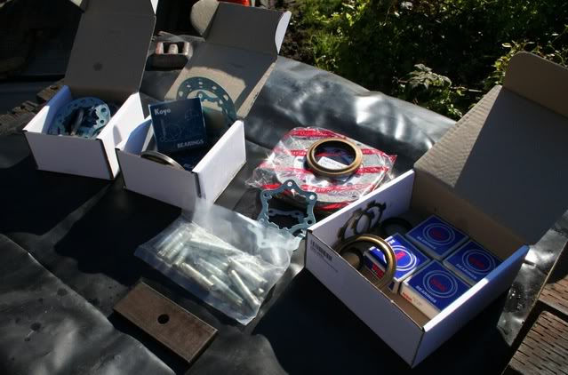

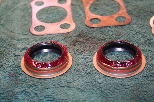

Big Brown payed me a visit. Axle armor, gussets, knuckle rebuild kit, seals, Diff drain plugs etc.. Thanks WABFAB, Thanks Marlin!

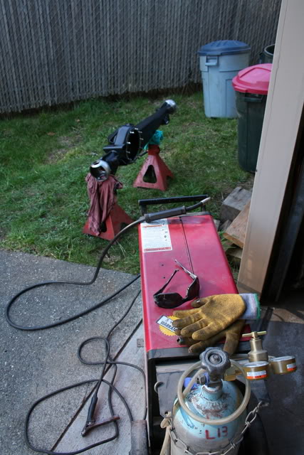

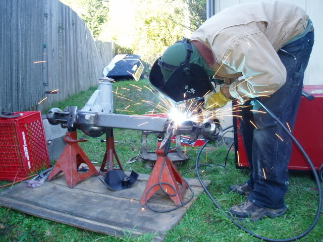

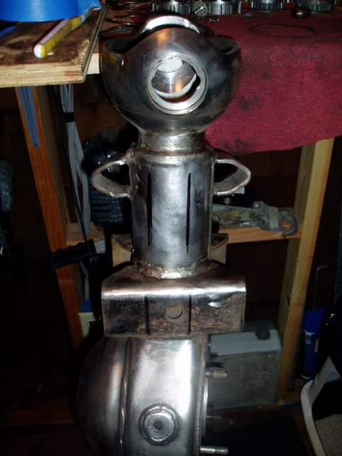

Welding! the 3rd on the SA while welding and no seals

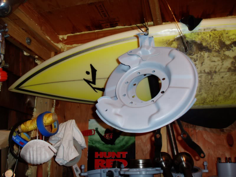

Axle parts sanded, blasted, grinded and primered!
Axle welded

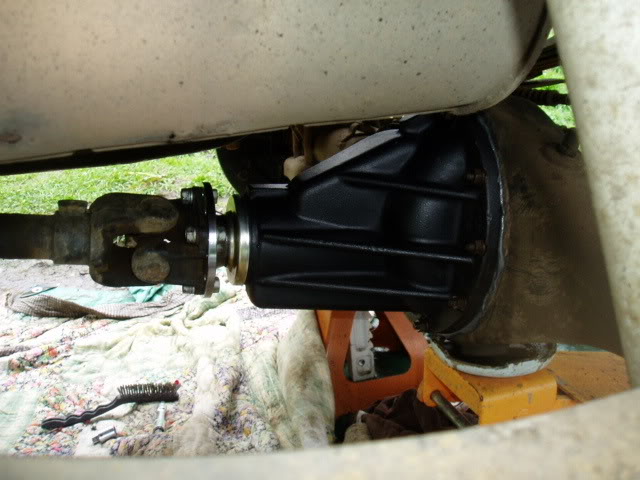

Big Brown came buy this week.. aaaaahhhhhh yea!!! Mike Specialty Repair did the Aussie install and 4.88 regear.

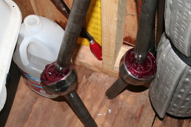

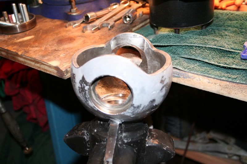

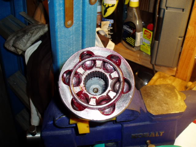

Knuckle ball JB welding trick. Thanks 4Crawler!!! So Smoooooooth!

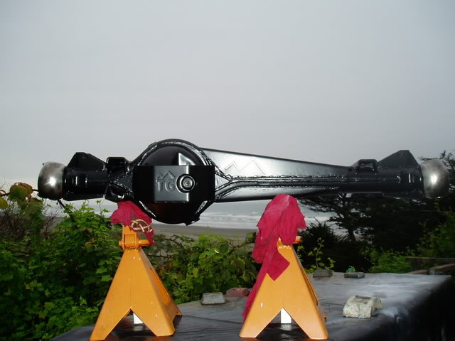

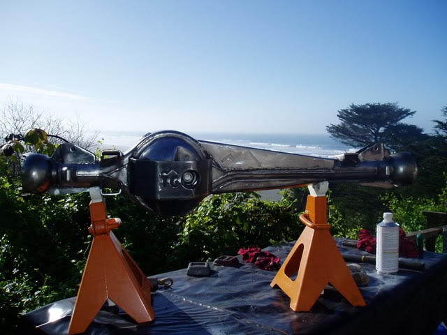

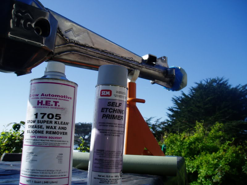

Axle welded up, wire wheeled, sanded and ready for primer

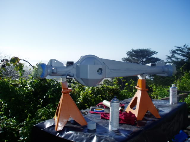

and primered..
and painted.

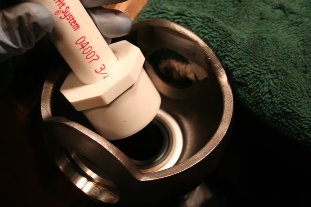

Marlin's seals greased up and ready to be driven in with my redneck PVC seal driver lol
Birfs locked and loaded..

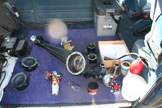

My goodies loaded up in my new "cough" VW van on the way to my buddies house. He is an x toyota mechanic who is going to make sure I get the knuckles dialed in. People around here consider him "the guru of Toyotas." Note the fire extinguisher close buy and the purple shag carpet, oh, and the WABFAB sticker

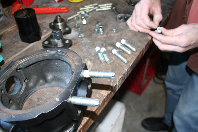

more fun today.

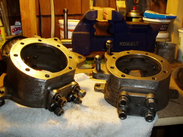

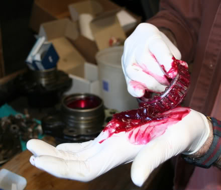

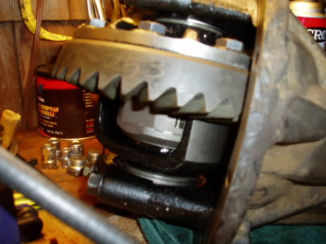

Knuckle rebuild, packing bearings and races..
New knuckle studs wrapped with teflon (just in case )

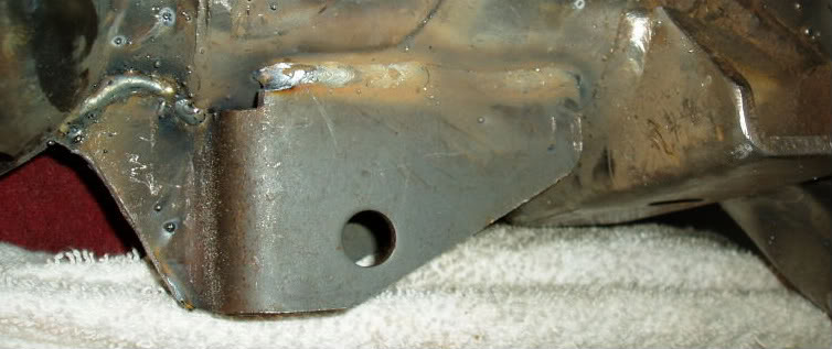

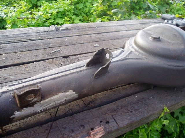

Welded on the leaf bracket..

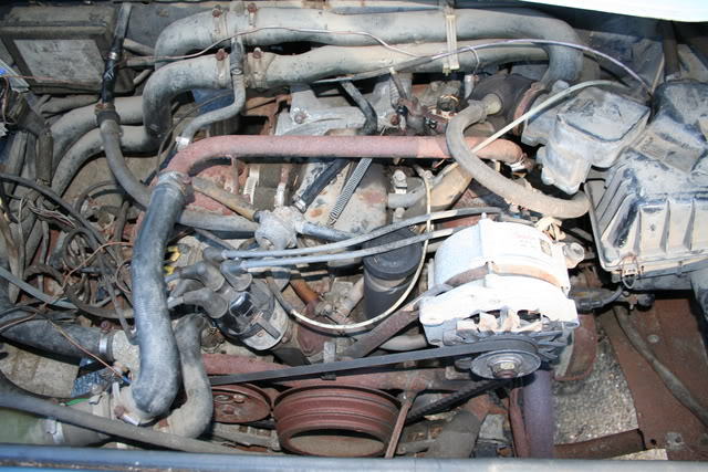

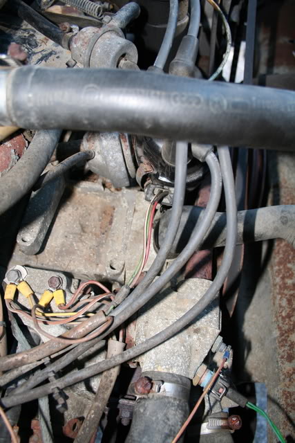

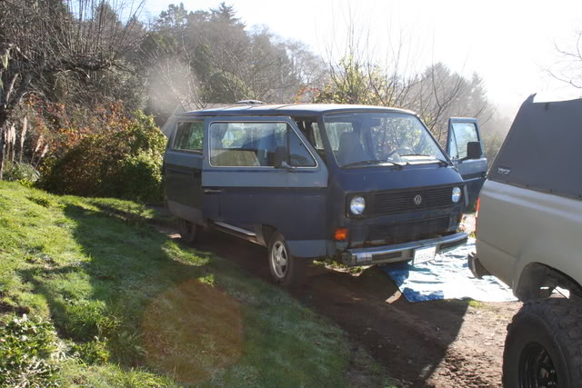

Annnnnnnnnnd.... the vultures started to circle over my VW VAN. Which is now running....
The middle of the pic is the damn wire that was corroded and left me stranded Holy crap what an ugly motor..

You should put a drop or two of red loc-tite on your knuckle studs, not teflon tape.
Also no need to do anything but lightly grease things, then once all that is on the axle you can just pump 1/2 tube of grease into the knuckle via the grease plug and make less mess.
Old 01-19-2009, 04:30 PM
toyospearo's Avatar
Join Date: May 2008
Location: way way nor cal
Posts: 3,274
Received 21 Likes on 18 Posts
Thanks! I was kinda following the FSM on greasing the bearings but I think you are right about just packing it in there after its together.
As far as the teflon tape that was an idea from a friend of mine who use rebuild these axles long ago.
