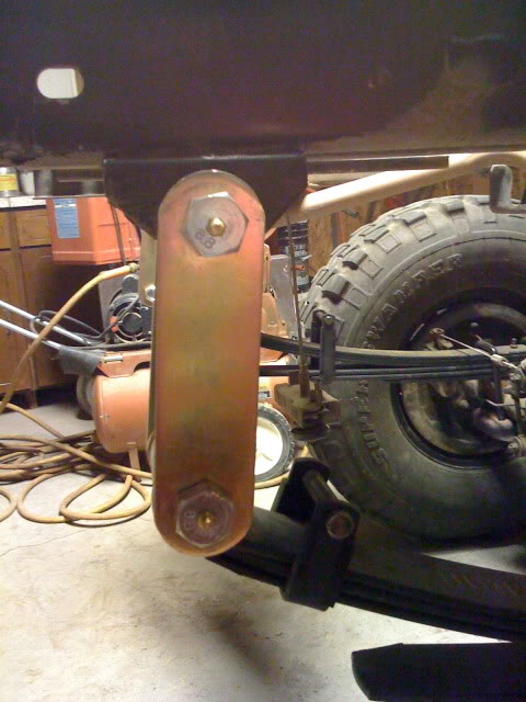

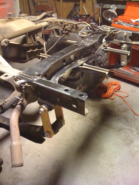

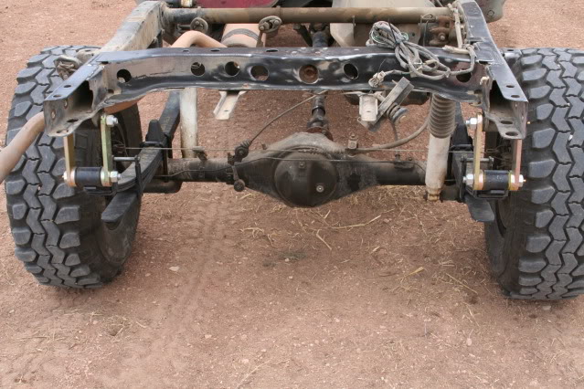

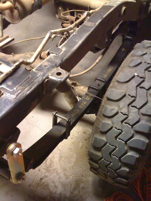

Tonight's progress.
Got the Old Man Emu leafs and TG shackles installed (by myself). I only had one set of jack stands and they were the dinky ones. I used those on the axle housing. I had to use a long 4" x 4" on the rear of the truck with my one ton jack to get it high enough to slip the new leafs in. It was kinda wobbly to say the least. What a PITA.
It added 4" overall and leveled the truck out perfectly!
I will sleep very little tonight knowing in the morning the thing WILL be wheeling!!!
bump stops are going in in the morning. I had to replace one of them,,

It made a WORLD of difference taking the bed off. I don't think there was any way I could have swapped these leafs by myself without taking the bed off.
Every time I have to opportunity to lightly wire wheel the dirt and grease I do it. Then I can put a coat of paint on it. Living by the ocean is brutal on metal.

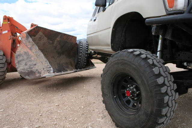

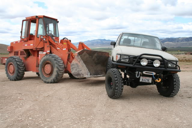

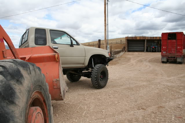

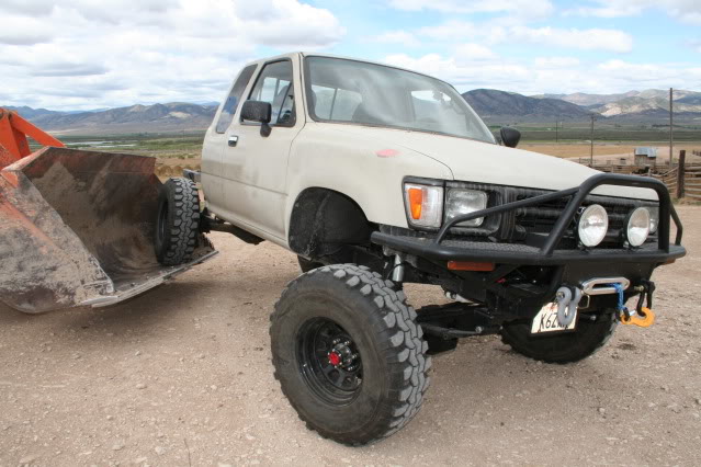

I had to move cows today so I didn't get up in the mountains but I did get to flex the thing out..
One interesting thing about the rear being done and the bed being off is I am certain I seriously damaged my kindeys from all the bounce
I need to throw a few rocks on the rear to calm it down a little.
What better way to lift the rear than with the front loader!

Jamie (one of our ranch hands) came out to see what the hell was going on. He is a Ford guy, he doesnt understand. lol

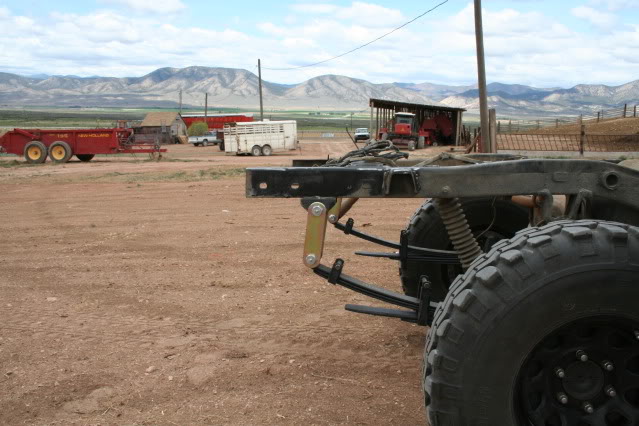

shackle angle looking good.

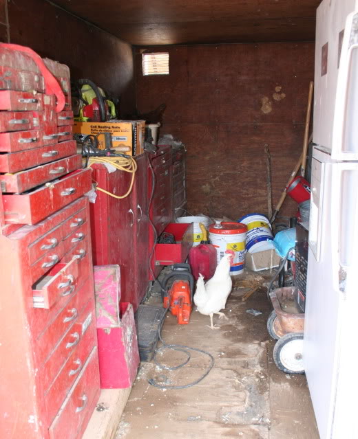

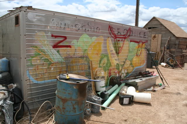

my shop on the ranch..
I share with the chickens

Thats a pretty vertical angle granted you do have the heavy bed off. Ide watch out for the shackles reversing after a big flex. seen it happen to a few people.. if you moved the hanger forward on the frame a bit youd get some extra downtravel too. wouldnt be a bad idea before making the flatbed.
