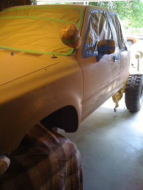

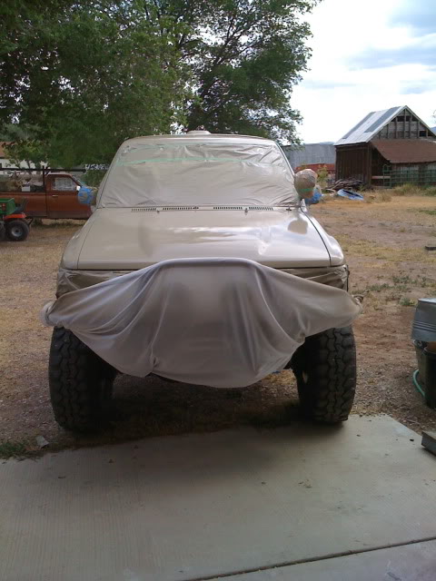

I just got done painting the thing..
done !
same color but more even and I fixed a few dings

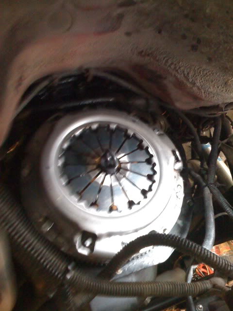

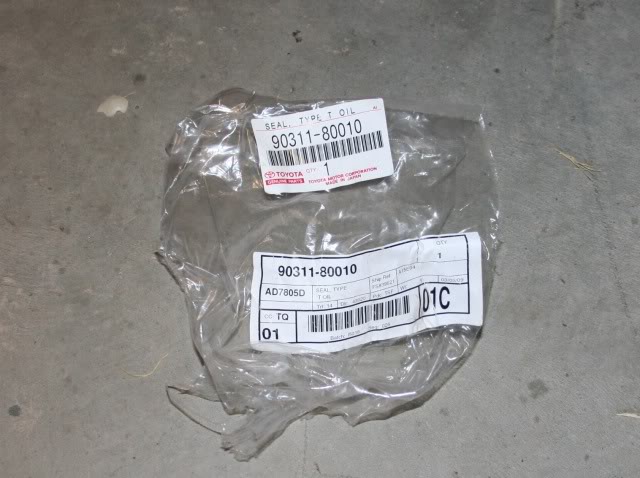

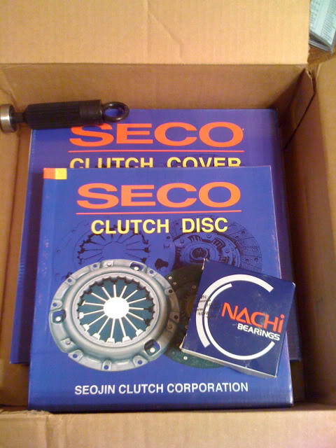

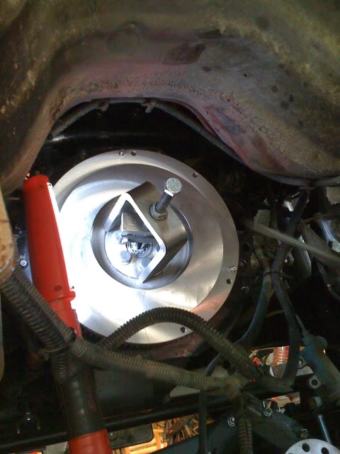

NEW CLUTCH
I hotspotted my old flywheel way back from having too big of tires and stock gearing. I locked the rear and re geared to 4.88 and desperately needed a new clutch. I decided while the paint was drying and we are cutting hay to spend the wee hours gitn er done!
I installed a Marlin Super HD clutch kit 1200lbs and had the flywheel resurfaced put in a new main seal and tranny seal and cleaned things up a bit.
I had the tranny out in 2 hours and went to put in the new clutch and LOW and BEHOLD Marlin sent me the wrong clutch. This was Friday at 5pm Guess what, Marlin is closed all weekend Soooooooo I had to wait unitl monday morning
They were totally cool about it, sent the right one overnight and even sent me a smorgasbord of stickers
I had a terrible time getting out the bearing. I had to go borrow a puller. Finally I got it out. The rest went in no problem. NOW the only hinge is I had to replace 2 LED's in my dash (which is torn from hell to breakfast) and they are coming from MO
They better be here tomorrow
I got a few PM's to post up the clutch job pics.
Below are a few pics of the fun

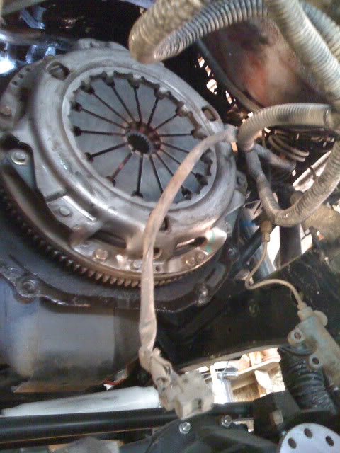

any time that thing is laying on the ground you know you got issues

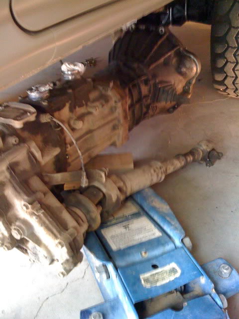

tranny out PITA
old clutch
New flywheel and old bearing! Yea, I know..don't ask.
new clutch!!
new OEM seal!
