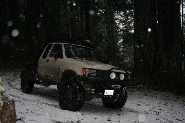

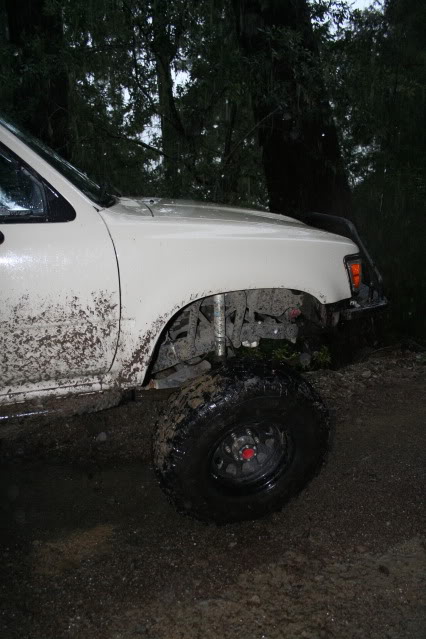

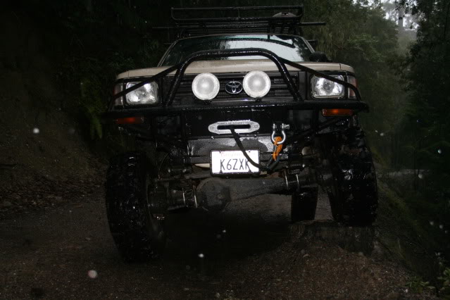

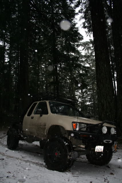

Did a little wheeling today. It was cold and started to snow so I didn't take too many pictures. But here area few..
