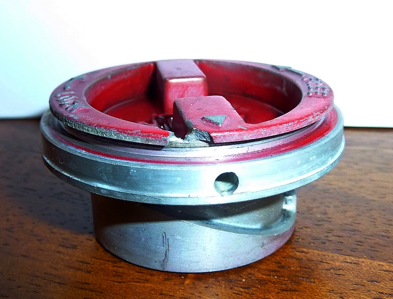

Hey all, I have a quick question. I am rebuilding a pair of hubs I got, and during the cleaning process, I noticed that there is a small chunk of one of the dials missing right at the edge. This hub was a LOT dirtier on the inside than the other and I wonder if this break was allowing dirt in past the o-ring. What do y'all think? Should I replace the dial?

If you are so inclined, you might try some of metal putty (epoxy) and fill in the broken area (clean the surfaces well to ensure no grease or oil) and then sand/file the cured putty to shape and then repaint. Not really a structural area there. Or get a used one and keep that one for a spare.

Thanks for the quick reply! I think I am inclined to use it as a spare since my sculpting skills aren't my strong point. LOL I have to buy some gaskets and o-rings anyway, so I'll just pick up a used, but whole one.
