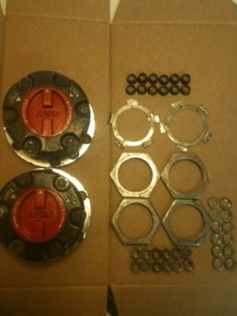

Converting Automatic Hubs to manual
Originally Posted by TRDevelopment
I read the whole thread and couldn't find what I was looking for. I have Aisin auto hubs and I just acquired a set of manual hub dial,spring,hub gear. My question is can you convert an Aisin auto hub housing to a manual using the manual hub dial?
So TRDevelopment got an answer of "no" for this question. I am going to ask the same question. I have the automatic hubs (not the ADD system) I think they are great, best of both worlds, except I now have one that isn't disengaging all the way. Can I convert these to manual using the right parts? And what parts would that be?
I have a picture of a set I can get off CL, is this what I need?
Old Feb 10, 2013 | 08:42 PM
  #145
4Crawler's Avatar
iTrader: (3)
Joined: Jun 2002
Posts: 10,822
Likes: 34
From: SF Bay Area, CA
If those are off an IFS truck (27 spline), then should be good to go:
- http://www.4x4wire.com/toyota/tech/autohub/
If they are 30-spline (solid axle) hubs, then they would not directly swap.

They are from an IFS, thanks for the fast reply
So do I have to take out the little brake assembly and replace it with those hub rings?
Old Feb 10, 2013 | 08:54 PM
  #147
4Crawler's Avatar
iTrader: (3)
Joined: Jun 2002
Posts: 10,822
Likes: 34
Never touched a set of auto hubs, but you basically want to get down to a bare stub axle and the bare end of the spindle. Inner part of hub slides on and then either a snap ring or a bolt hold the hub body onto the end of the stub axle. Then bolt the outer actuator part over the end and that is it. The writeup posted above should cover all the steps with photos and description. I don't think you keep much (if anything) from the auto hubs.

Yeah, thanks for the link to the write up. That's what I needed.
