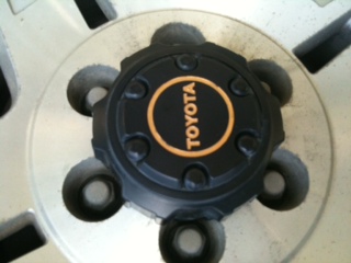

Bought a set for my truck a while back... finally started the rebuild today, and noticed the have different parts..
Pic on the left is the parts in question.
Pic on the right shows where the go in they assembly.
Has anyone seen this before? Do I need a new hub now?

sorry.. I don't a pic at the moment.. they're both dismantled. I'll try to get one tomorrow.
But after a thorough inspection, I'm 99% sure the other parts are all the same. That was the only different part, and it seems to fit in there fine. It was the first one I pulled apart and I didn't think anything of it until I pull the second one apart.
Think I should just assemble it and see if it works?

Thumbs up
Cool. Thanks for all the info.
I painted and assembled them today and everything went together perfect. That different part fits just as snug as the toyota part, and seems just fine.
I didn't like the black/red... so I went with the LC look in black/gold.

Got them bolted on the truck and even painted the rear center caps to match..
Thanks for the help Wabbit! I'll let you know if that oddball part gives me any grief, but I don't think it will...
