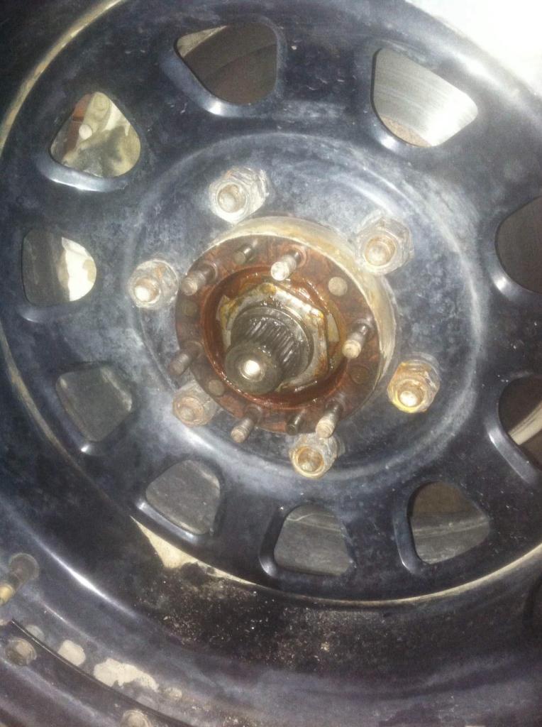

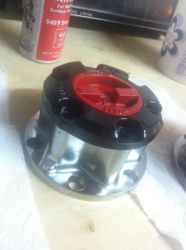

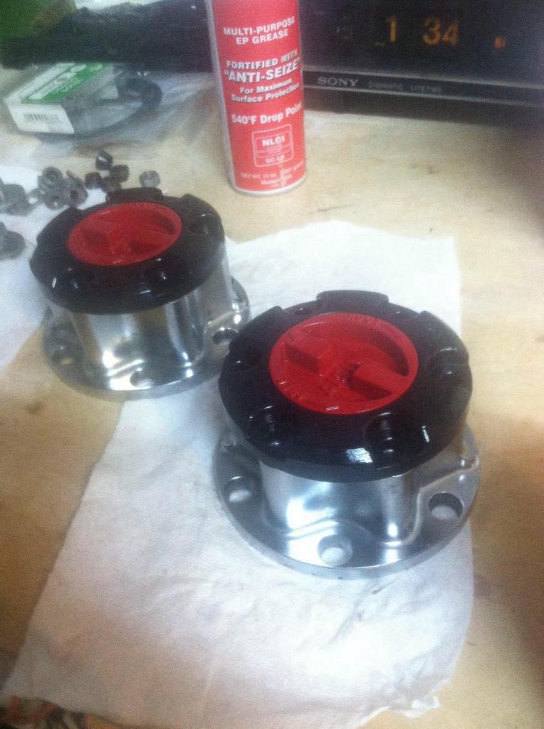

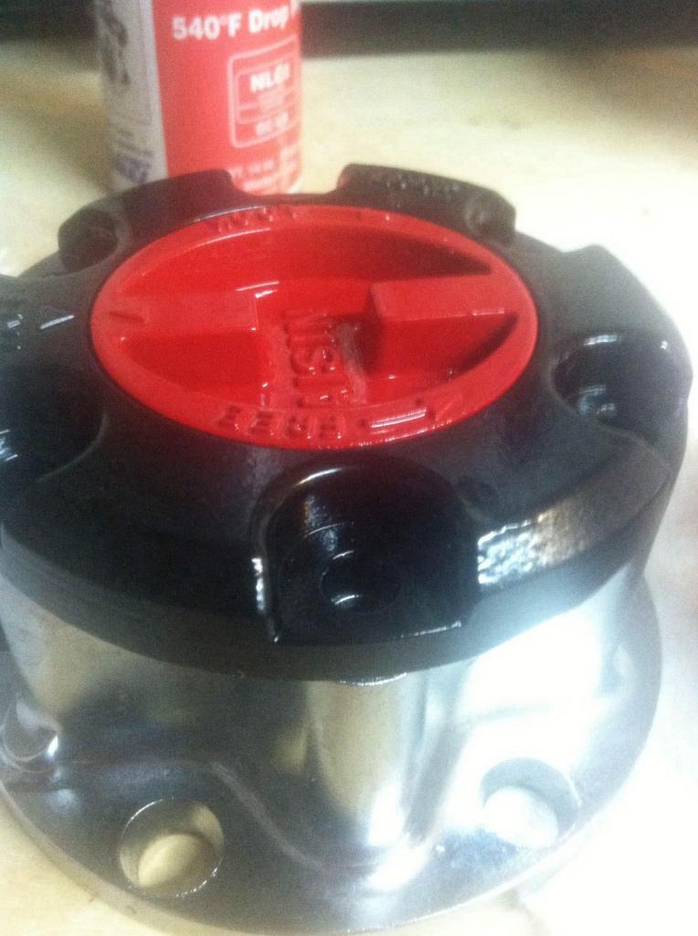

Drive without locking hubs on?
I just finished cleaning and painting my aisin locking hubs:
I got brand new gaskets but need to take it to the shop to change out the rotors (I don't have the 54mm socket to do the job and my mechanic is going to swap them for me cheap). Can I leave the hub off while I go down the road? I just don't want to put on the new gaskets and then take them off at the shop again.
Can I drive like this?

Just put them on w/o the gasket or maybe a thin film of RTV or take one of the gaskets and trace it on paper and cut out a temporary one to use. Hub will keep dirt out of the bearings and keep the grease from getting flung out.
