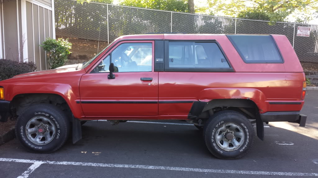

Here are my after pictures of my Zuk mod
You can actually see the overload leaf
As you can see no more saggy rear!
Here you can see the springs have settled a tad

At the time of the ZUK I was running 225/75R15's and in the snow pic Im running the 31's
And Johnny Im liking your truck specially the head lights, did you put the Led rears back in or you still running stock rears?
