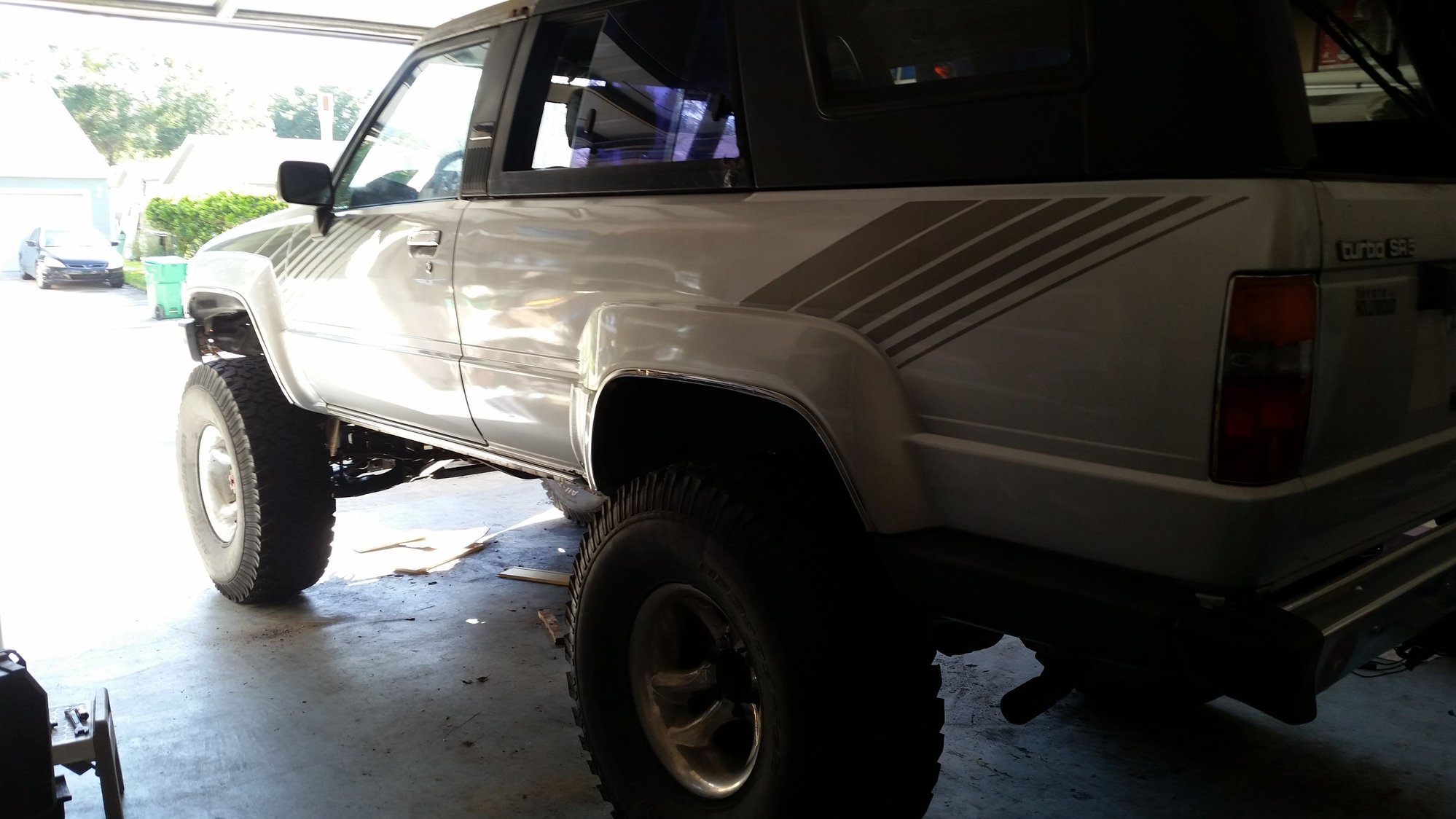

0 Posts
pic
I admit, My garage is so small I can't even get a picture of the whole truck with the lift and 35's installed. The battery is on the charge so later this afternoon hopefully I can pull her out into the yard and snap some photos after a test ride.
Here is what I was able to get picture-wise .. with the sun to my back, it makes the garage terribly dark if I take pics from outside during this time of day.. so I had to snap from inside - note after the bfg 35's 4" front and 5" back I have about 1 inch clearance to roll out of the garage now.. I thought i'd have to let air out of the tires but I managed to just barely get it .. lol
