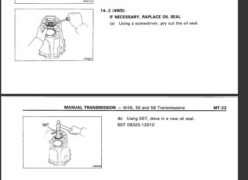

I wish I had thought of this before putting it back together. Now I'm thinking it's better to drop it again and double check...
Looking through the FSM, it's probably this seal that needs replacing...

fluid in there is NORMAL. The front of the transfer case is just two open faced bearings, the fluid is free to flow through the bearings but not into the tranny, that is the seal your looking at. they have to separate from each other to maintain the proper fluid levels, but the gear oil inside the transmission tailshaft housing is from the transfer case. There is the paper gasket that seals between the two, I would recommend using Toyota FIPG instead, but the oil will always be there. Look at the front of the t-case and you will see it seals to the back of the tranny. you just have to make sure the transmission output seal shown in the pictures is still good, otherwise on a steep hillclimb your transmission would drain into your t-case. Don't sweat the oil being there.

No bad seals, they are open faced bearings. Open faced bearings cannot retain oil within the case, allowing the oil to flow forward allows for a larger oil bath for the t-case, but the seals are good. Appreciate the concern, but seriously... I am not a total moron. Every t-case I have seen allows for the oil between the two. The transmission output seal is good or the tranny would be low on oil, and the t-case would be overflowing. IF they were sealed bearings, then yes, oil between the two would be a sure sign of a seal failure.
