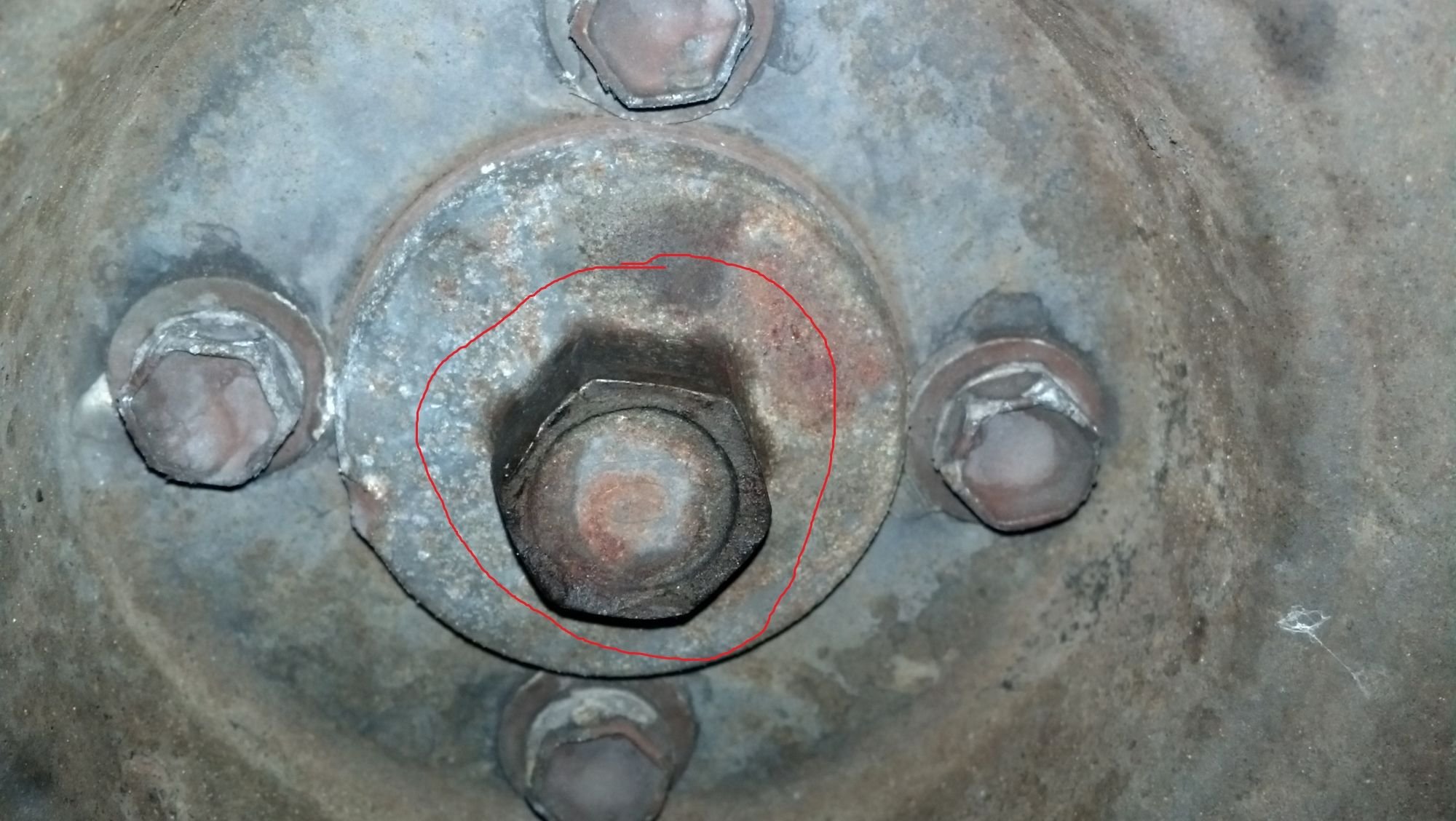

I just cant get it. Steps so far.
All involved 1/2 In. Drive 25 In. Breaker Bar and lots of PB Blaster.
1. bump stater full battery to dead battery.
2. Cargo strap (Broke) Got one with 3ooo lb breaking strength. To bind the pulley, Its holding but I still cant get it. I also banged on the breaker bar while pulling.
Still no go.
I'm going to get pipe later to add to the breaker bar and see if that works.
Or should i just buy this 1/2 in. Heavy Duty Electric Impact Wrench from Harbor Freight ? Im afraid to use a torch to heat it, 1. I don't really know how to do it. 2. Every thing is covered in oil.
My fear is snapping the bolt. F.I.Y. I'm using a 6 point Impact socket form Harbor Freight to. I heard they are less likely to round the bolt. Also I have the head off now if that maters.
One other note: I had the front seal done a few years ago . I suspect they put the pulley on and used an impact wrench to just tighten the pulley and force the pulley on so i'm sure it's beyond spec.
And the dam flu shot in to by biceps is not making this any more fun, Im sore and tired been at this fro 3 days.
Here look upon the face of frustration.
