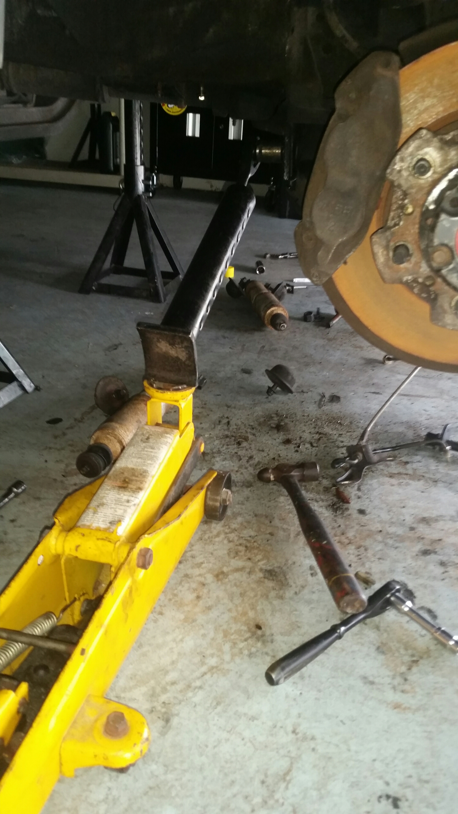

Crankshaft Pulley Bolt Removal Problem
This will work. Attach your breaker bar to the nut.. let it hang at a downward angle .. Put a floor jack under the breaker bar and jack the bar up until it comes loose.. I did this on my front end bolts, works great.. Not on the crankshaft pulley but the bolts were stuck eccentric bolts torqued to hell..
Hope it works good luck

^^^Some reason I never thought of that. I too had a bolt that I used a 5 foot cheater bar on and could not break it loose.
Obmi.. I feel for you, that bolt is being stubborn. Wishing the best for you.
