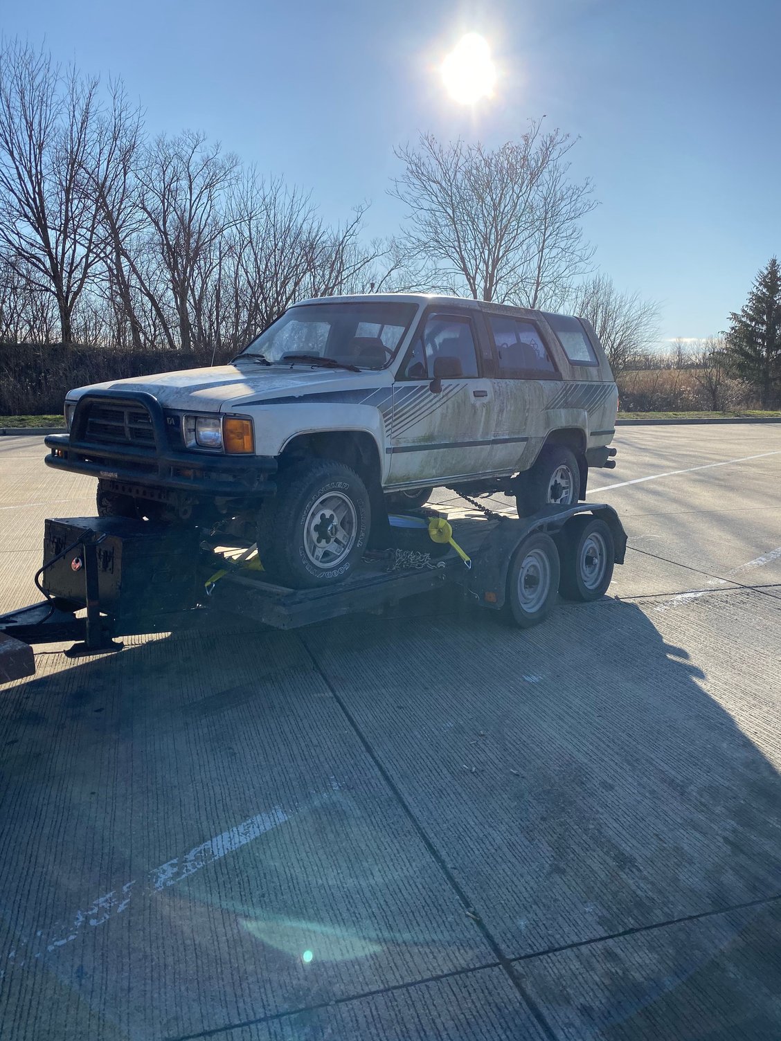

I have a 87 4Runner that’s been sitting for several years. A fresh battery, draining fuel tank, blowing out the fuel lines, fuel pump, fuel filter, spark plugs and wire I can get it to start and running for a second and then it dies. I was thinking it might be a timing problem but wanted to ask someone else’s opinion.
