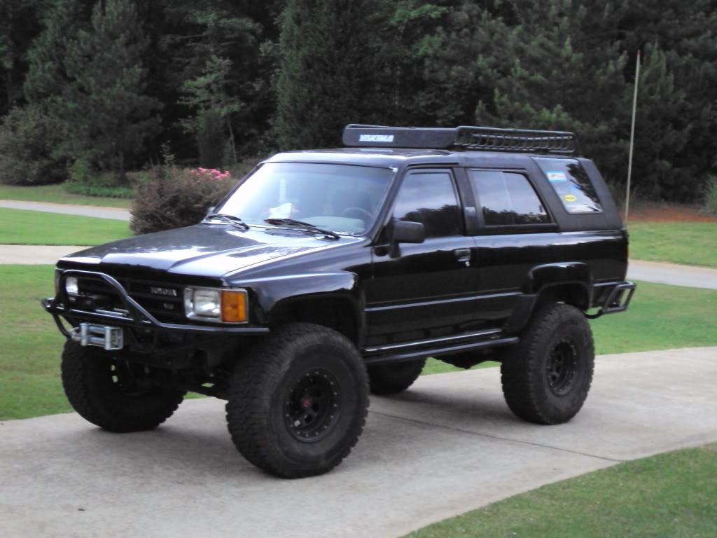

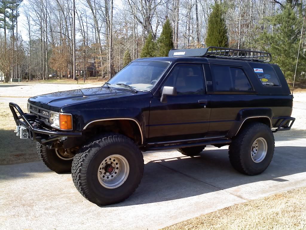

I would definitely stick with an 8" wheel personally. I like the look much better and it will also be easier to run the tires with no lift.
These pics are o 35x12.50s, but the same thought applies.
15x10s

15x8s
