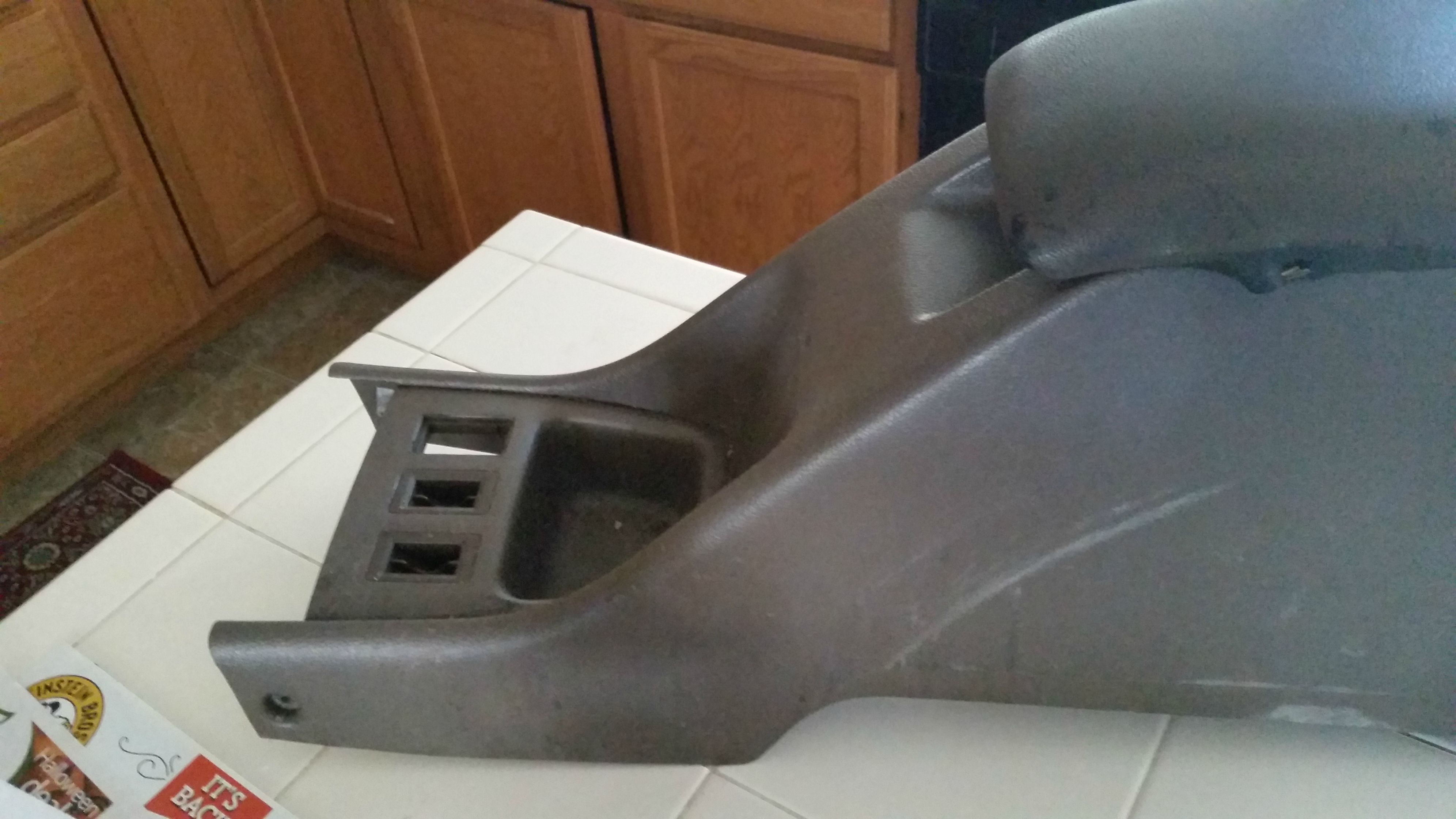

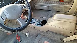

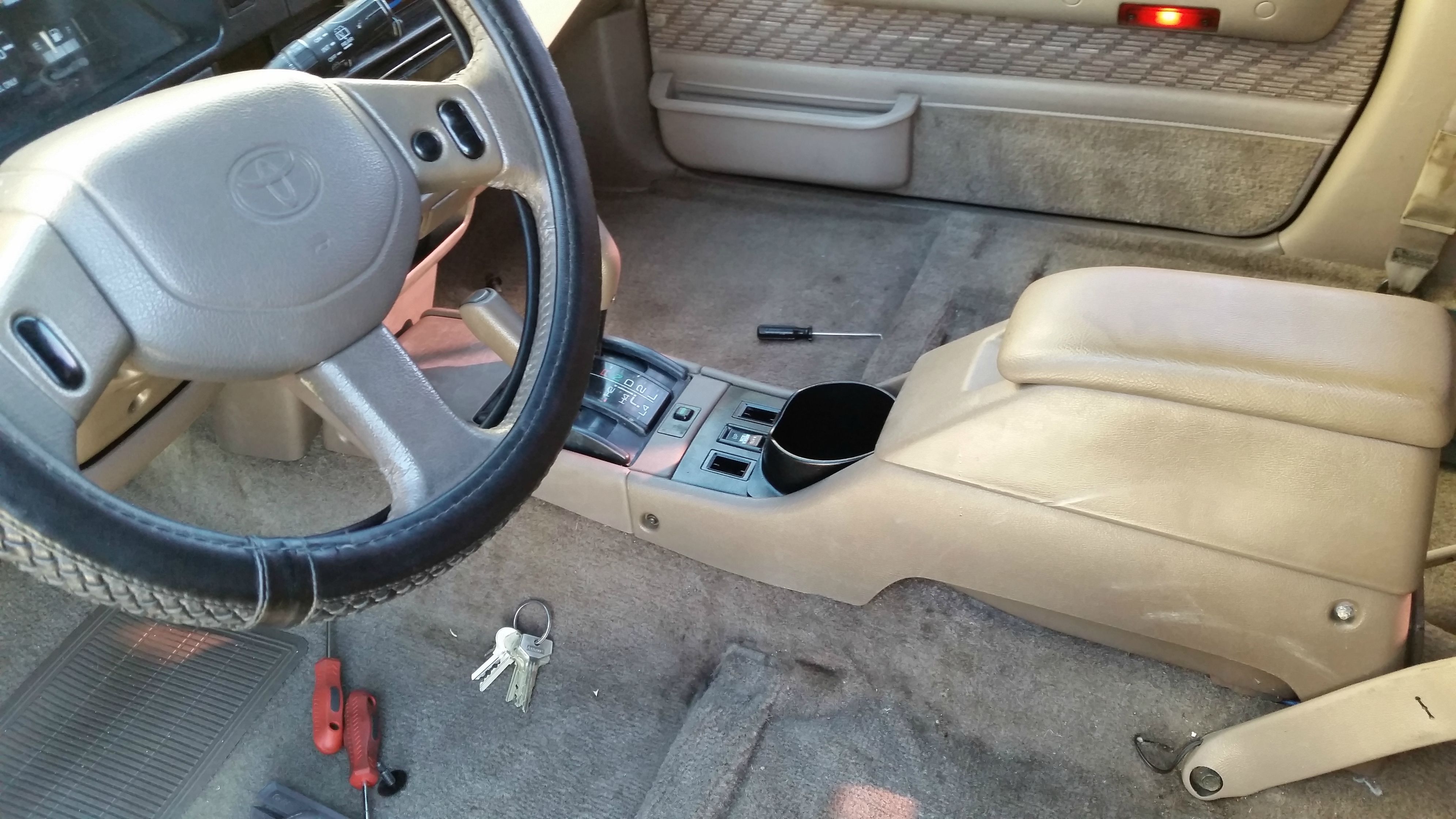

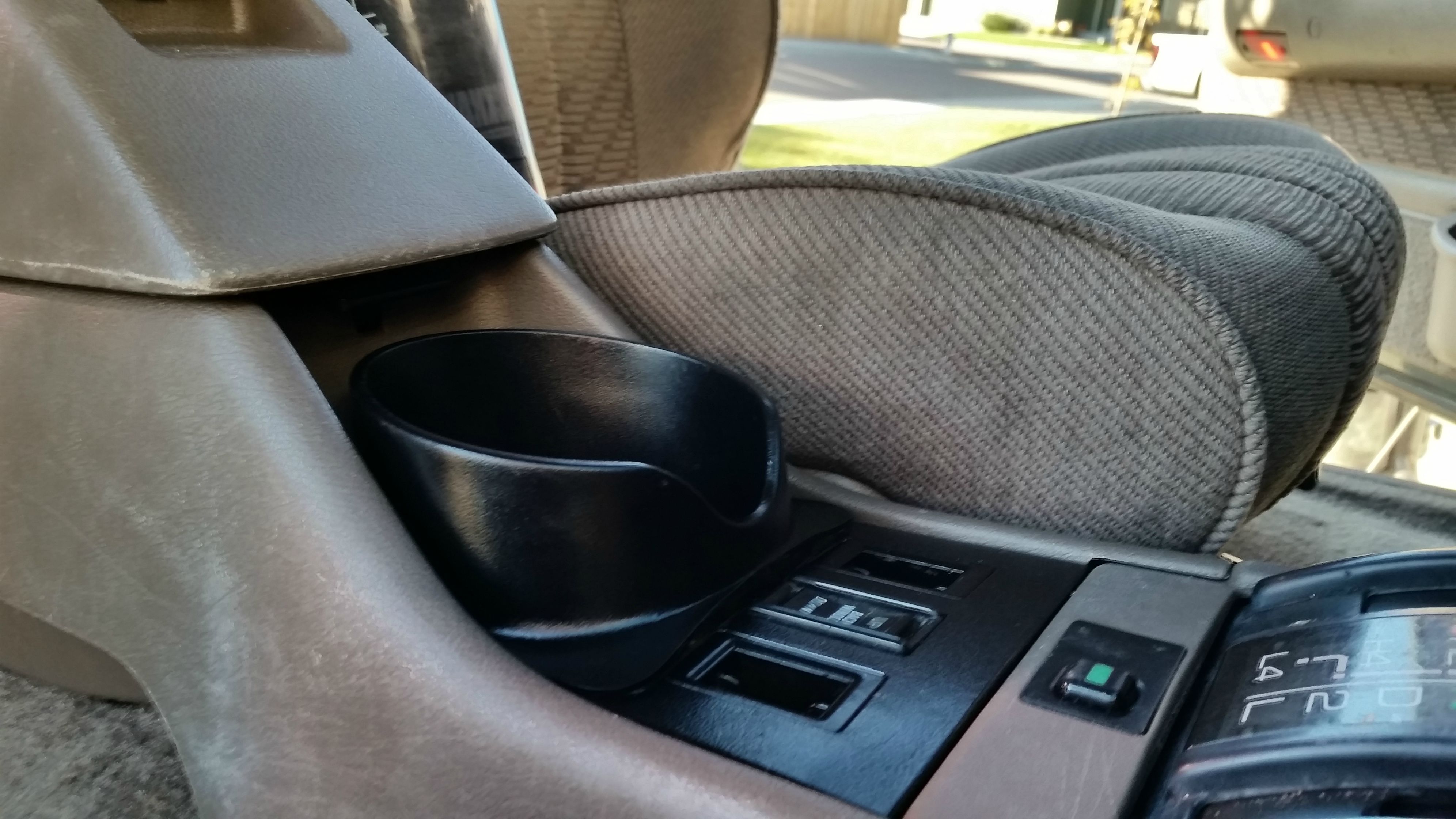

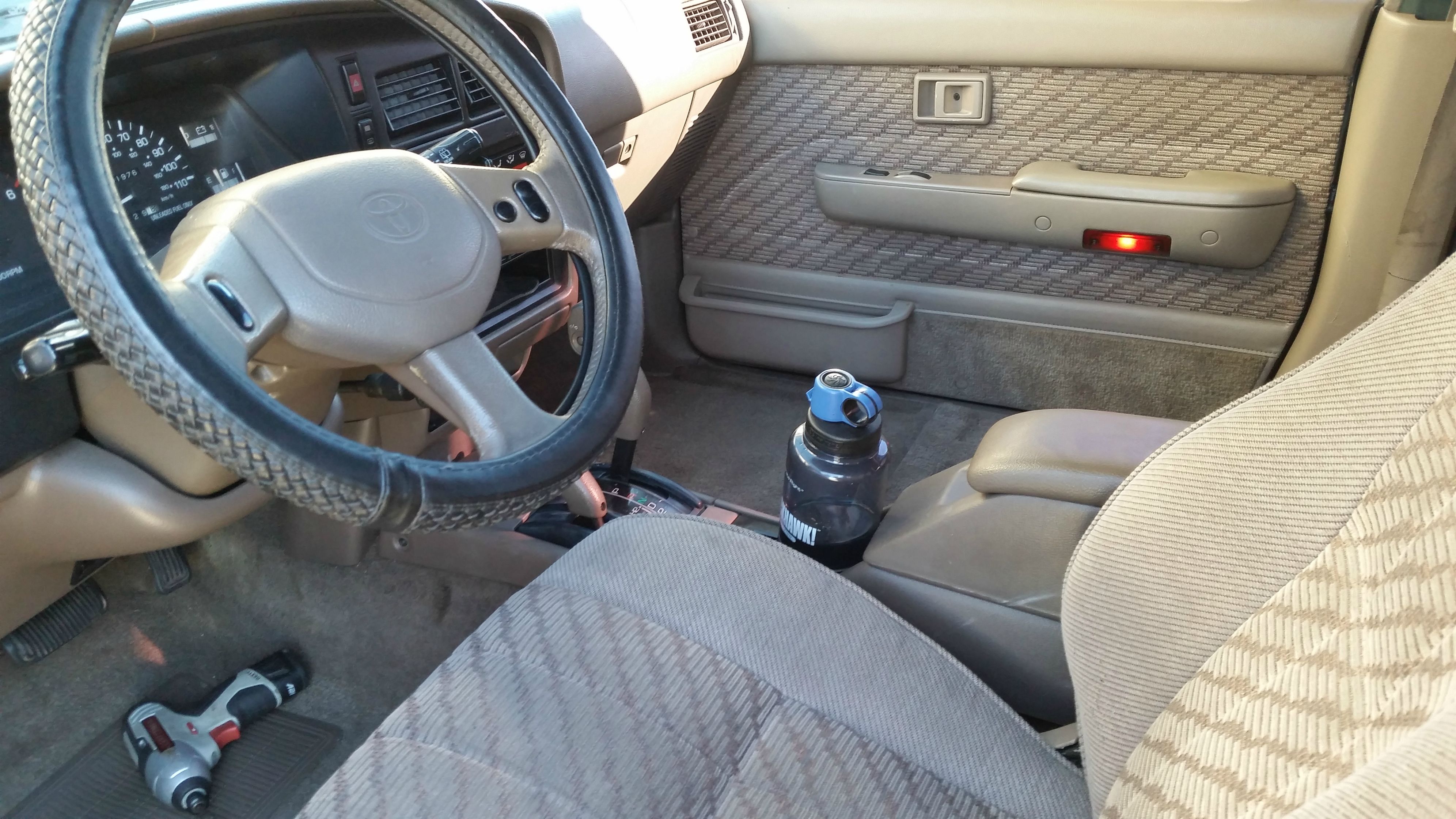

It is the heater delete center console (wanted more storage and no leaks), and its actually a cup holder from a Dodge Durango grafted in to the change tray on the Toyota center console. Im super happy having a decent sized cup holder now.

Took my time with the Dremel till i had the bottom of the change tray removed and parts of the sides that pinched the cup holder. took a razor blade to trim down the cup holder sides and bottom of the lip on it. Filled in the gaps with epoxy, sanded smooth for a clean look then dyed black for a uniform finish.
only really took me about 3 hours to complete it, took about two weeks to get all the parts off ebay.
