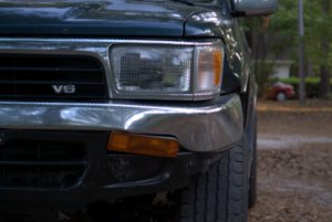

Here's the deal: I just piced up a '94 4Runner, and am planning on driving it as long as it's drivable.
Right now I'd like to start by straightening out the front and rear bumpers. The rear was rearended, and the front was hit by a car that'd been t-boned in an intersection already. There was some suspension damage from the front hit as well, but that's been corrected.
Other than appearance, the harm here is that the driver's side front tire rubs when turning right, and the rear bumper is such that I can't get to the spare tire (which is still original, so this might not matter a whole lot).
Anyway, can you tell from the pictures if this will be as simple as ordering new bumpers and/or mounts and reattaching them (don't care about minor body damage)? My fear is that there's more to this then there appears...
Here's the front:
Attached Thumbnails Requesting advice on replacing front and rear bumpers-dscf1709.jpg   Requesting advice on replacing front and rear bumpers-dscf1710.jpg   Requesting advice on replacing front and rear bumpers-dscf1711.jpg

You wont know how bad the damage is until you take the bumpers off and resinpect.
Oddly enough the rear bumper bolts to the body not the frame....
Check E-bay, you will find cheap nonOEM replacments that will do the job.

whats the tire rubbing on? the plastic lower part? if so take it off for the time being. it looks meaner with out it. i would replace the bumpers with aftermarket bumpers.

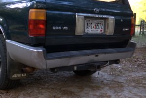

And the rear...
Attached Thumbnails Requesting advice on replacing front and rear bumpers-dscf1712.jpg   Requesting advice on replacing front and rear bumpers-dscf1713.jpg

Yeah, ir's rubbing on the black lower part. My father-in-law suggested that sometimes when you take off the bumper you find it won't go back on. Is there a large risk of this, or is it a fairly straightforward job?

the bumpers *should* go on as easy as it comes off.. its only a couple bolts holding the bumpers on. the rubbing wont cause any damage, but like i said if its bothering you, you can take the lower part off. the turn lights are on the metal bumper not the plastic part. i'll try to get a pic of what it looks like with out one.

The rear is a 3 piece bumper. You probaly only need to replace the middle section. You also might need to replace the brackets, they tend to bend. You'll know once you get them off.

The trailer hitch probally saved the body from extensive damage....

To me, the front bumper looks like it will be easy to replace. The rear? I would leave the dent like the rest of us and just raise it to where it needs to be. Check out this thread.

Dents I could care less about. A cant to the bumper that keeps me from getting to the spare tire is something I should fix, though.
I'll take it off and see if simply replacing the brackets will be enough.

I took off my plastic valance and highly recommend using ratcheting wrenches otherwise it WILL be a major pain in the ass.
The front bumper has 3 bolts on each side:
