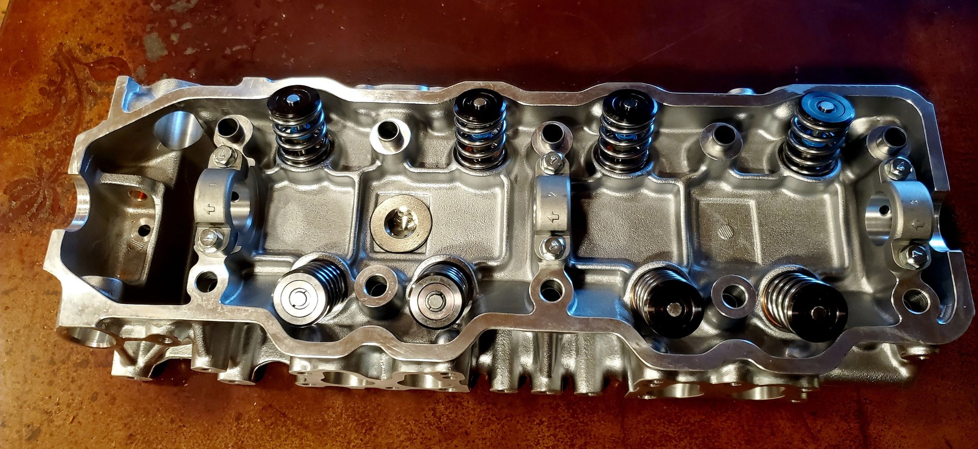

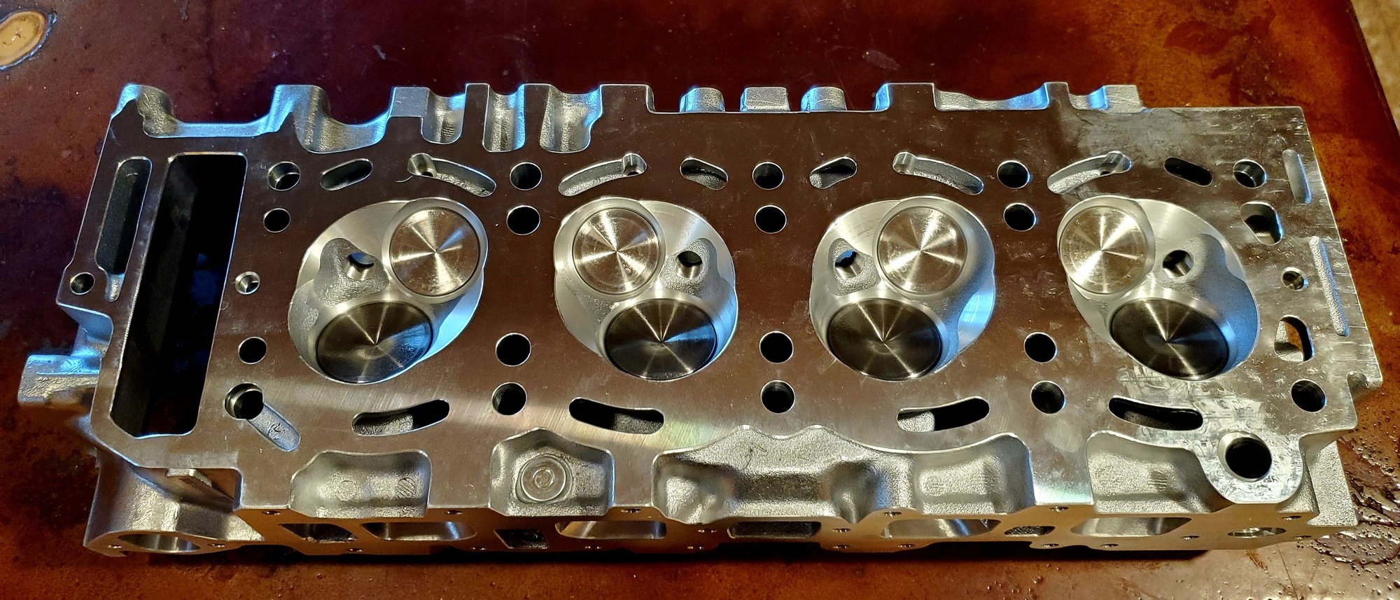

Still gathering parts...
a little eye candy. Already bored .010 and decked the block. New cam and rockers. New pistons and rings, ARP studs, New oil pump, new water pump, new Garrett dual ball bearing turbo, new hoses, vacuum lines, reconditioned injectors.
82 supra AFM, plugs and wires
Going back in my 87 factory Turbo 4runner...
Can't wait to get him back on the road!!
