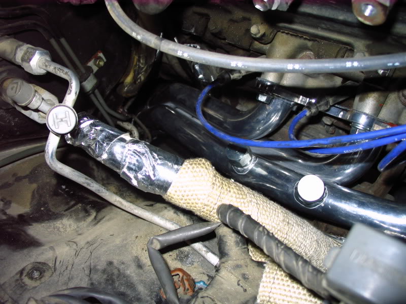

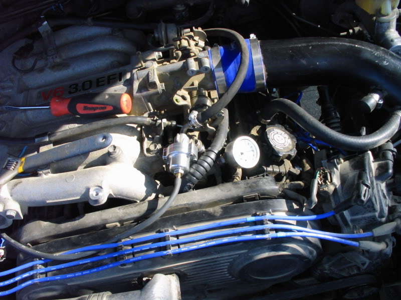

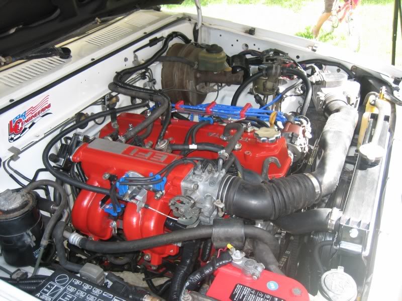

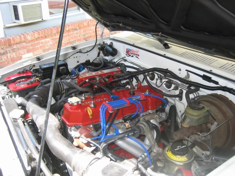

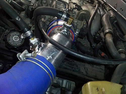

well here is some of mine
my truck is some what modded

Nashman, do you have a list of the parts you used? Yours looks very clean.

45 degree exhaust pipe Meg afm and supra intake box
you can't really just stuff a 7mge afm on witch out supporting mods
you can on the cheep with fuel reg and a slight changing to the afm tensioner spring

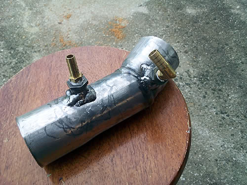

Sorry, I just meant for the ISR change. This would be to keep the stock AFM and intake box. So you had a section of exhaust pipe bent for you?

yea just a 45 degree per Manuel bent pipe with 2 tubs welded on for reed valve PVC
find them at any local nappa or lordco or auto zone

Where the hell is the mess of vacuum lines???
Old Jun 29, 2009 | 01:20 PM
  #107
Tubbyfatty's Avatar
Joined: Nov 2008
Posts: 1,903
From: Hillsboro, OR
On post #101?
Yea i noticed that too....hmm...
Old Jun 29, 2009 | 01:22 PM
  #108
Jay351's Avatar
Joined: Feb 2007
Posts: 9,055
Likes: 10
Originally Posted by Tubbyfatty
On post #101?
Yeah, looks like extensive emissions control removal has been done. I dont see any vsv's though....
Old Jun 30, 2009 | 01:28 PM
  #109
Nashman00's Avatar
Joined: Mar 2009
Posts: 136
nope there all gone

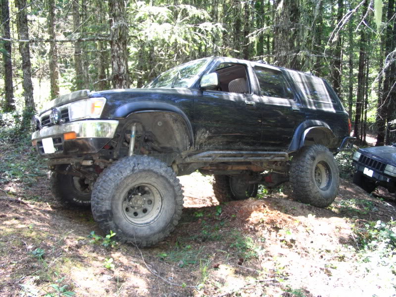

Is that a 2wd?

nope sas 94 runner

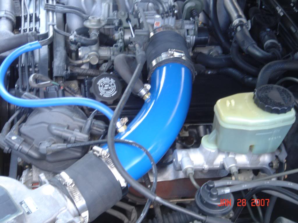

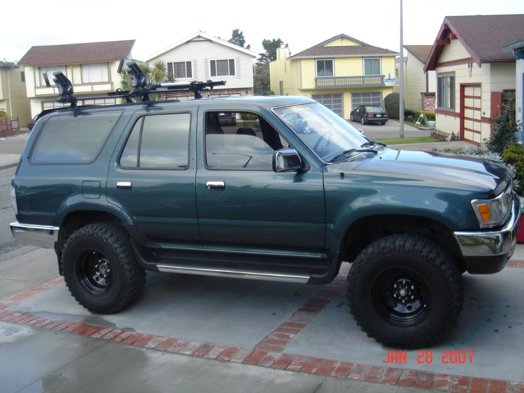

93 isr mod

Jan 28th 2007???
Gotta tease ya a bit.
Where did ya get the thick blue hose?

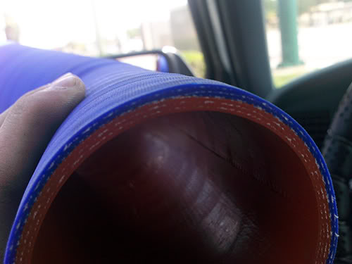

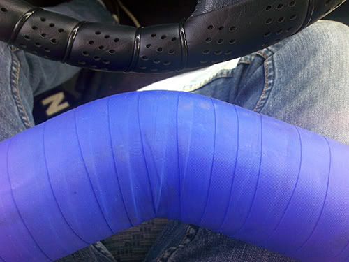

So while at Amazon Hose and Rubber buying hose for my ISR mod I found this.
Cant be good for my MPG
Hose $50 but worth it. Its pre-insullated.

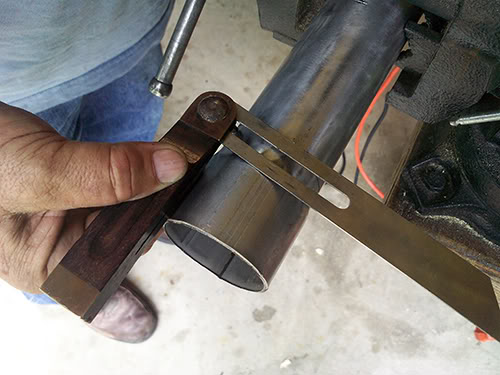

Cutting pipe

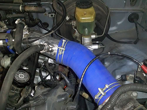

Cost $50 (Hose) $12 (Fittings and hose clamps)
Im going to get header wrap it next weekend for the pipe.

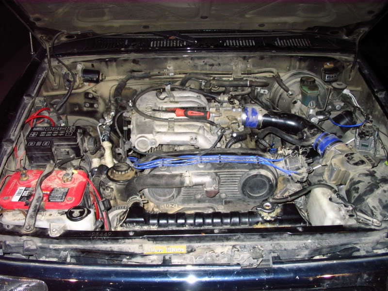

Heres mine, came with autozone parts for the intake when I got it,(dont get me wrong,Im a manager at AZ) no room for stock air box, And since the old intake was plastic and I accidently ran over it with my car while I was redoing the motor, I had to start fresh haha. I made this out of an old intake I had from a Nissan Hardbody and a couple couplers. AFM is repainted now and filter sets lower in corner... Also relocated the battery to the bed with a nice optima yellow top,and a 170 amp alternator to keep it up

your front suspention worries me shortyz, lol, but I guess that's why I don't cruise the lowrider Isuzu I use to have
that's a clean engine bay you have there
