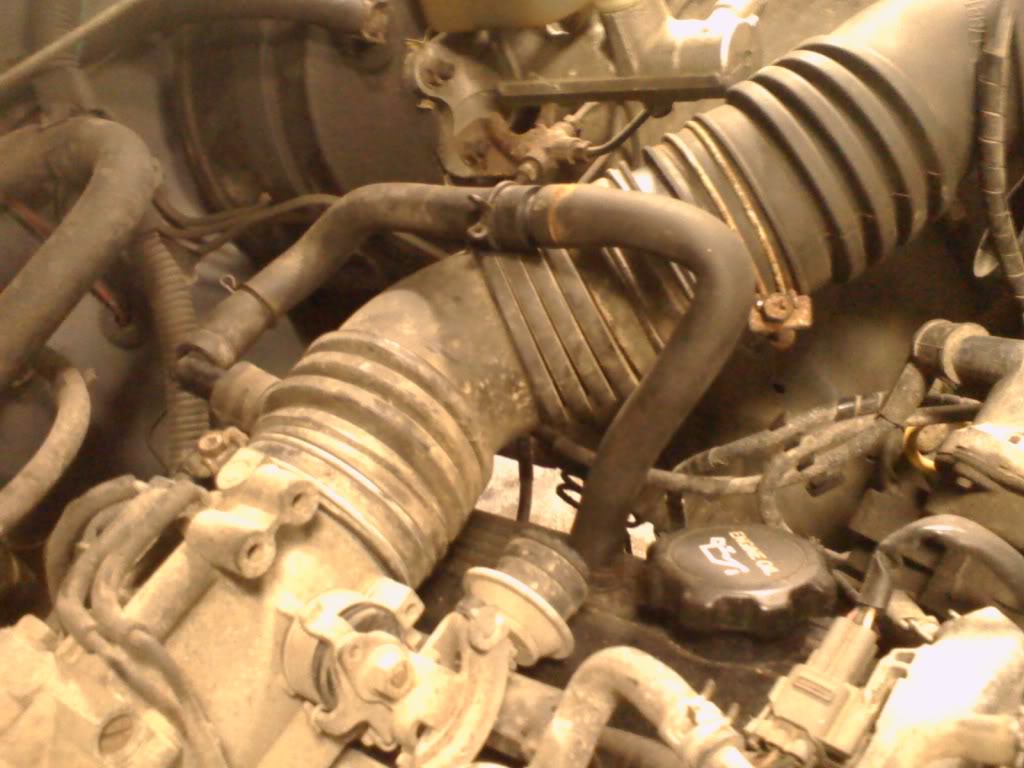

Corragated tube. Great for smooth airflow.
x2, ditch that slinky and get smooth tube or do a Battery/Intake swap

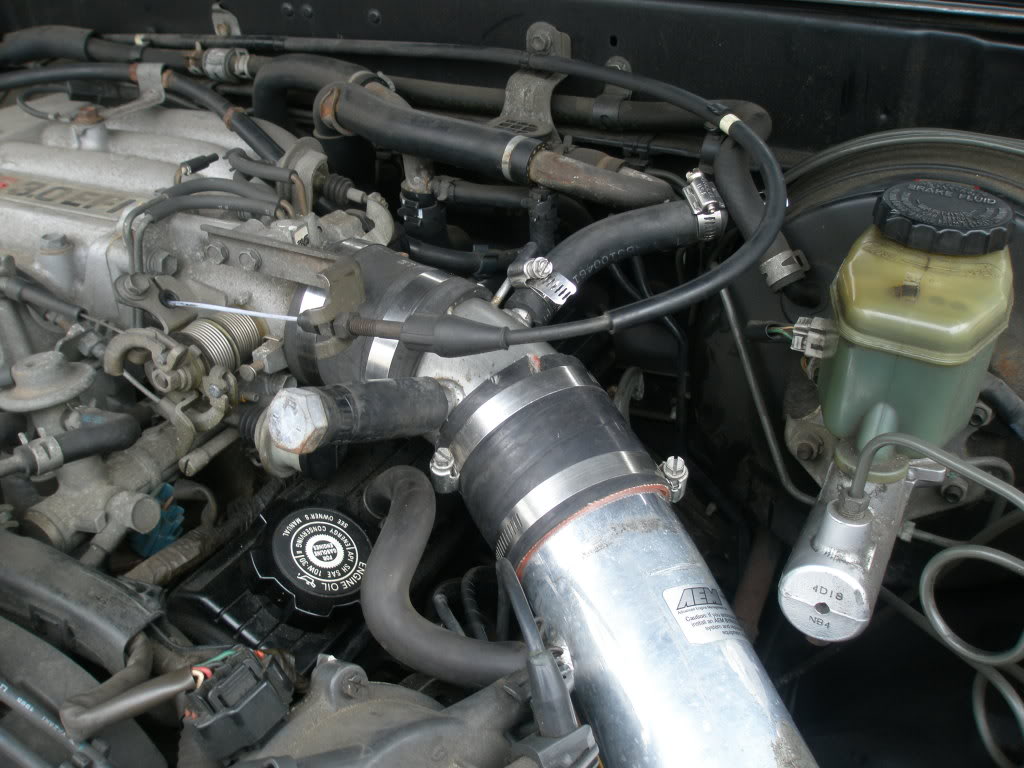

Been a subscriber to this thread for awhile now. Finally did this yesterday. Total cost $0. Everything was used from extra parts my friends had. I used an old Civic AEM pipe cut the bend off of it, used a pipe that was made for a B13 Sentra SE-R on the throttle body. I had to block off all the vacuum openings on that piece. PCV went into the bung already on the AEM pipe. Had to redrill the Maf adaptor. Took me 2 hours and some change to do cause I had to cut and mess around with a few things.

Overall, I love the difference it makes. No more revving the life out of this motor to pass anyone.
One other thing I know it was mentioned in the thread but the two metal lines running in front of the engine that get connected to the Air box via rubber hoses. What do they both do? With them uncapped, they make a lot of noise since they suck air. Can I cap them both off without a problem?

they are vacuum lines i'm pretty sure you dont want to just leave them open i just ran mine into the air intake tube with some 90 degree fittings. but in your cas just get some hose long enough to reach the ports you plugged up near the throttle body. looks good though!
