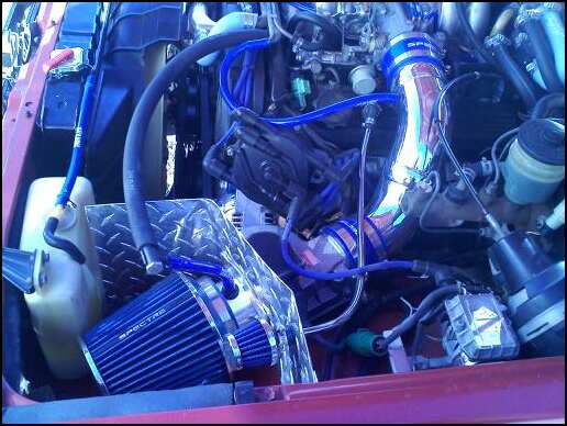

Jacobeo5's Avatar
Joined: Nov 2009
Posts: 46
From: Albuquerque, NM
uploaded my pics.
Attached Thumbnails Post your ISR Mod Pics!-1988-3vze.jpg   Post your ISR Mod Pics!-isr-mod.jpg

awareness's Avatar
Joined: Dec 2007
Posts: 261
From: Pitt Meadows, BC
Jacobeo5, that looks awesome. Did that entire setup come as a kit from Spectre?
Old Feb 1, 2010 | 09:48 AM
  #157
Jacobeo5's Avatar
Joined: Nov 2009
Posts: 46
unfortunately not. Just had some spare diamond plate in the garage from another build so i built the sheild to hold the filter, maf adapter and maf, then just bought some elbow and after about 3 hours of drimel work had everything installed. Filter adapter and elbows are all spectre. Though i am bummed to hear that the plastic stuff cracks. I will just keep the duct tape and bailing wire in the truck so if and when it does go i will upgrade to some stainless steel

  #158
mmcpeck's Avatar
Joined: May 2008
Posts: 593
From: Long Island, NY
Jacobeo what plastic parts are you talking about? Everything looks metal to me from the pics.
Old Feb 1, 2010 | 05:53 PM
  #159
Tracey98277's Avatar
Posts: 332
From: Virginia Beach, VA
its 'chrome' plastic stuff.
