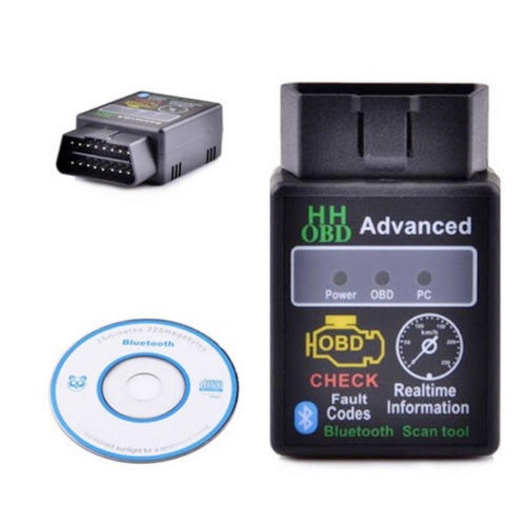

Ok. Quick question
I have a bluetooth obd2 scanner
which works fine with newer cars using my android phone via bluetooth
my question is. If I buy this adapter
to connect it to my 87 22re pickup diagnostic plug, will it read anything?
thanks in advance

Almost certainly not. The protocols aren't even vaguely related.
So what is the adapter for? Beats me, and I own one.

Will not work, The OBD1 diag port on the Toyotas is a sensor and switch junction, Not a data port as OBD2 is.

No, the OBD1 port on our trucks IS a data port, it just requires some fancy footwork to read it. Fortunately, one of our members (RJR) has already done that: https://www.yotatech.com/forums/f116...reader-278801/
