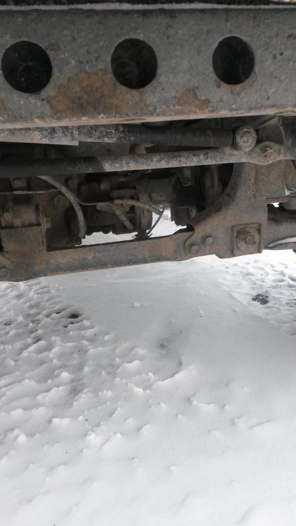

is this the actuator? just looks like wires going to it not vac hoses, but i could be wrong

Yup. Here's a picture: http://personal.utulsa.edu/~nathan-b...26addcontr.pdf
We don't have much to go on, but it sounds like the ADD is not engaging.
