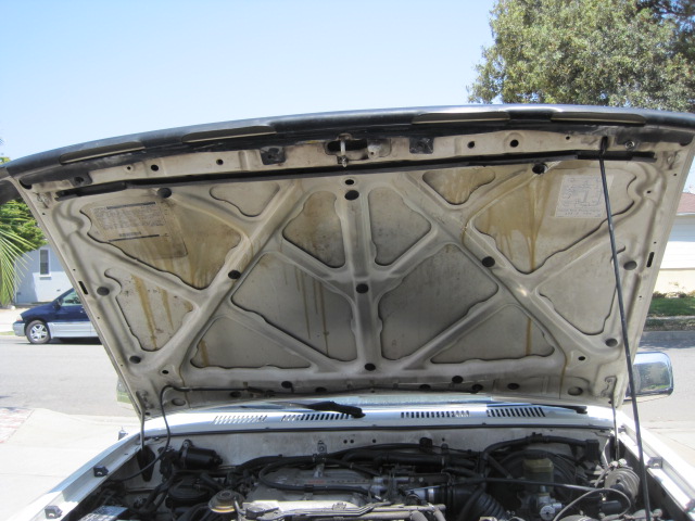

I've got a 1993 4runner, manual t., 223k on the clock. About a month ago I replaced the valve cover gasket because it was leaking. A week ago I noticed it was consuming oil but noticed no external leak. I am using regular dino oil in this thing.
Today I go to start it, nothing unusual, until I hear a sound that I would describe as someone slurping a soda when its empty, or to be more precise the sound a power steering fluid pump makes when the power steering fluid is low (I know this from changing fluid in another car and certainly is not the problem here). So this was a slightly slurping and slightly metallic/clanging noise. I get out to investigate and I notice that engine oil is gushing from beneath the car, like someone just opened a spigot and dumped it out.

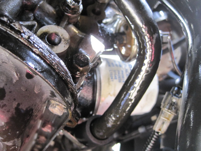

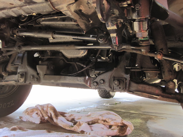

I took off the skid plate and it seems like the leak is from the driver's side, front of the engine, in the region of the oil filter. I'm not totally well versed in 4runner's yet but I think I see an oil pressure sender there too. Lots and lots of oil in that area but it doesn't appear to be coming from the sender; its possibly coming from the oil filter but I question that theory because soooo much came out at once, like a hose had burst off or a chunk of the oil pan exploded , Apollo 13 style
So please see the attached photos, oh learned elders of Yotatech, and advise me on further courses of action. I would be happy to take more photos or even video if an astute helper needed more visual information.
.So please see the attached photos, oh learned elders of Yotatech, and advise me on further courses of action. I would be happy to take more photos or even video if an astute helper needed more visual information.

- Difficult to pinpoint leak source because it is believed the leak sprayed into the fan and distributed oil all over, including on the hood.
- Oil concentrated on driver's side, front of engine, near oil filter.

Have you checked the oil return line that goes from the oil cooler to the block? It is behind the oil filter and I think would spray a lot of oil forward if it blew.
Edit: Actually, maybe both of the lines running to the cooler are coolant lines, so nevermind. You could check the cooler to see if it sprung a leak. You could also check that the pressure transducer right in front of the oil filter is leaking.

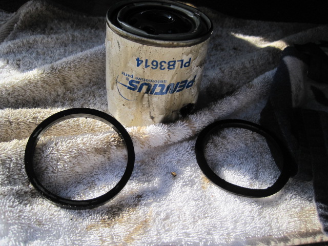

Probably a long shot, but you should make sure that the previous oil filter did not leave its O ring behind when it was removed. If it did, you have two O rings where there should only be one. It may hold for a while, but....
Please see the attached photos. One of the o-rings appears to be that which came with the old filter while another has a taper and is most likely suspect/from an old filter. The oil pump had no spray emanating from it and it did indeed appear that oil had come mysteriously from the filter only.
So, I will tentatively conclude that having 2 o-rings was the problem.

A good mechanic should have spotted the old o-ring attached to the block, as he should have wiped the area clean and then using a touch of oil on the new o-ring on the filter. Good job fingering out the problem.
