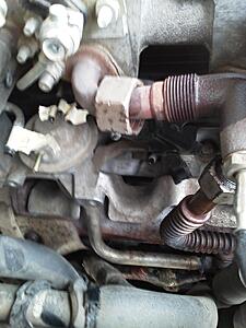

When I removed the manifold from the driver's side, there was a weird sheild-ish gasket like thing installed between the head and the manifold. I haven't seen it in pictures from other installs and am wondering if I can ditch it. The headers are gasketless anyway, so unless it has a very important purpose as a shield, I don't like it and want to reassign it to the trash. Here's a picture of the one installed on the passenger side (you can see it right below the plug and above the manifold):

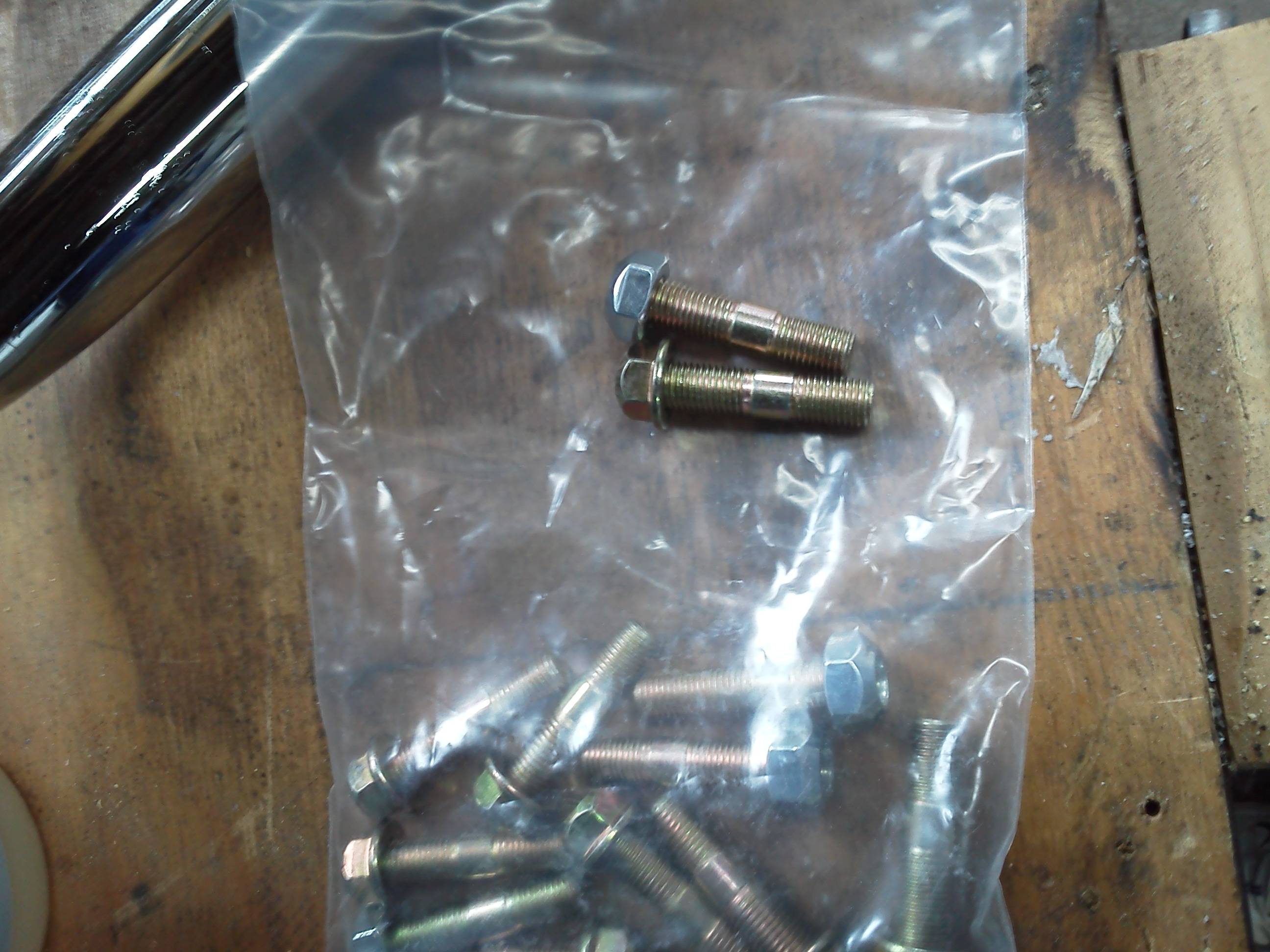

Ok, question #1. I bought new studs when I ordered the headers. They also came from nwo. The studs have two different nuts. Four of them are silver and look like a mushroom cap and eight of them are brass and look like a head bolt (forgive the descriptions, I think you get the idea). Which go where? Both nut styles fit the studs. Here's what they look like:
