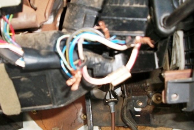

The Stereo
Picked up on the cheap a Pyle SD/USB in dash head unit along with some even cheaper new 4" and 5 1/4" speakers by Pyle from Amazon.. total price 68.00 for the entire system.. Ripped out the 20 year old stuff and replaced with new.. Only one of the old speakers actually worked, after I pulled the old cassette deck out and saw the previous owners wiring job, I now know why..

Yep that some ugly stereo wiring
My very first post right after I got this truck(it's still in the newbie welcome section)as I was pulling it apart I mentioned and posted a pic similar to this one.."Don't hook your stereo up to your ignition mains" all kinds of goober stuff found in these thar Yotas. I have a straight 12 volt 60 watt Pyle stereo Amp I'm going to just hook 1/8 phono plugs so I can hook up whatever comes down the pike technologywise in the future, always going to have 1/8 plugs and jacks

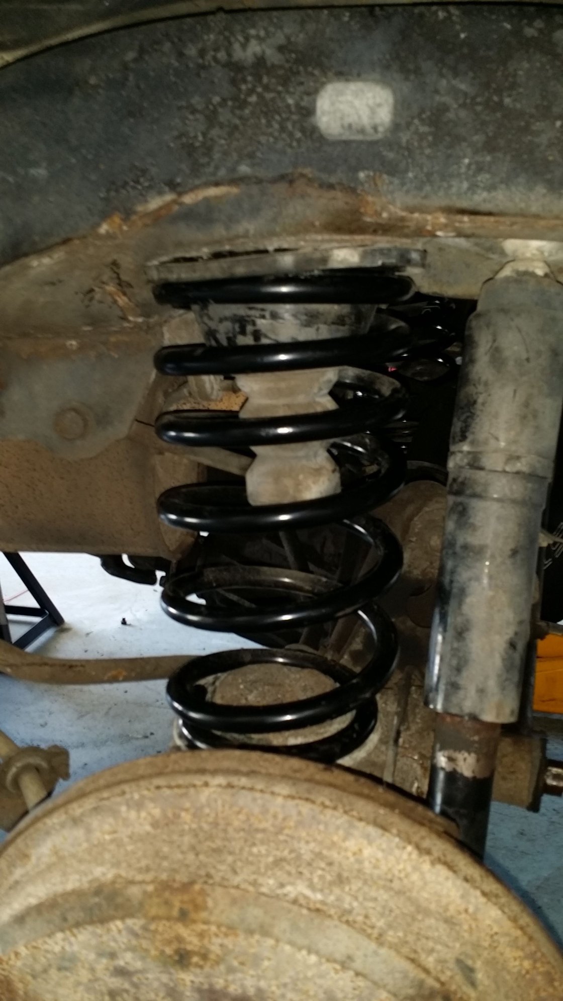

Moog Springs!
My Springs arrived, I'm broke so I'm trying to piece things together part by part for right now, the springs should help fix the a$$-sag she's got going on in the rear end..
Install pics

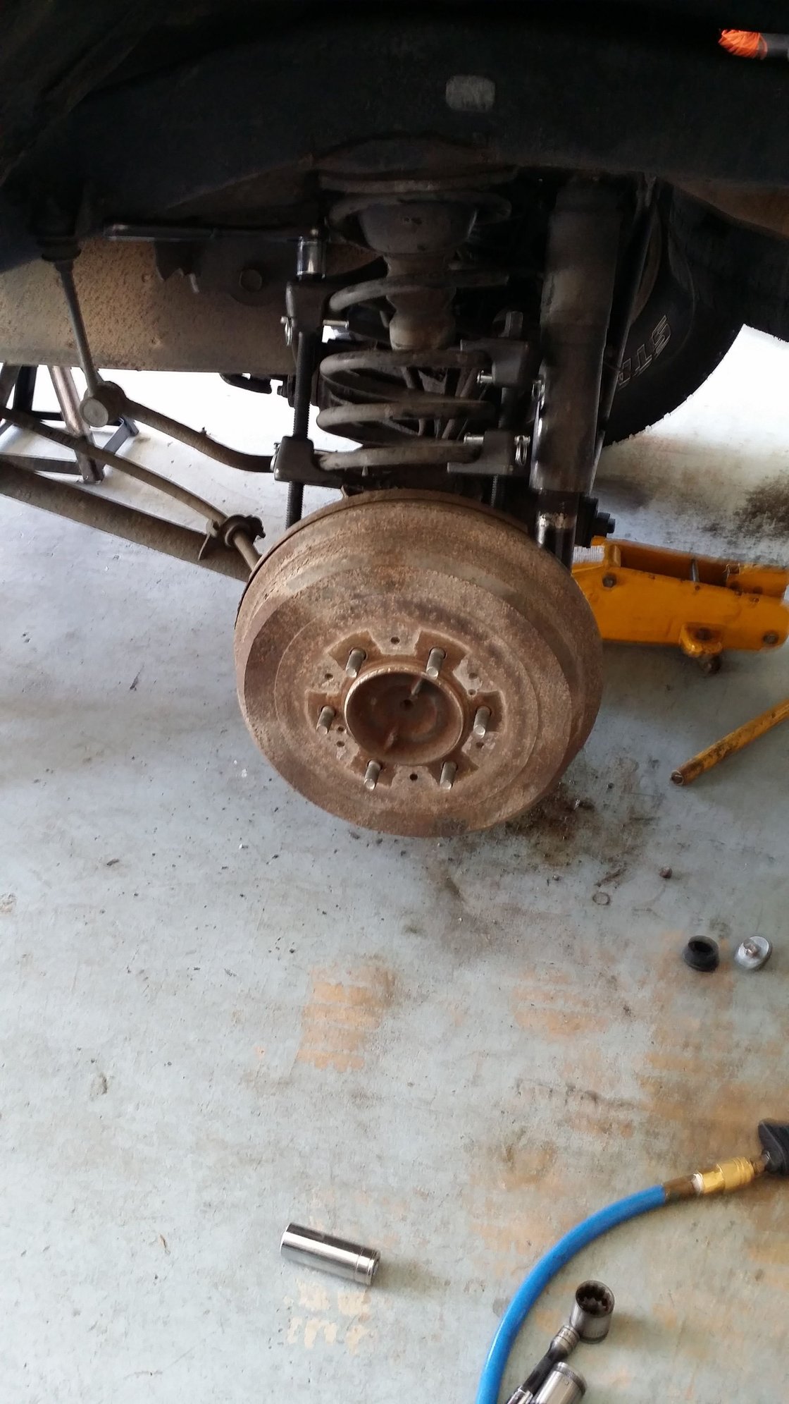

SO when I removed the old springs and took the shocks off, I tried to pull the old rear sway bar off to make things easier, I broke a single bolt on each side that holds the sway bar to the rear end.. I was considering just yanking the rear the same as I did the front, however I DD this thing and tote a couple kids around in it. I want it to be safe for now and not worry about roll-overs.. Is it THAT much more of a risk for just normal driving to not have them on? I'm in Florida not driving around mountain roads and hair-pin curves..
I hope to find some time to drill out the broken bolts and replace them this summer with new bushings, brackets, rods, etc..

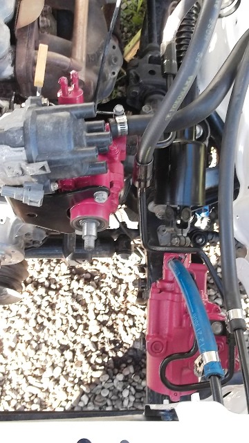

Found it
I think I found the vacuum leak that is causing my erratic idle and power steering fluid magically disappearing in one discovery.
I behold, the broken power steering air vacuum control valve ( I think )
Would this be causing idle issues AND a power steering fluid leak? looks awful wet down there..
I found a replacement online on RockAuto, 60 bucks is a bit expensive for such a small part.. Guess I'm going to compile a new junkyard parts list.

The vacuum thingy on the side of the pump sounds perfectly feasable
A diaphragm rupture would cause both a vacuum leak and fluid being sucked into the area or into the TB, not sure what the part does, what happens if you switch the hose connections etc.? Fortunately the hoses are clearly different lengths and the pipes are different..what would happen if you just put a plug in it? Is it an emissions issue?
